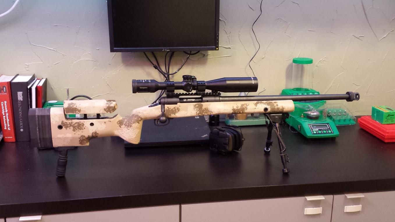

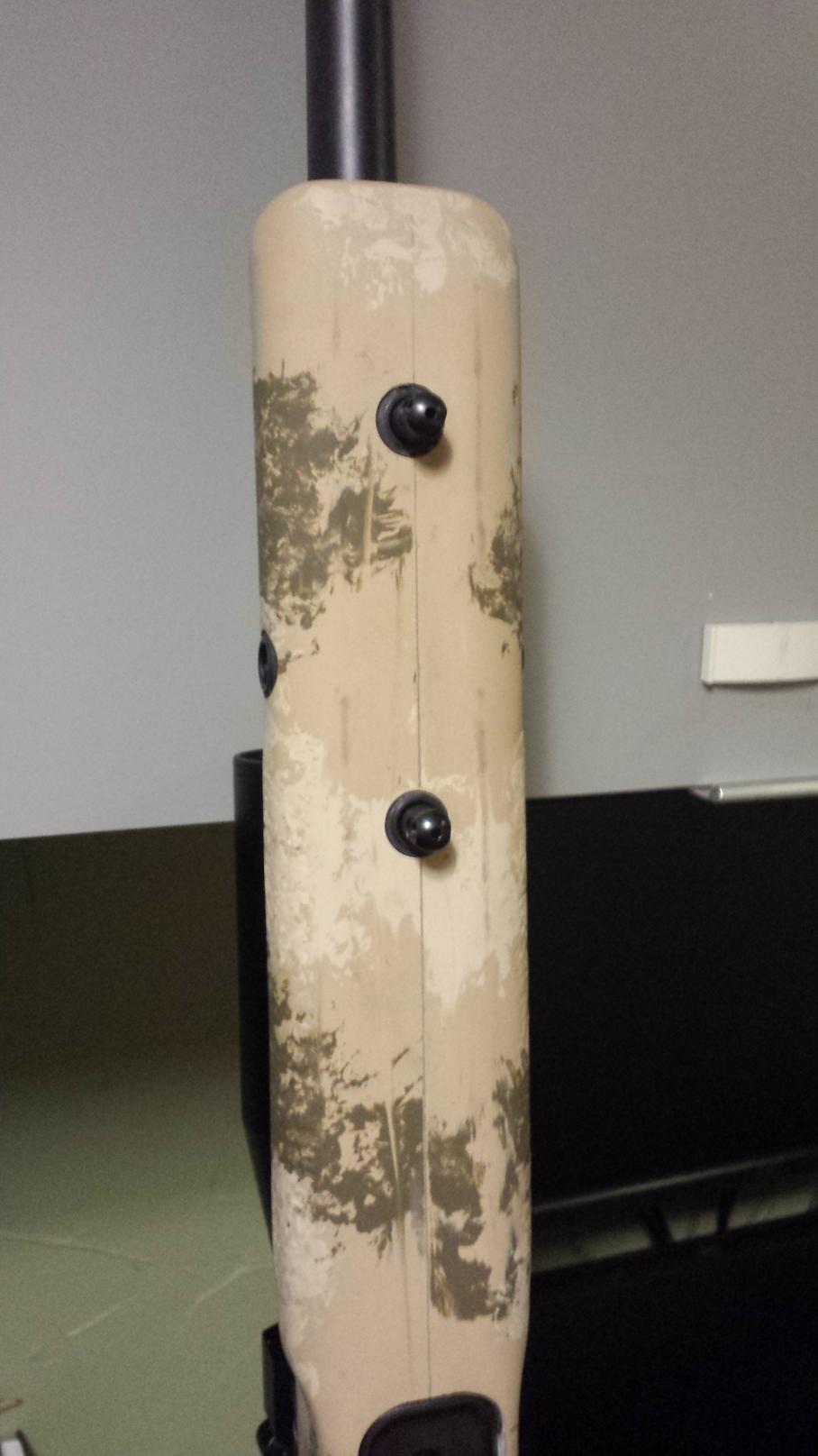

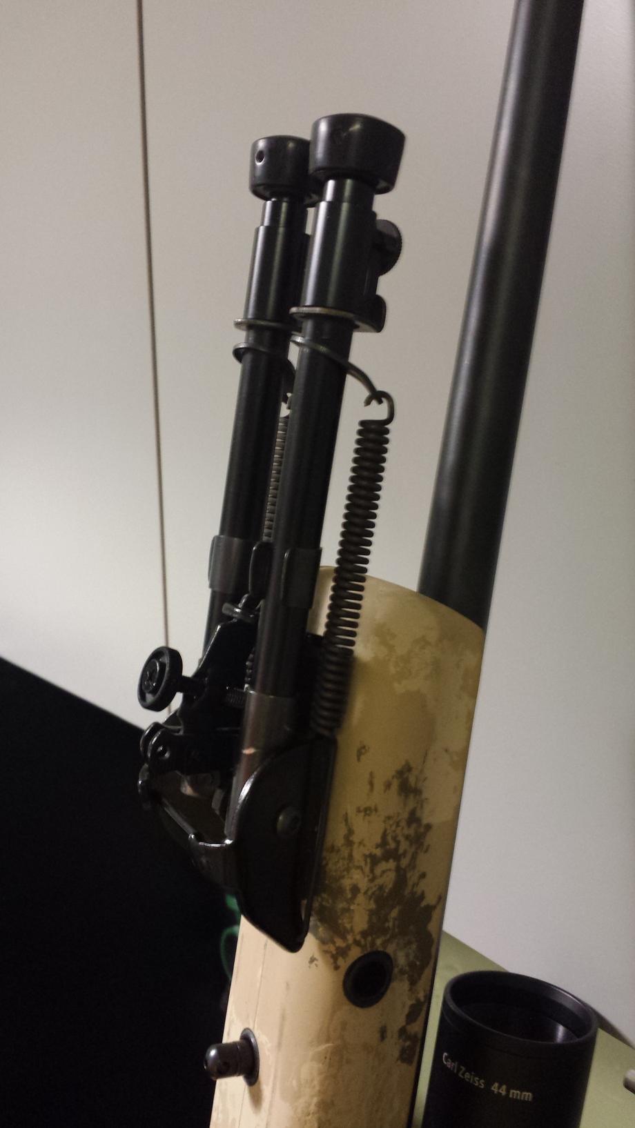

No, I have a bi-pod on it. I put the Harris on the QD Stud. Here is a pic of the rifle. I will edit with a pic of just the forend in a few. I have to go and take one.
The QD stud for the bi-pod is a rotating stud. The rest are non-swivel studs.

Ok those look like flush cups with swivel stud inserts/adapters. The blackhawk one should work for you

I apologize... I went back to see where I messed up my explanation and I found it. I meant to say, I do not have fixed swivel studs. I have flush cups with QD swivel studs. I apologize for the screw up.
