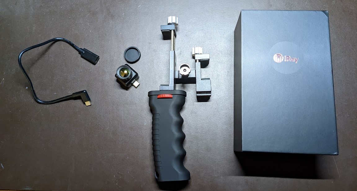

This is a review of the T2 Search Thermal Imager. It uses a 256 x 192 Resolution sensor at up to 25 Hz with a manual 13mm long focus lens. It also includes a USB-C Extension cable and a hand-held mount for a phone and the sensor. The mount is a little bulky and I will probably put some Velcro on the back of my phone’s case and the scanner to keep it a little slimmer.

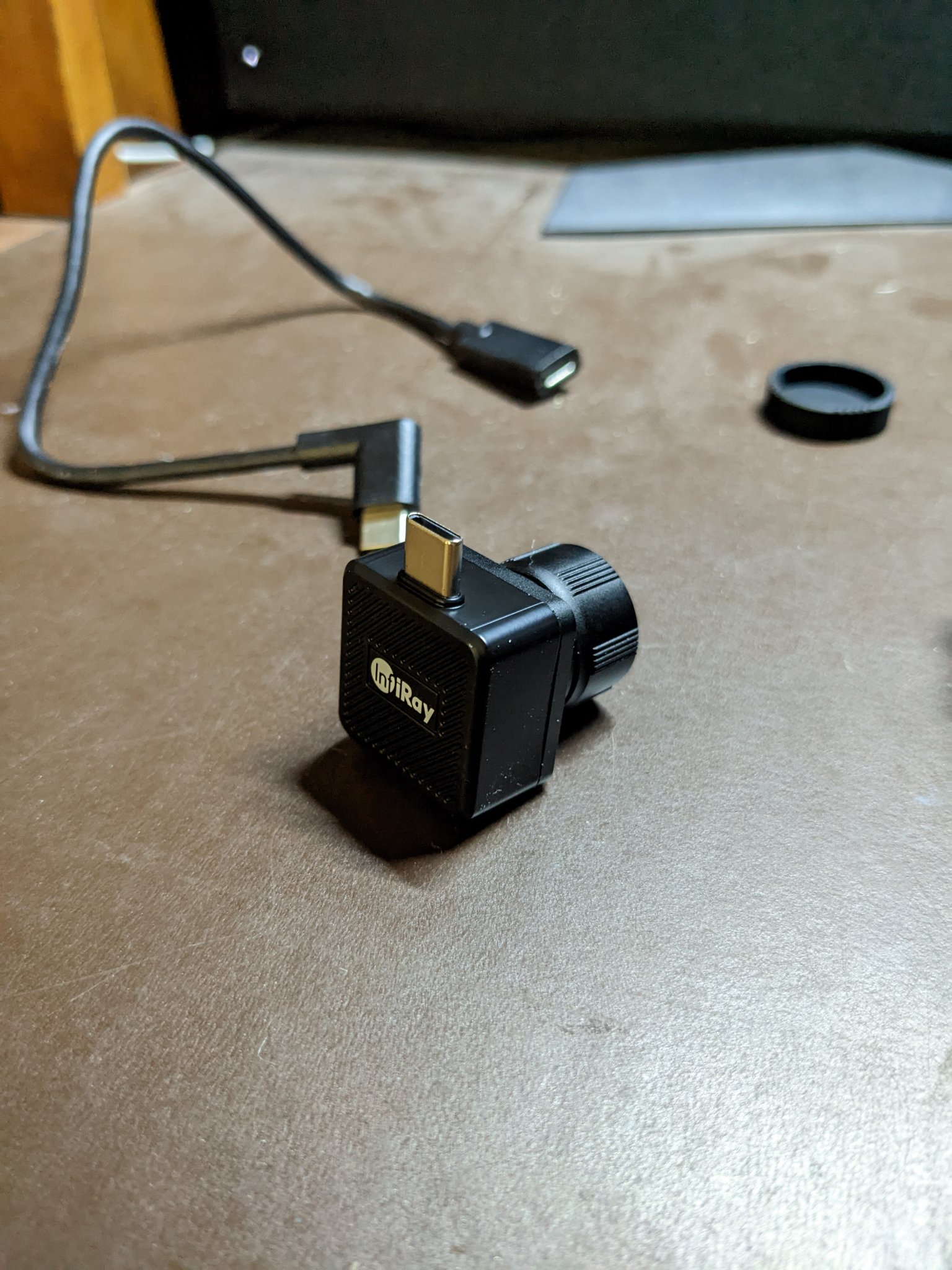

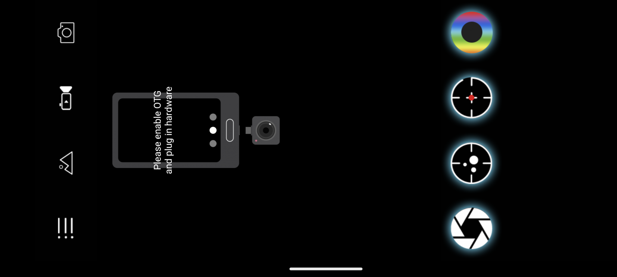

It did take a few tweaks to get it to connect to my Google Pixel 5a. It wasn't until I enabled developer mode that my phone was able to tell that an external camera was plugged into the USB-C port. I’m not sure if it was an issue with my phone's USB port or the cable, but sometimes the device would disconnect if the cable was bumped in any way. If I took off my case, I didn't have any troubles connecting it. The bottom of the handle features a ¼-20 female thread for mounting to a small ball head or tripod.

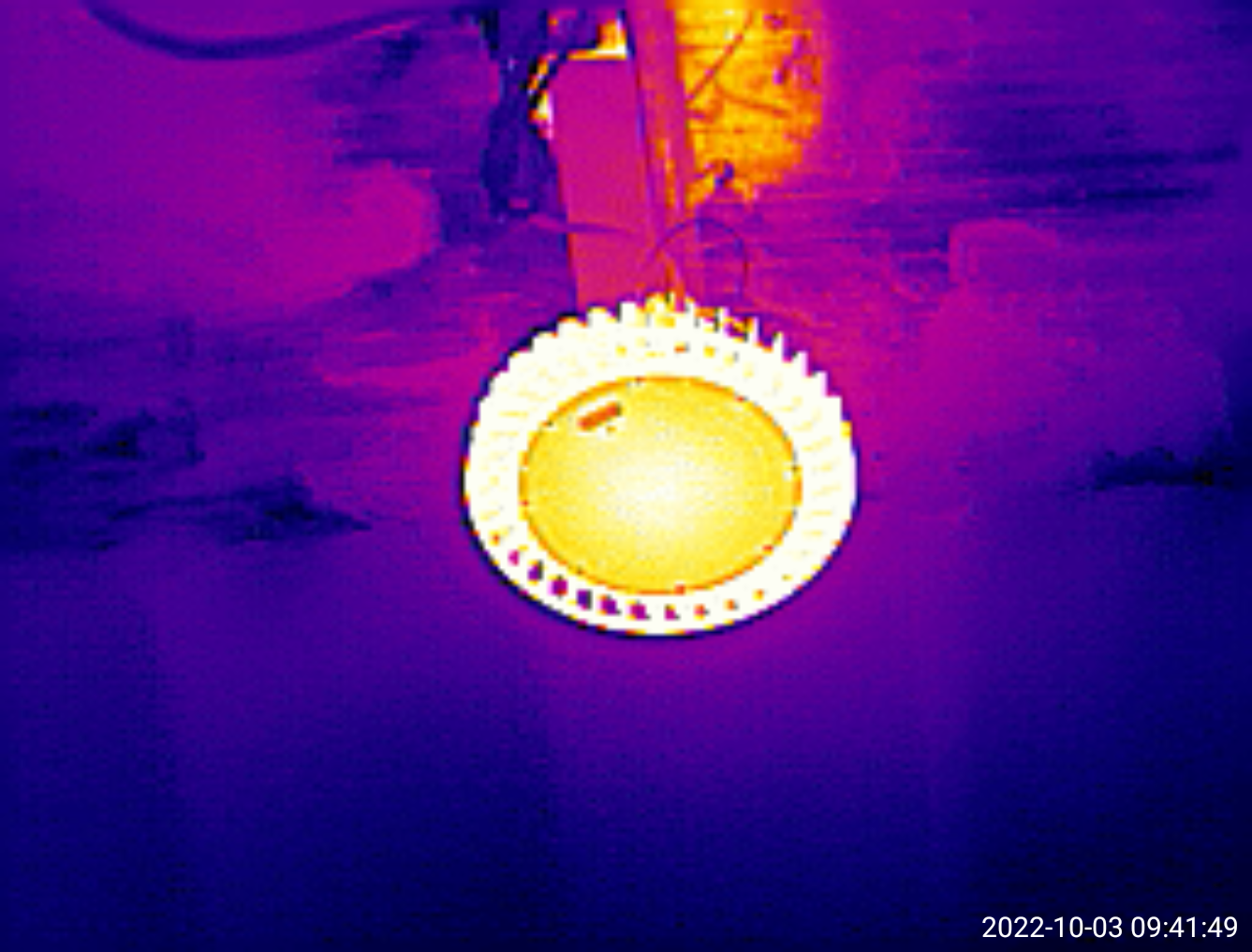

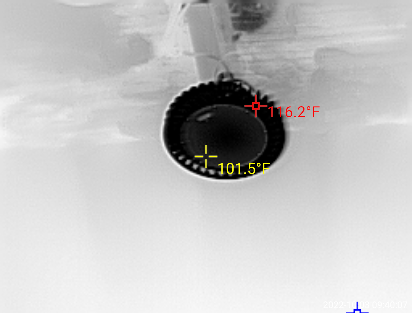

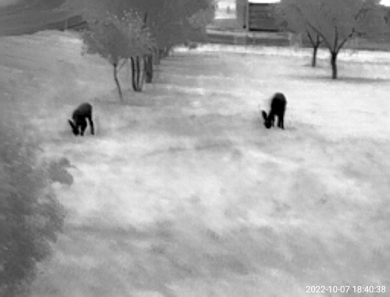

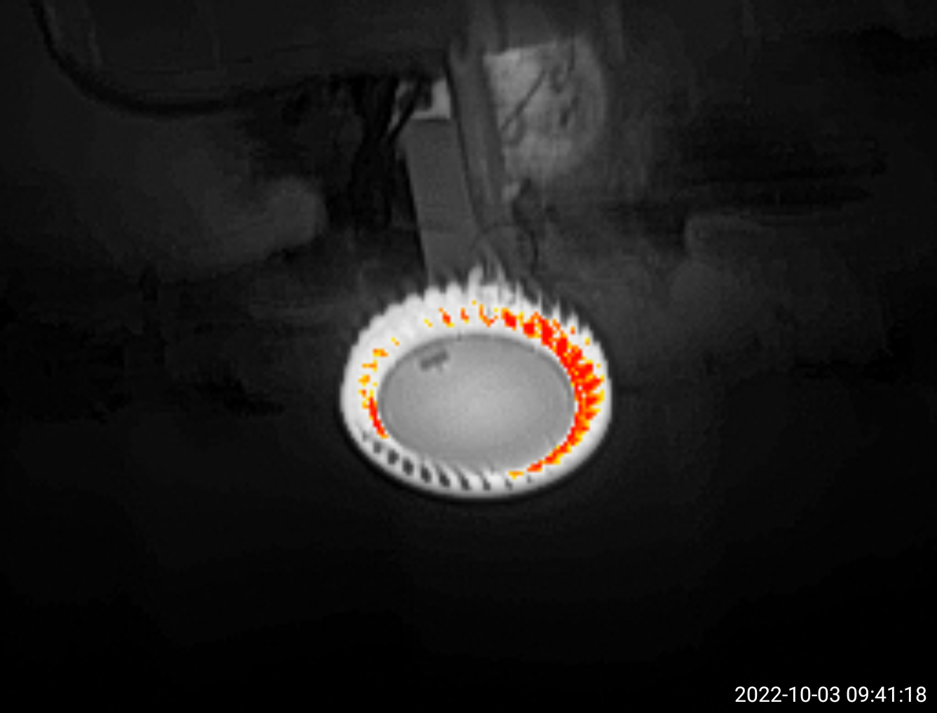

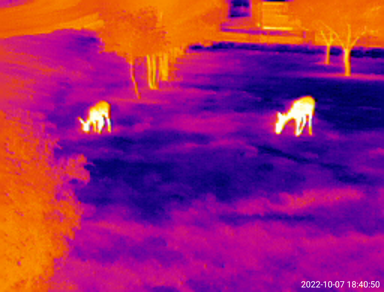

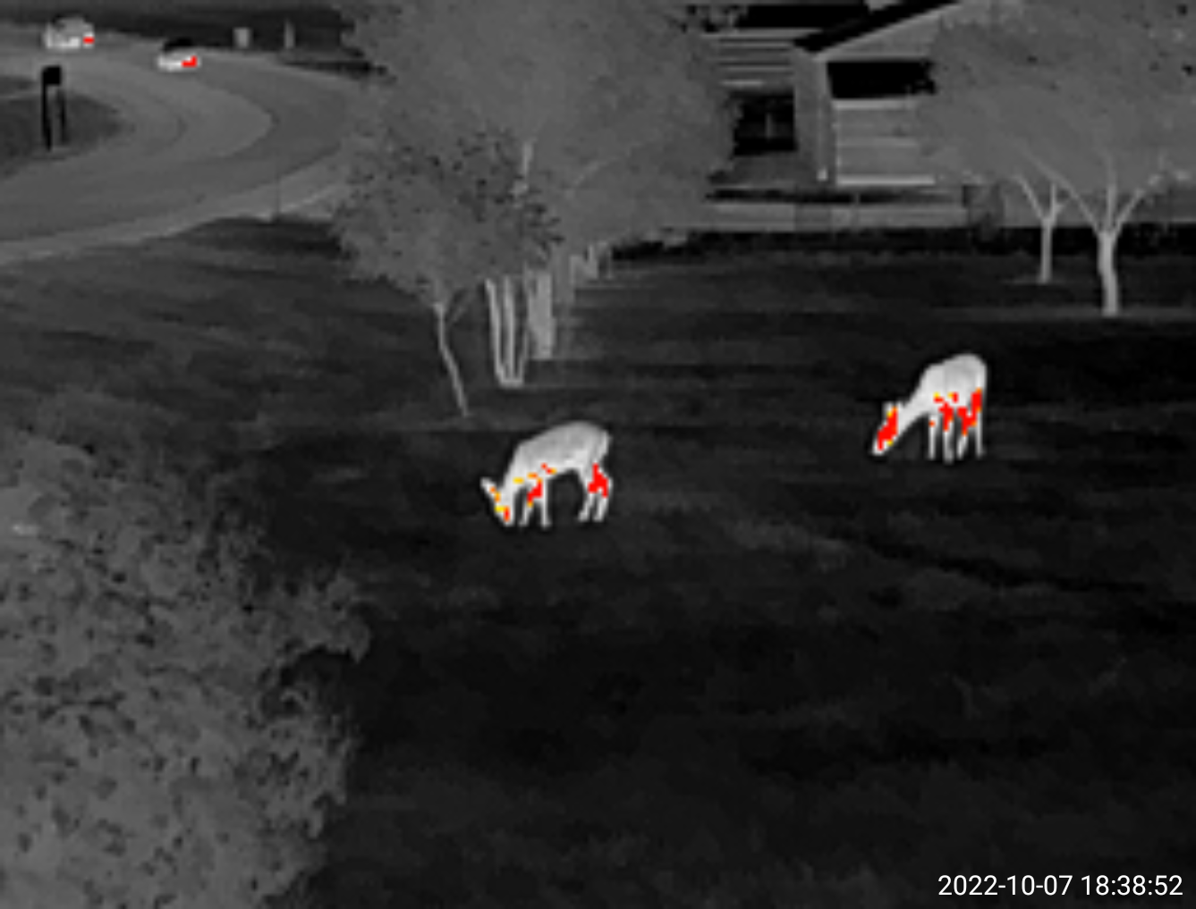

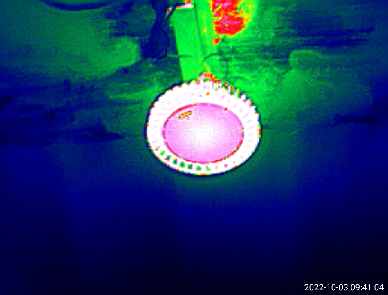

I was also supplied with the latest version of the app, Xinfared. From the file name it appears this version is from 9/21/22. Upon launching the app, a very loud splash screen shows and I have found no way to turn it off inside the app. Make sure the volume on your device is turned down low or off as this could scare off whatever you're trying to see. Here are some photos of a hot overhead highbay LED to show the different color modes as well as a few deer in my yard at roughly 50yds.
I think the red hot on black background was the easiest to make out animals and in the top left corner there are 2 cars at 250yds.

This is a review of the T2 Search Thermal Imager. It uses a 256 x 192 Resolution sensor at up to 25 Hz with a manual focus. It also includes a USB-C Extension cable and a hand-held mount for a phone and the sensor. The mount is a little bulky and I will probably put some Velcro on the back of my phone’s case and the scanner to keep it a little slimmer.
View attachment 7972465View attachment 7972466View attachment 7972467View attachment 7972468
View attachment 7972469View attachment 7972470View attachment 7972471
