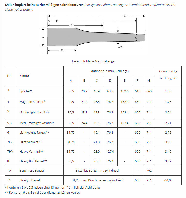

A friend just called me and told me, that there are Shilen-barrels available which a gunsmith imports.
So that is another option.
I´m totally open between LW or Shilen.

Straight taper or "bottle" style as you call it makes no difference. Just comes down to weight and outside diameter. Either will work fine. You said you wanted heavier than factory, which are usually the Rem Varmint contour and about 21mm at muzzle, and sounds like you had a thinner factory barrel at 19mm. If you don't want to go heavier like the ones I mentioned then you can go with something lighter.
You need to figure out the chamber and how much freebore is there in the minimal. If you can't find out then just go SAAMI and not the minimal. What bullet you plan to use?
Balance is important and with a KRG Bravo, which is lighter in the rear end, it won't have to be super heavy to balance out. I'd go light or heavy varmint depending on how much weight you want. The 7LV or HV or similar in the Lothar Walther.
