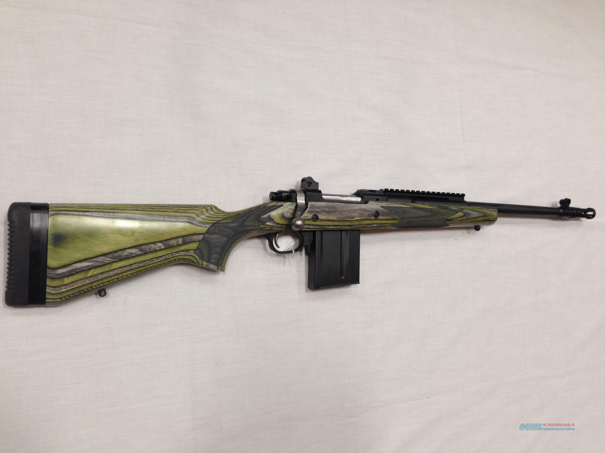

I’ve had no problem popping steel at 600 with a 17”, and no problem killing deer at 400 with a 13” it groups well at 100 also. If you want small and light get a SCAR.
or a scout.
