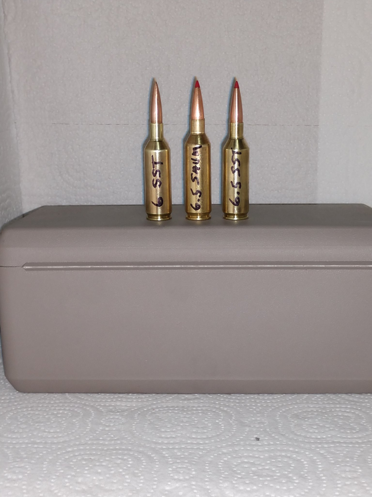

Let me throw a ringer in the mix. MY new 6.5 SST (Sherman Short Tactical) is performing VERY well in PRS. You can run 140's at around 3175 max but will give outstanding accuracy and very good barrel and case life at under 3100'. I have a guy that just checked his throat at 1000 rounds and saw very little erosion. He figures 2500-3000 rounds. Now for the good news; my coal with a 147 ELDM at 3107' is 2.770". I have prepped Norma brass in stock as well as reamers and dies. I will have head stamped brass this summer.....rich
Let me throw a ringer in the mix. MY new 6.5 SST (Sherman Short Tactical) is performing VERY well in PRS. You can run 140's at around 3175 max but will give outstanding accuracy and very good barrel and case life at under 3100'. I have a guy that just checked his throat at 1000 rounds and saw very little erosion. He figures 2500-3000 rounds. Now for the good news; my coal with a 147 ELDM at 3107' is 2.770". I have prepped Norma brass in stock as well as reamers and dies. I will have head stamped brass this summer.....richView attachment 6879497
What's the parent case?
Not to speak ill of your cartridge, looks like a great performer and well suited for ELR shooting or hunting. However, it's at the opposite end of the spectrum of where PRS is going. Can't say that I know of anyone shooting a magnum cartidge in PRS as their primary competition cartridge,
And it's pretty significantly off topic when the OP is asking about 6BR.
Sorry, I didn't read thru the entire thread but was going mostly on the title. The op said (Talk me into or out of) Actually, some of the people I am in contact with say PRS is going longer range and they feel it will be an advantage. I don't personally shoot PRS.
Sorry, I didn't read thru the entire thread but was going mostly on the title. Actually, some of the people I am in contact with say PRS is going longer range and they feel it will be an advantage. I don't personally shoot PRS.
Your cartridge would be awesome for the PRS ELR matches. I think the best placing shooters at the last ELR match were shooting some sort of 6.5 SAUM or variant. For the regular season PRS matches where average target distance is usually under 500 yards it would probably be a bit much.
