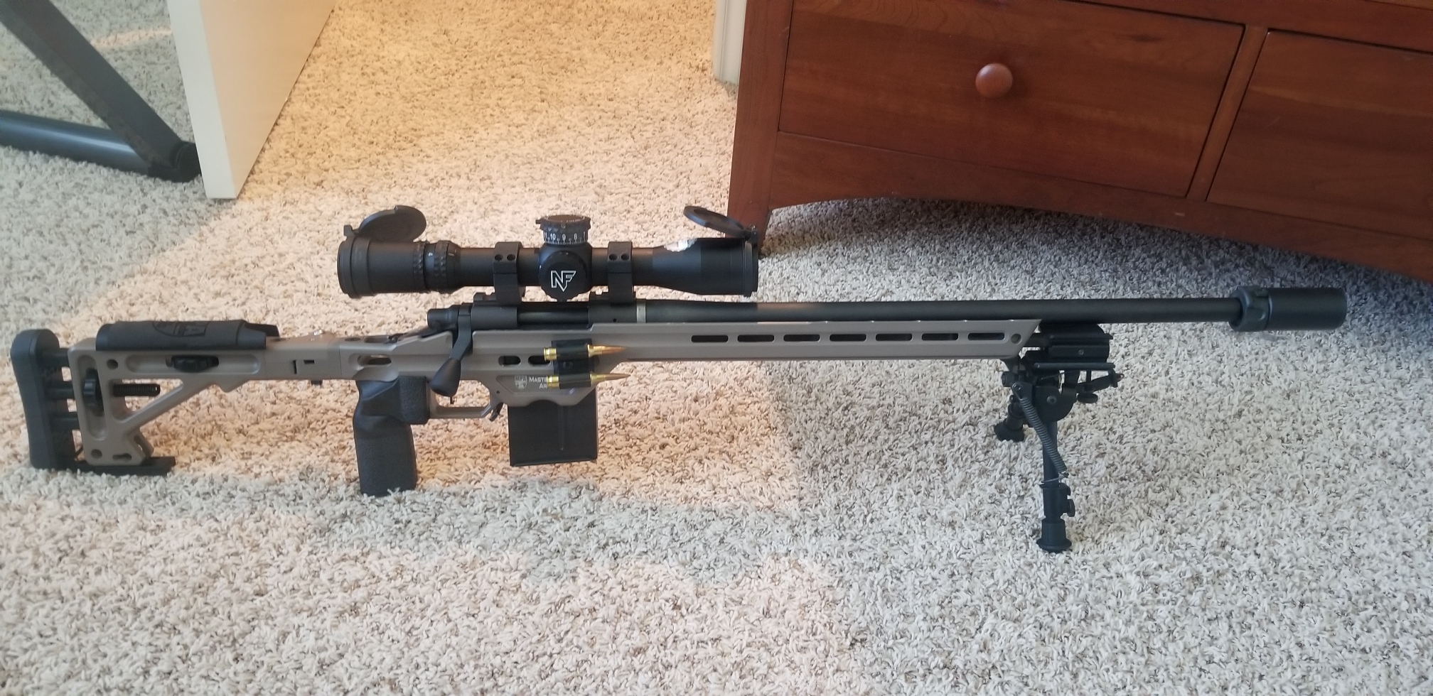

    This would be my first bolt action precision rifle. Looking for opinions on a folding chassis or rigid. Specifically an MPA. Does the hinge actually handicap the accuracy of a rifle with regards to stiffness?

    Thanks for the sentiment. I’ve got the scope. Bipod on the way. Now all I have to do is settle on a caliber, choose an action, determine what barrel to go with, and wait for the reloading fairy to magically leave some reloading components under my pillow.

    I have 3 folders and 2 non-folders in the MPAs. No detriment to accuracy as mentioned already, but I have to say MPA really doesn't have the best folder out there. Definitely better than XLR but the AI folder mechanisms are simply the best that I've used.
    Can you tell me, specifically, what you don’t like about the MPA folder?
