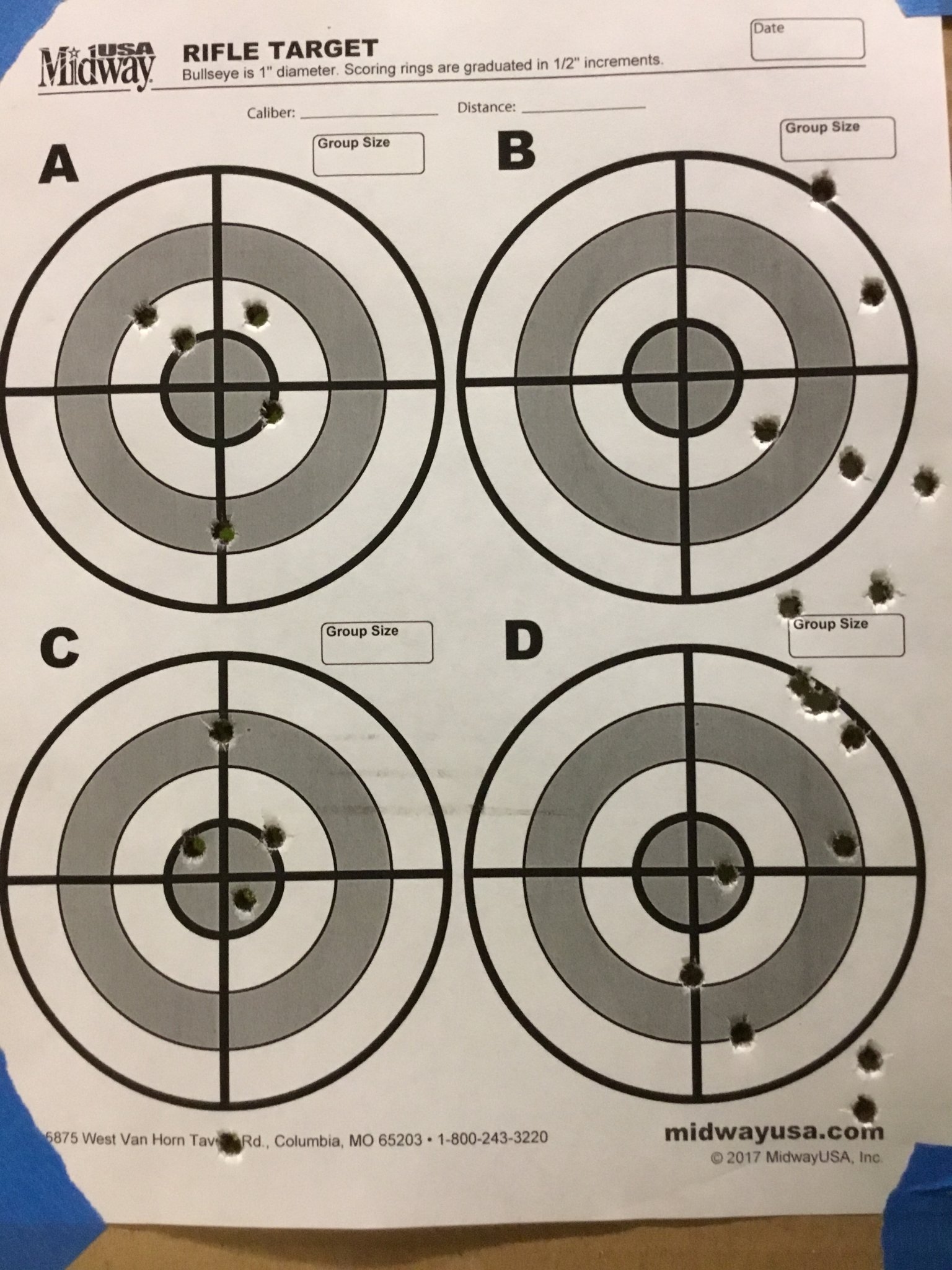

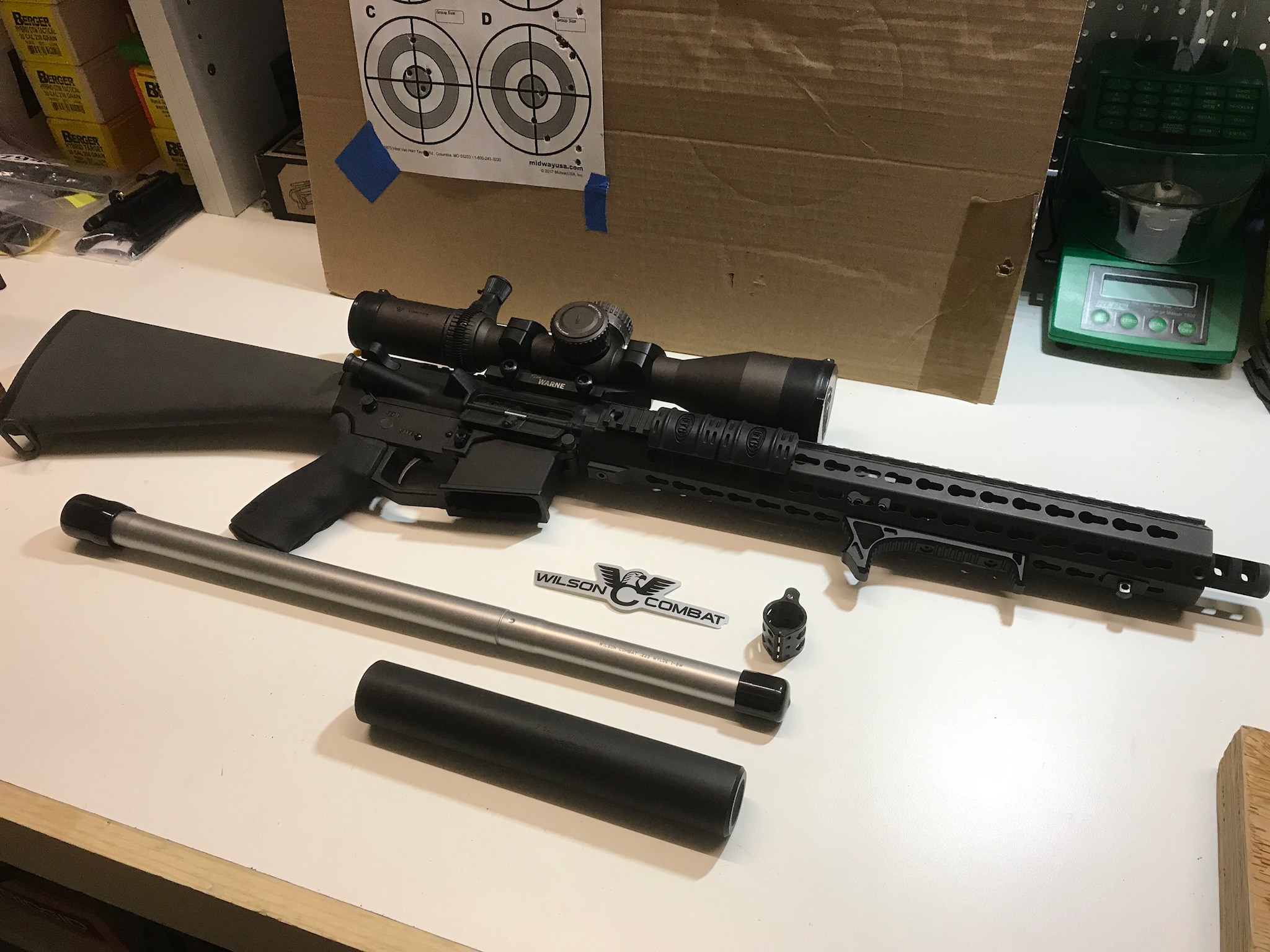

Only the best, vortex gen ii scope, timney trigger, JP silent caputre, three different stocks. magpul prs, A2, magpul ctr.
This thing cycles like a dream, but shoots like a shot gun.
Here is the groups, the left is five shot groups with 69 SMK ‘s and the right is the groups using 10 shot groups same load.
Factory? Brand? Handloads? Have you tried any other ammo? I have a lr308 that shoots one load into a “group” you’d be hard pressed to cover with a cowboy hat, and another load you could cover with a nickel.

I have exhausted my tests with this barrel, i have several AR’s all built for different type matches. All shoot great groups. I shoot a lot of AR tactical matches, so I need two rifles all the time. You never know when something will go wrong at a match. Most of ammo is hand loads from 55 gr to 77 gr SMKs.

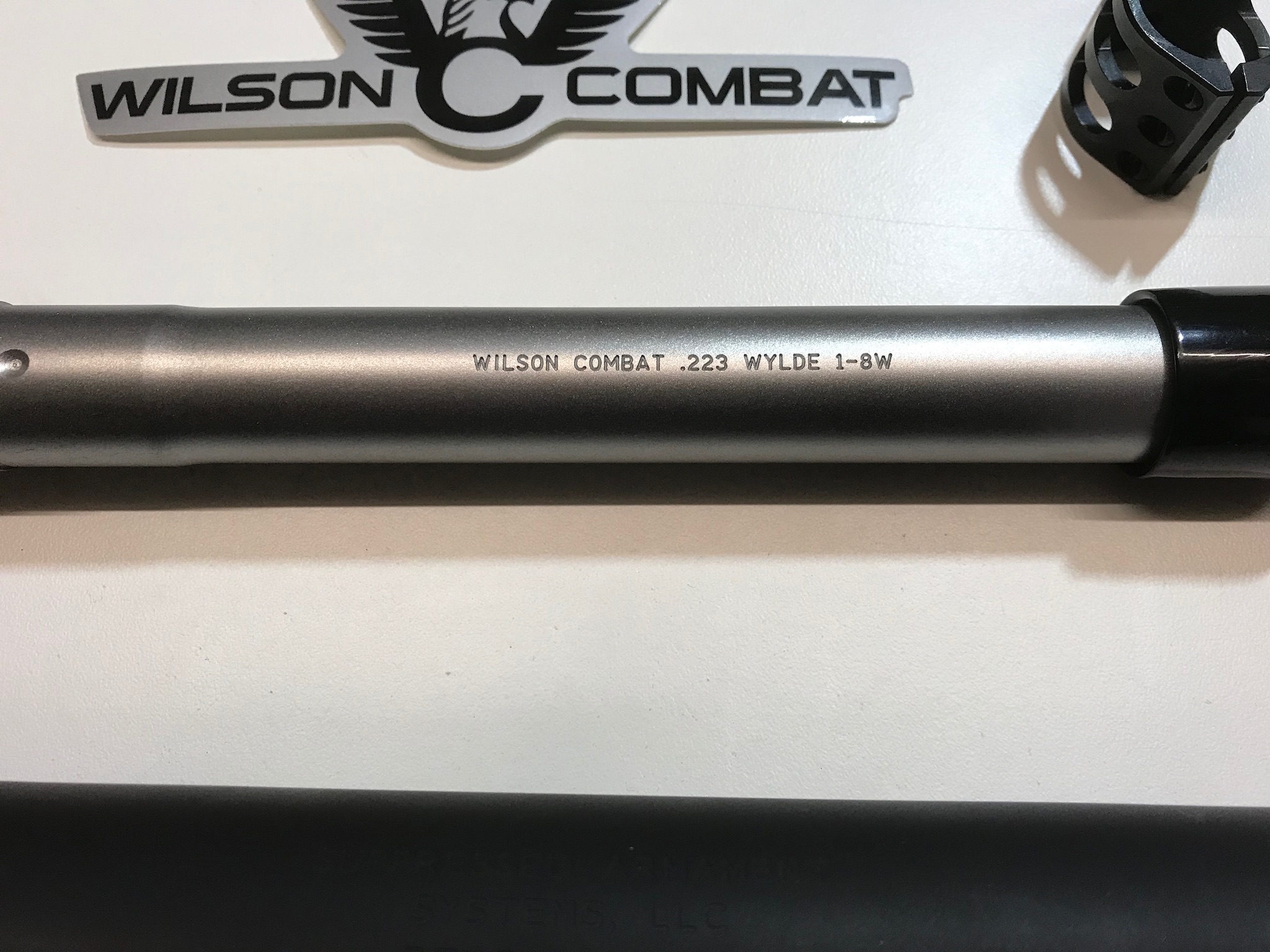

No, I just ordered the Wilson Barrel today. I was looking for people who have them and how they shoot before I buy one.
Ok well then that sheds some light into the darkness of this thread. In all fairness to WC I have no affiliation to them other than products I have bought in the past but I think there was some misrepresentation of the barrel in question here.

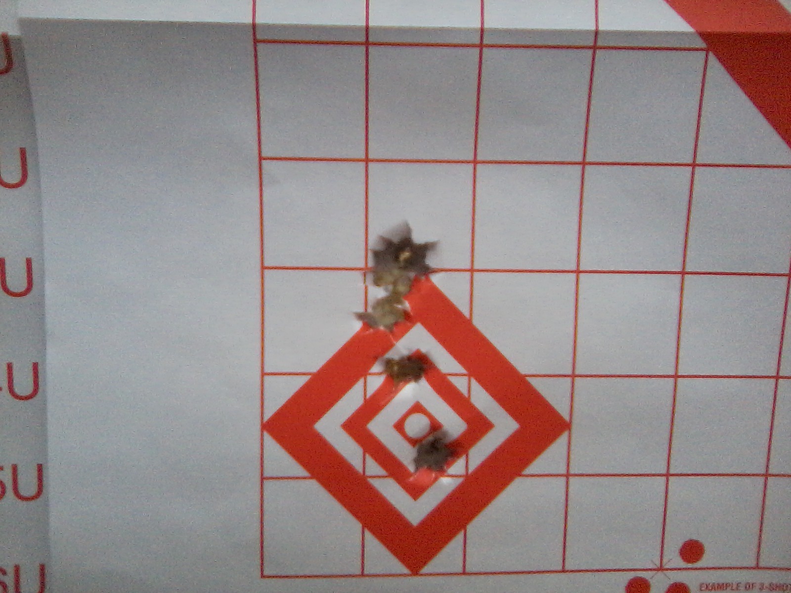

Very underrated barrels. I love mine. Built my 6.8 and my buddy’s 6.8 at the same time. Here’s the sight in pic I sent him. Walked 3 up with crappy Nikon Buckmaster 3-9. Remaining 7 from the mag in the same hole. Factory 110 VMax.
My barrels shot the same with 120 SST factory loads. 90 gr gold dots do well at killing 2 liter soda bottles at 330 yards.
