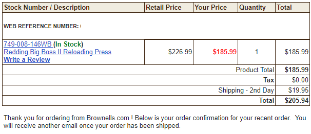

alright, the deed is done
thanks everyone for your input
It looks like I got the last one!
Reactions: yakstone and Fig

Too late!
So the turret on the T7 flexes, that's lame. The BB2 doesn't have a turret, what aspect is mechanically unsound? Loose/sloppy tolerances? Flexible linkage?
