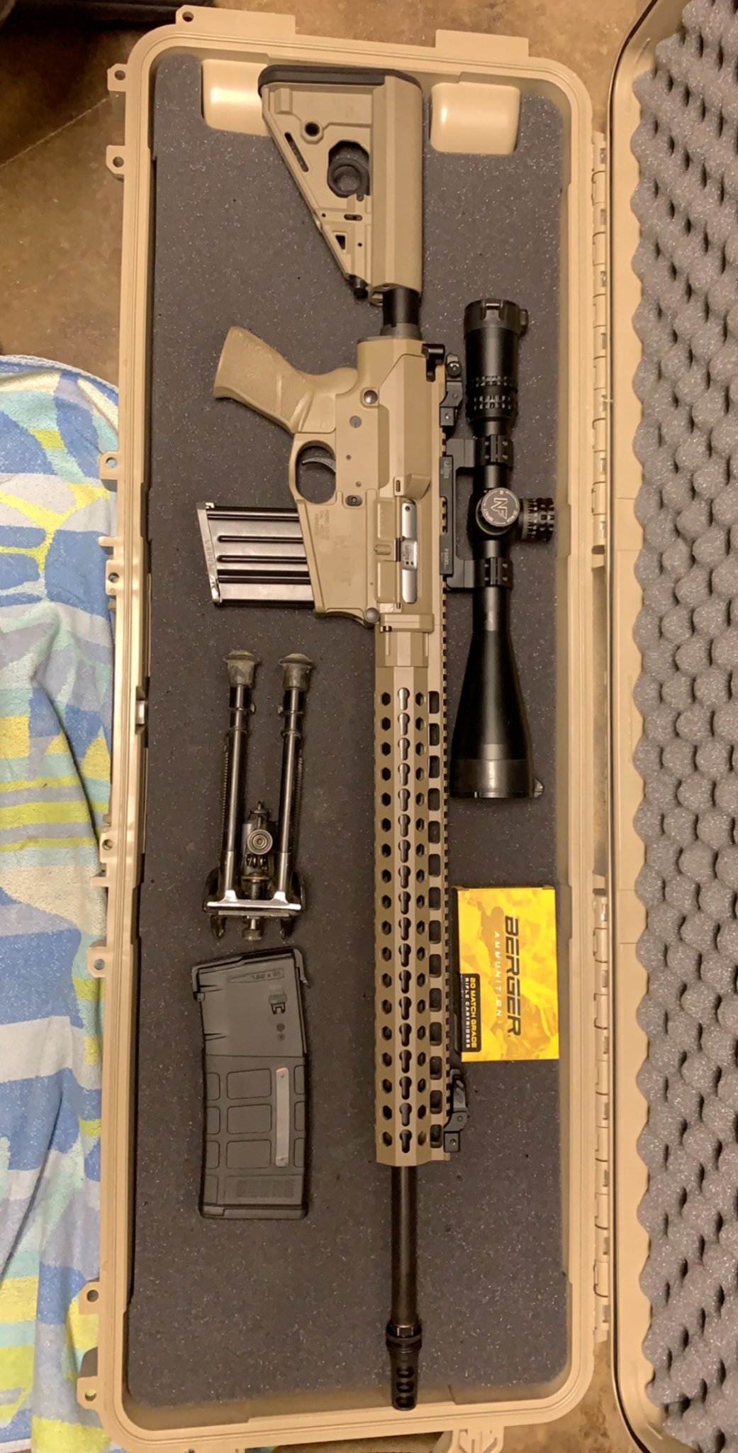

I've got a UU kit in 22" 260 Rem with about 1000rds down the tube. It holds about 1-1.25moa with factory Berger and Hornady Match ammo. Getting about .75 moa with handloads. Very good bang for your buck and hasn't given me any problems to date. I am running it with an Omega and a SLR AGB.
