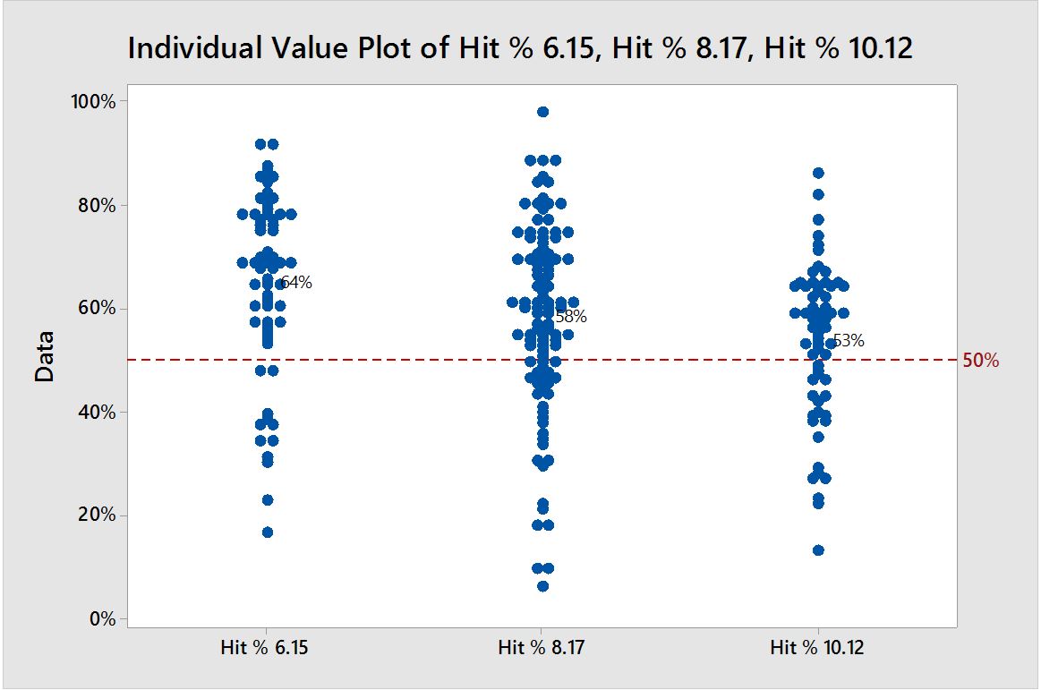

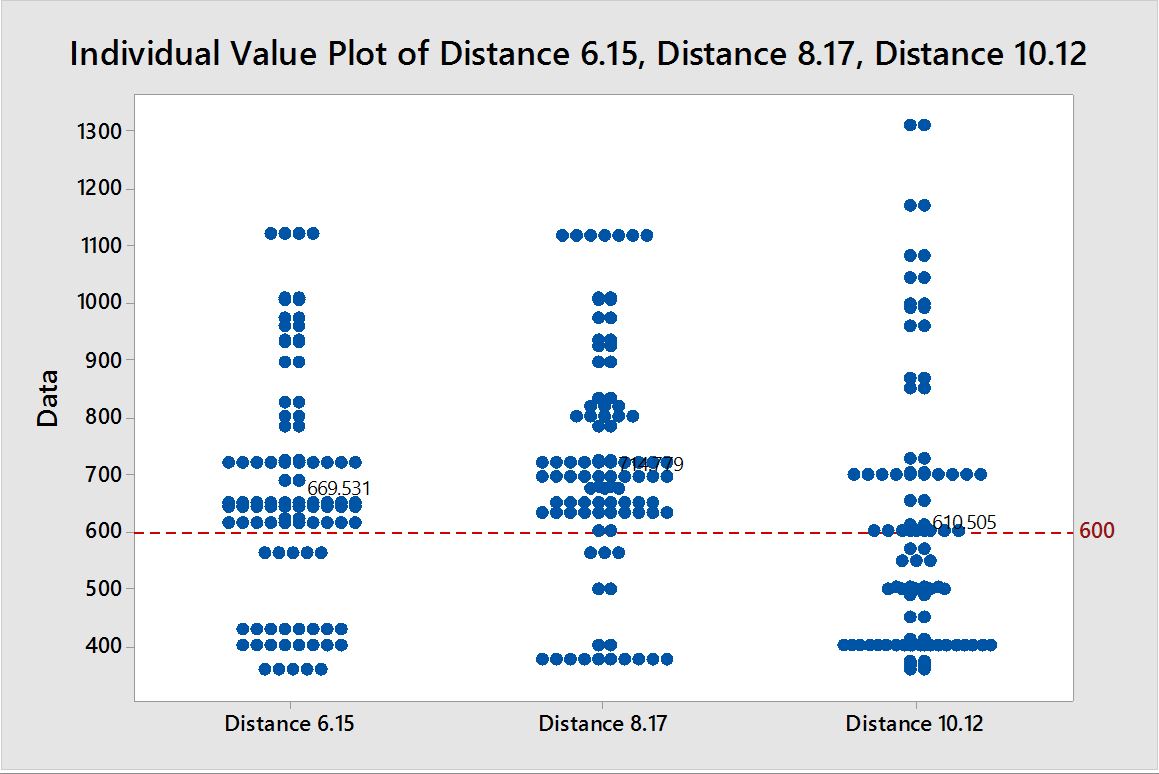

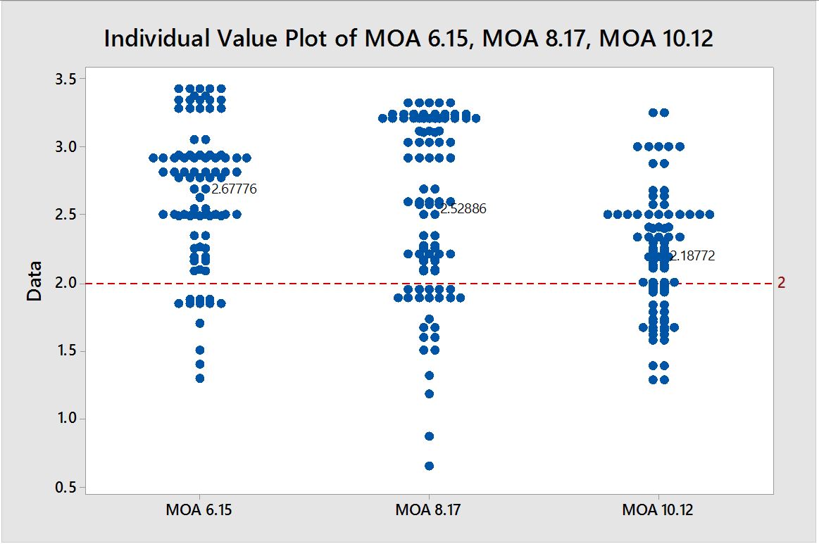

Here is data from three 1 day matches I shot this year. Everyone seemed to be happy with the courses of fire. The participants ranged from PRS champions to first time shooters.
