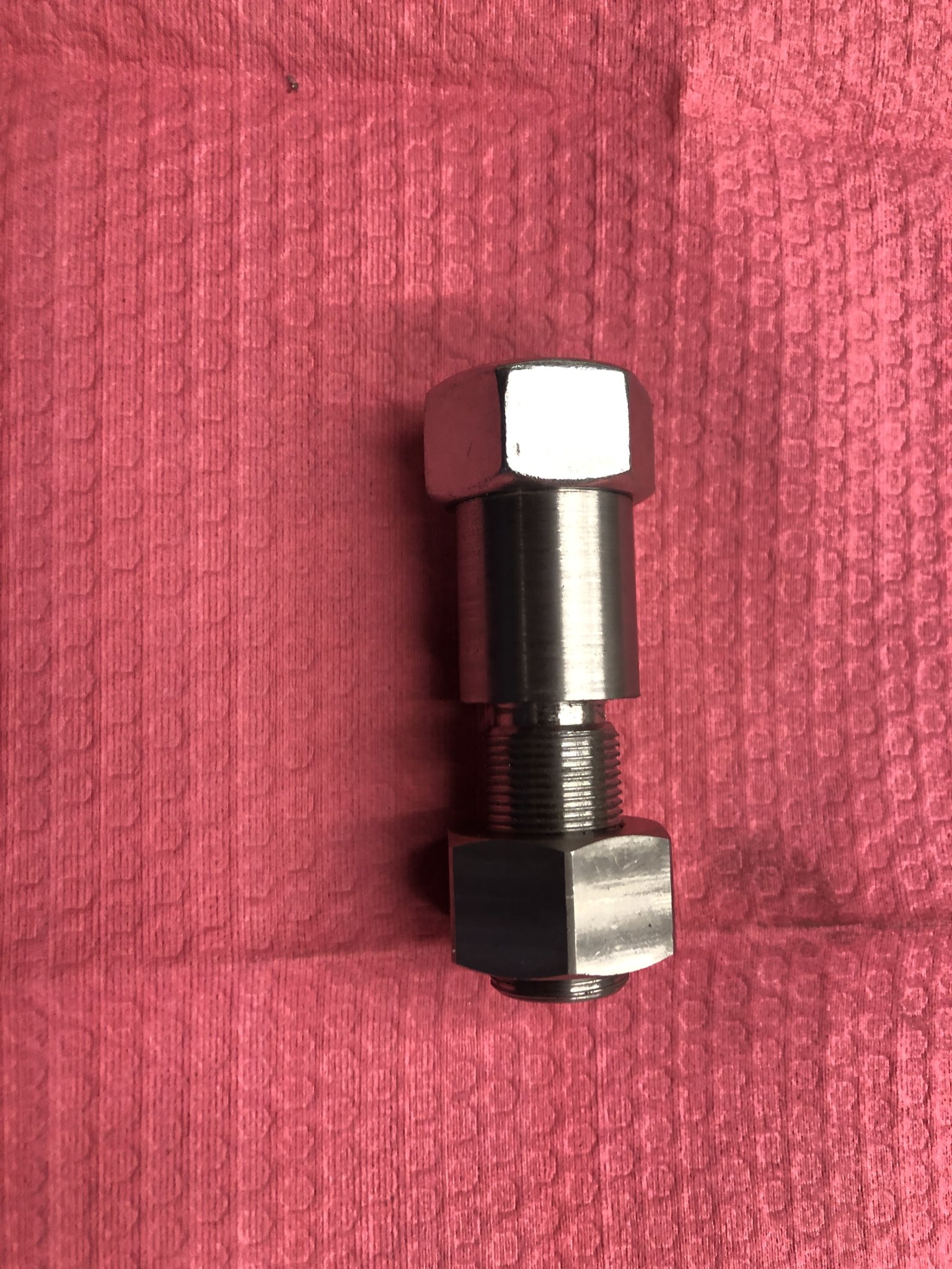

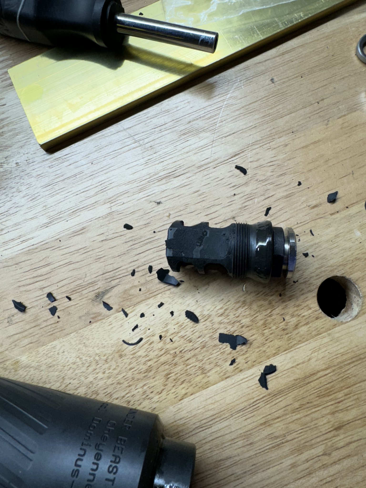

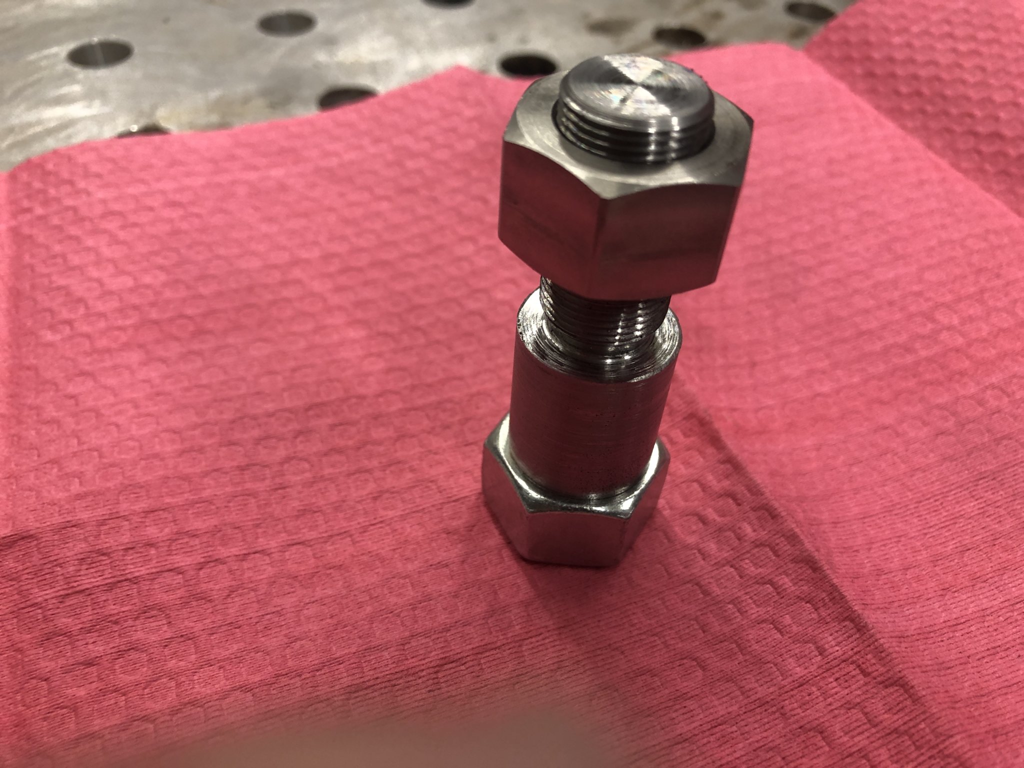

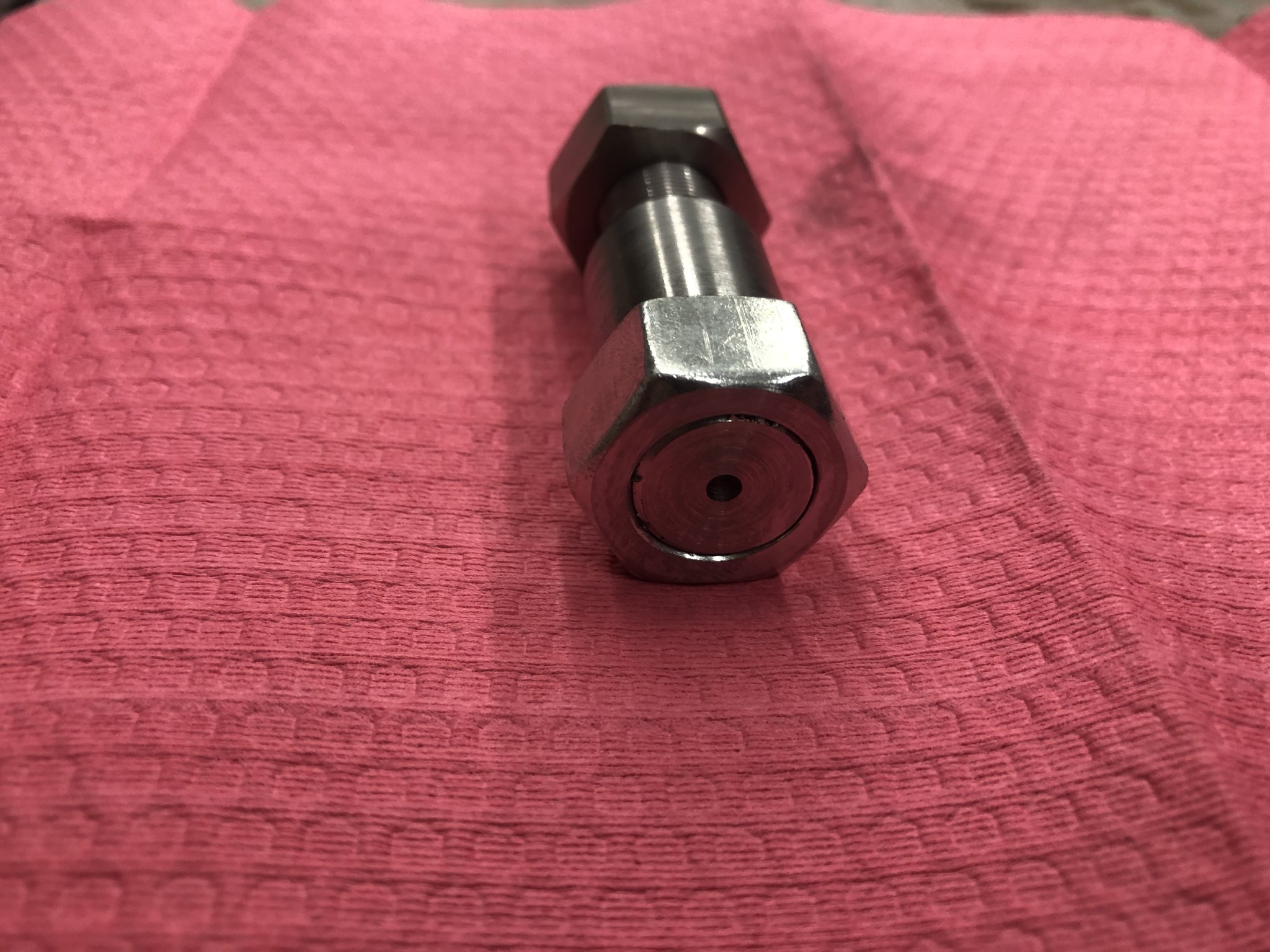

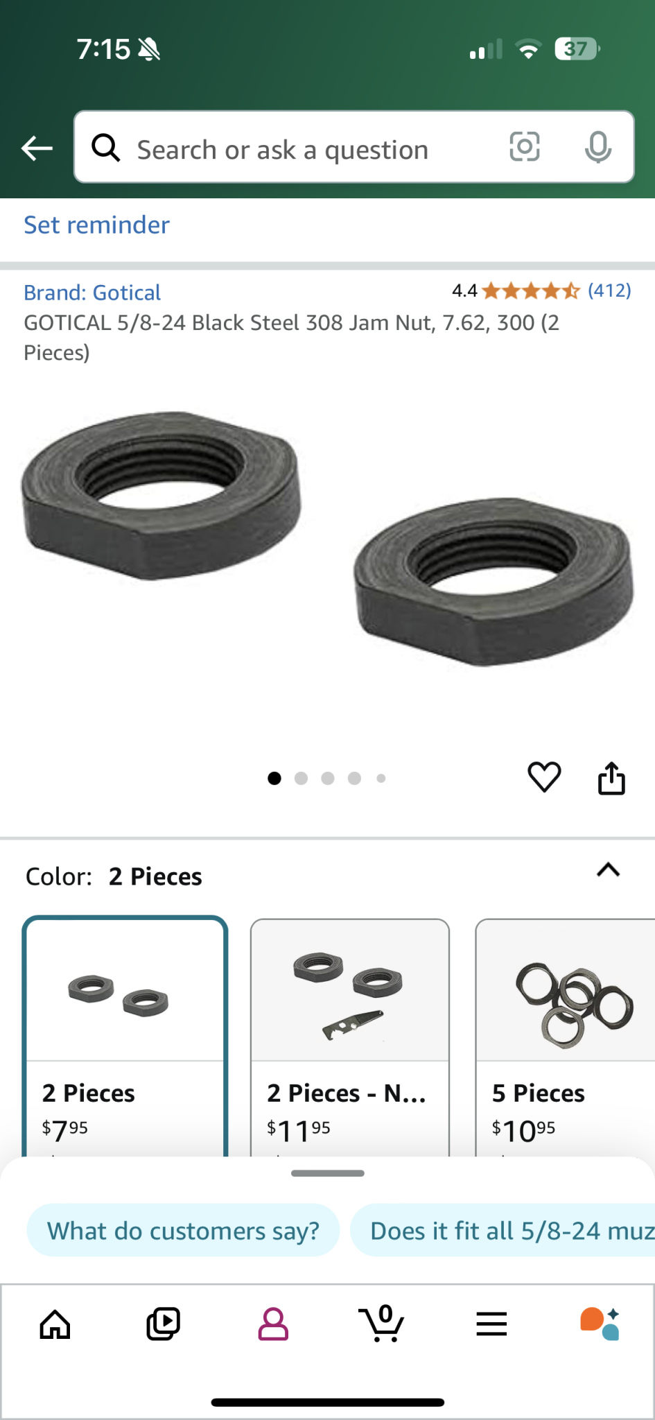

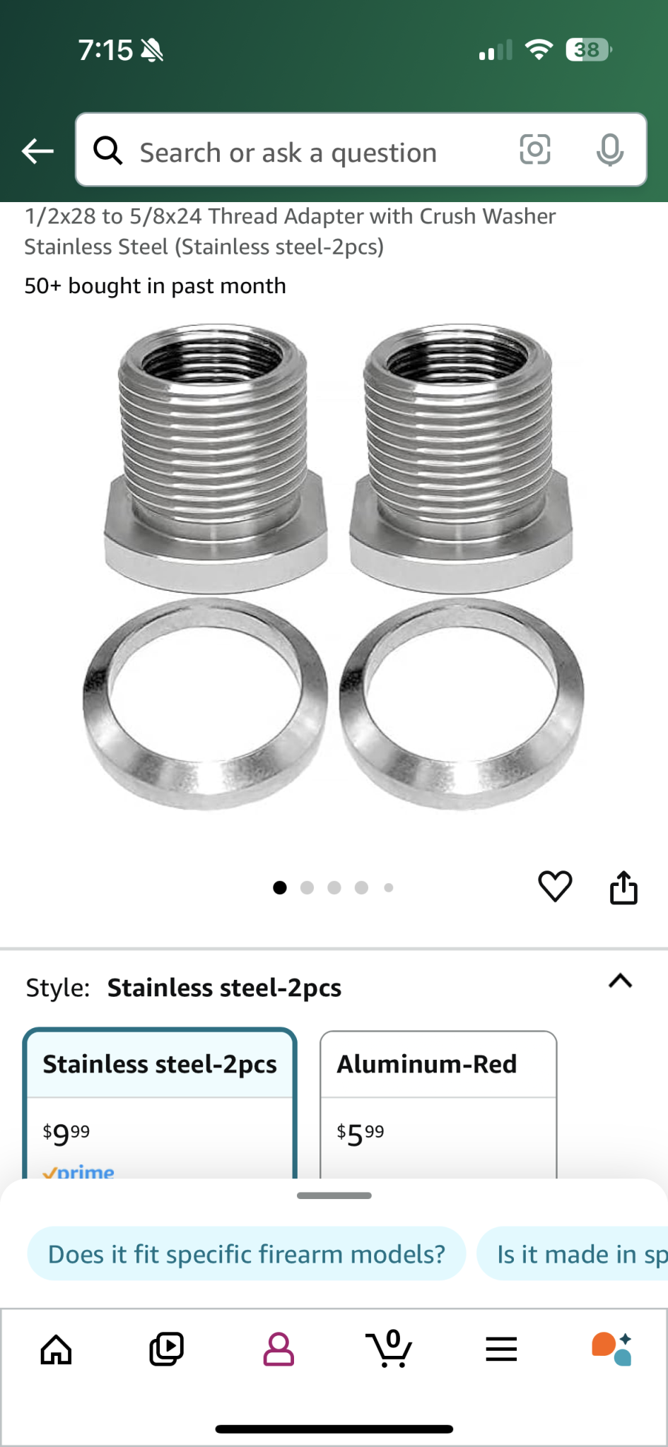

Please elaborate on this technique and tools
Thread jam nut all the way onto adapter, screw in adapter into stuck muzzle brake, screw down jam nut really snug, take wrench and turn on the adapter , muzzle brake broke free with almost no effort, I didn’t even have the can in a vise, just held onto it while I turned the wrench.
