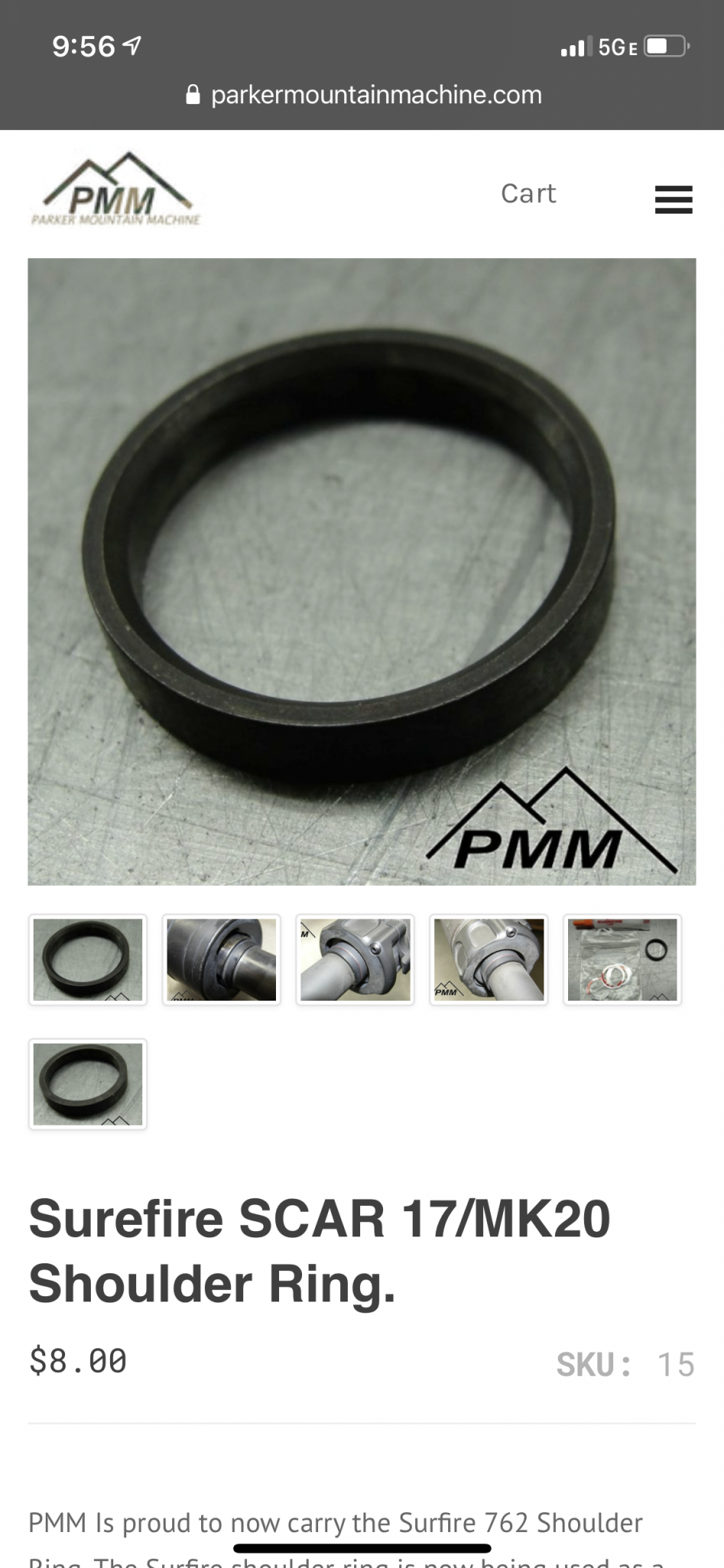

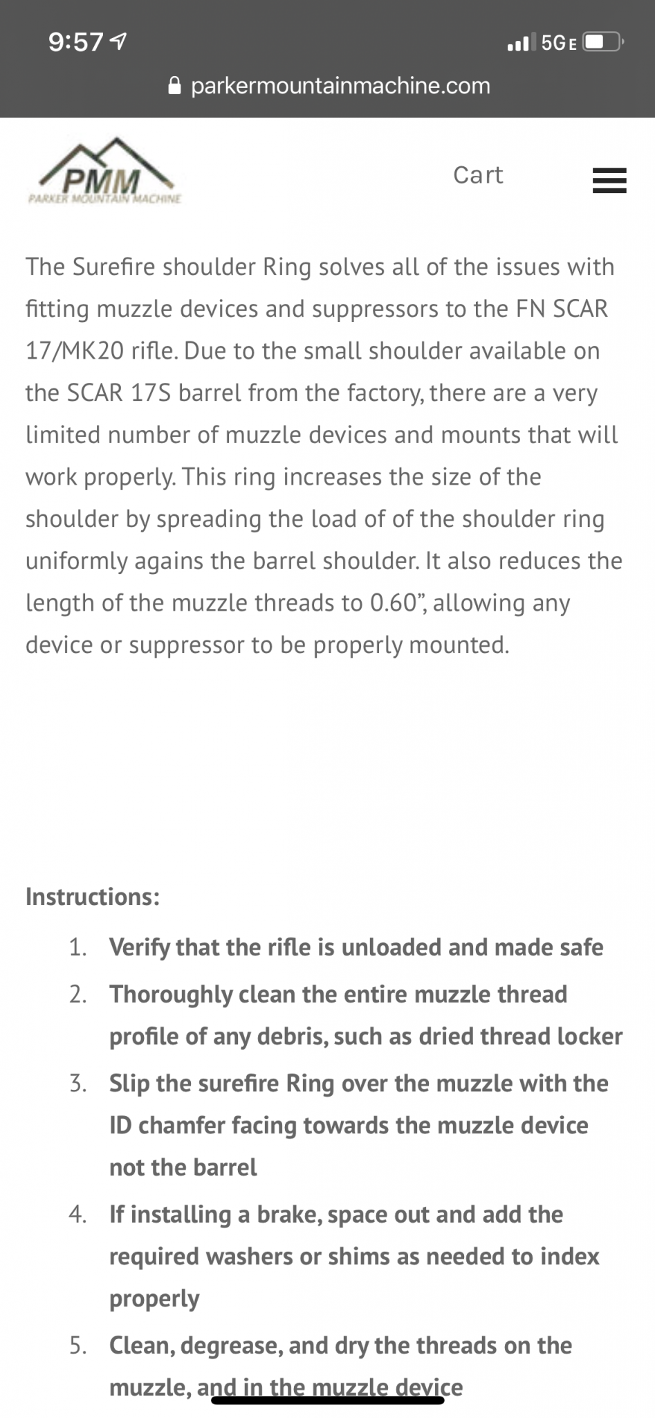

Couldn’t y’all have used tbis?

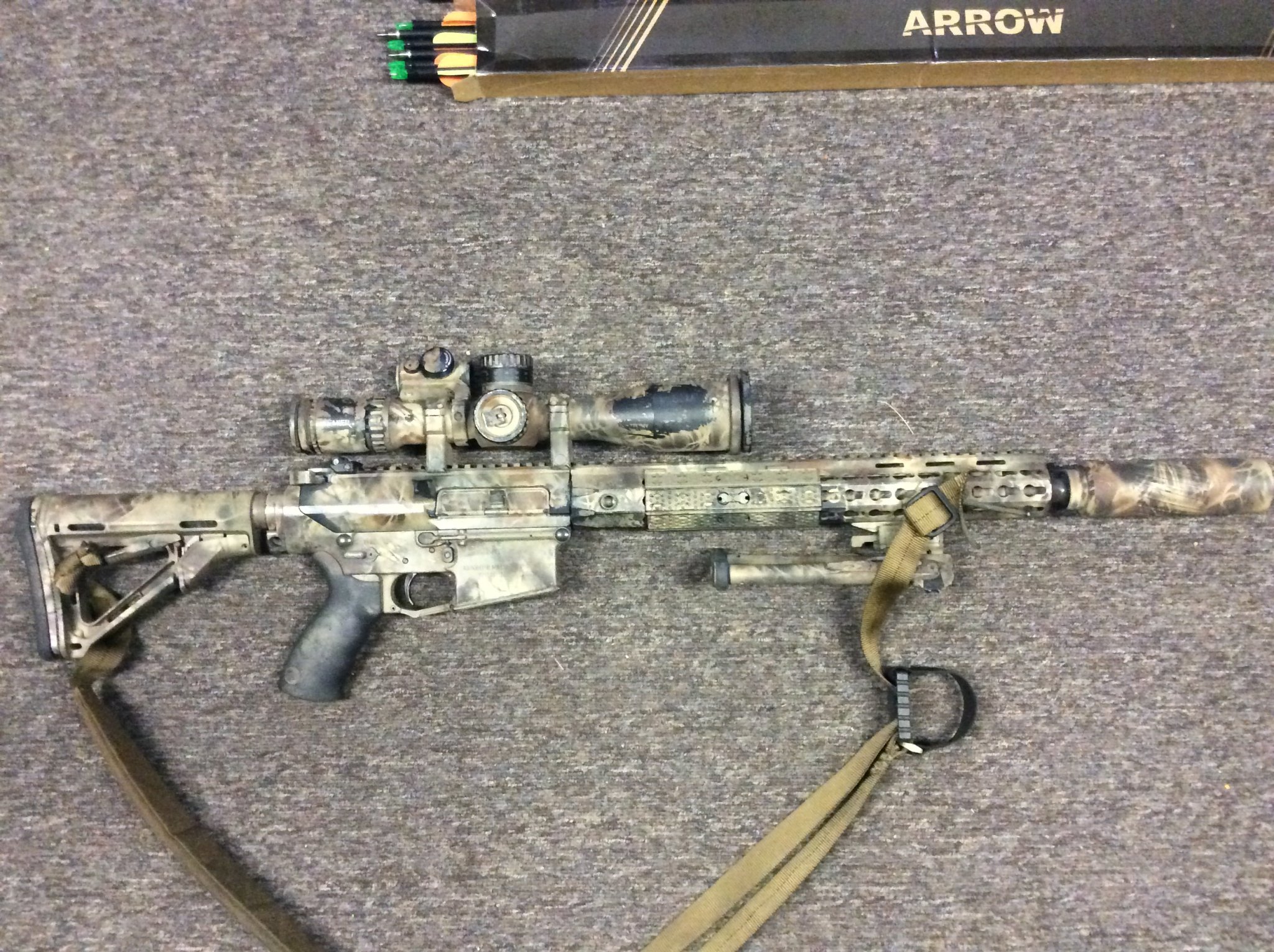

Two questions:
1) Cerakote or Rattle Can?
2) Did you use an adapter or is the brake/mount directly threaded to the KAC barrel?
I’ll have to watch my language, since this is a public market.
Rattle can.
Rattle can.
