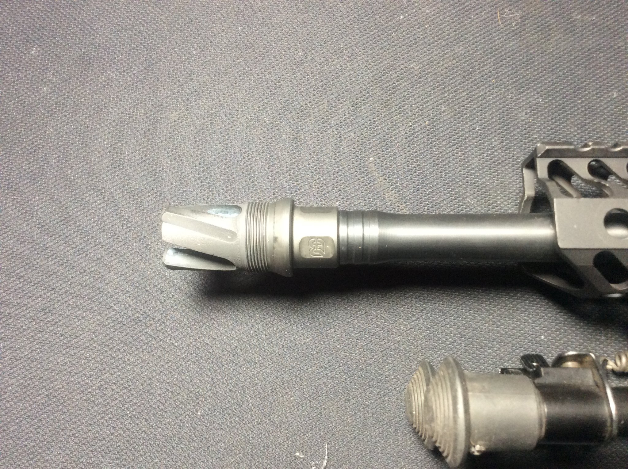

Here is a pic. Accuracy may depend on the rifle, wear should not be an issue.
