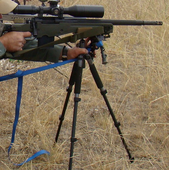

Cut the end off a motorcycle tie down and feed it back into the ratchet backwards to leave the loop end free to hook around the un--used ends of the bi-pod or around the end of the hand guard.
Attach the hook to your belt and pull it until you have tension which will take some of the movement out of your gun. We use this the same way when using a tripod except it goes under the tripod. Switch the sling to right side and have it tight against your trigger arm. Works well with practice.
Here is a photo so you can get the idea
Totally forgot about this technique. I think this would definitely have helped with removing vertical and sway. Would have been tricky at that match (had cold weather gear on with no place to buckle) but I'm going to experiment with rope cinched around waist this weekend. I think this might be the ticket for these types of stages. Good suggestion ?.
