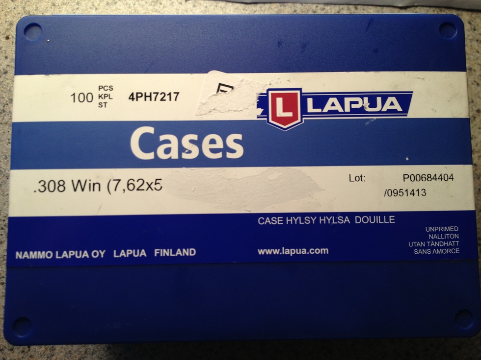

That ain't hot, maybe Lapua isn't all it's cracked up to be, I just bought 100 cases and the weights varied quite a bit more than I expected.
Nice box though.

Would be interested in the lot#. Here is mine that had loose primer pockets after 3 loadings.
OH, NO! I have lot P00684403 on its first loading! I hope they don't suffer the same problem:( The lot I'm currently running with loosened pockets is P00612002. I wonder how many are in a "lot". Does a lot span a few thousand? Or, many thousands over the course of a couple weeks or a month?
