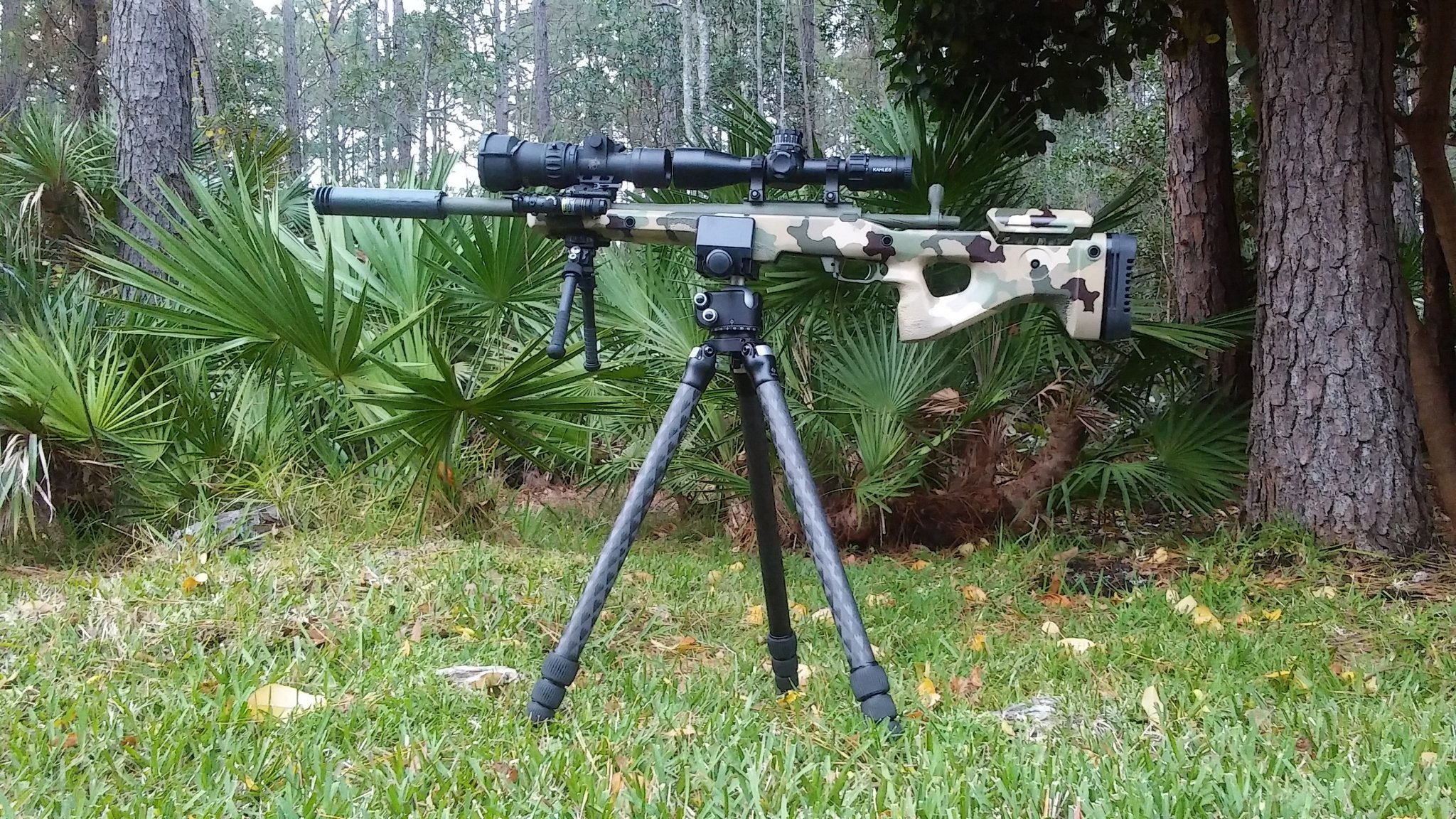

First time post in this forum: My professional level of training to date is somewhere between zero an a mouth breather. I'm probably setting my self up for a good thrashing but here goes. So my build is complete and its off to the range I go. I'm 32 feet above sea level in Waycross GA (the swamp) Weather forecast calls for temps around 30 degrees, humidity levels will be somewhere around 50%. This is a night time hunting application. My zero will be 100m. Anticipated max shooting distance 400m. My question: if I zero at theses conditions will I see a difference during the same (or higher) humidity levels (100%) during the summer months where my temps can be around 90 degrees?
I'm a firm believer that the learning process never stops.
Cal 308 win
18" MTU barrel
Factory Hornady 178 ELD-X

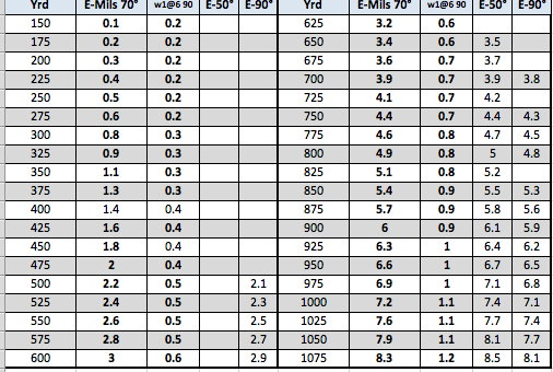

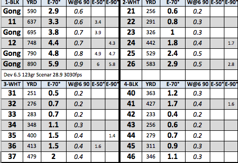

But if he is asking for his downrange dope sure he'll get a tiny at 400. but as Skookum mentioned it is more academic unless your going very slow with you heavy 308 in that short barrel - at 2400 you'll get .1mil if you average, but it is actually a bit less.
As know examples:
My load goes from a 1.43 @ 30° to a 1.39 @ 90° - so either way , I dial 1.4 @ 400
This weekends match was 45° at the start finished around 55°. This weekend I just stayed in the 70° column and it still facilitated the top spot. I've use the same dope card in the summer at 100° as I do in the winter, like Sunday and colder, with many top spot results.. The dope is really solid.

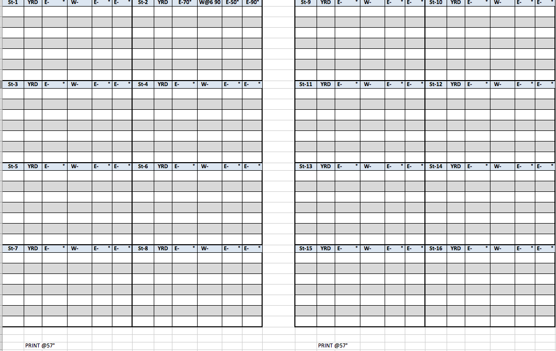

Below is an example of my stage cards that I pre-print in the match booklet is sent out before the match and the card I use if not. The interesting thing is once you only worry about the smallest scope adjustments you can make you'll note that the rounds are relatively temp stable out to 1K. Now this isn't so true at the Alaska type lows or and sandbox highs. You might find it interesting to look at my 70° and the the 50° & 90° columns.
All that said, if I know the match is in, let say Wyoming, I'll set the inHg for the expected location as well shift the expected main temp column, but I will still create the 40° brackets.
edited to add: Man this was hard to post with Siri - the examples below have include -AJ at full value 90° wind that round up my numbers a bit
pre-printed stage example
Normal dope sheet - used for UKD match etc
Blank stage when I do not have a mach booklet, but have time to write stage dope
As know examples:
Below is an example of my stage cards that I pre-print in the match booklet is sent out before the match and the card I use if not. The interesting thing is once you only worry about the smallest scope adjustments you can make you'll note that the rounds are relatively temp stable out to 1K. Now this isn't so true at the Alaska type lows or and box highs. You might find it interesting to look at my 70° and the the 50° & 90° columns.
All that said, if I know the match is in Wyoming I'll set the inHg for the expected location as well shift the expected main temp column, but I will still create the 40° brackets.
edited to add: Man this was hard to post with Siri - the examples below have about include -AJ at full value wind that round up my numbers a bit
