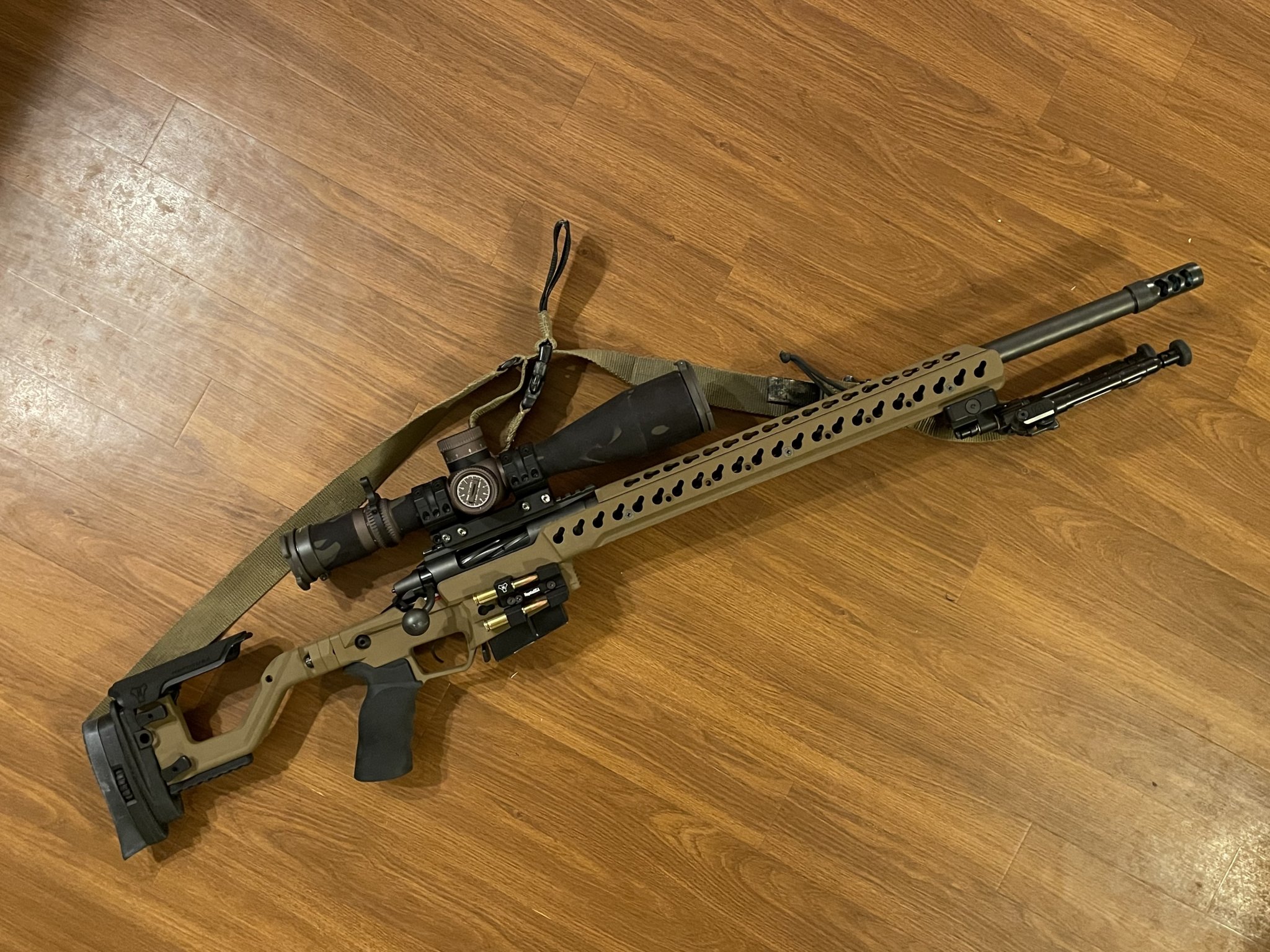

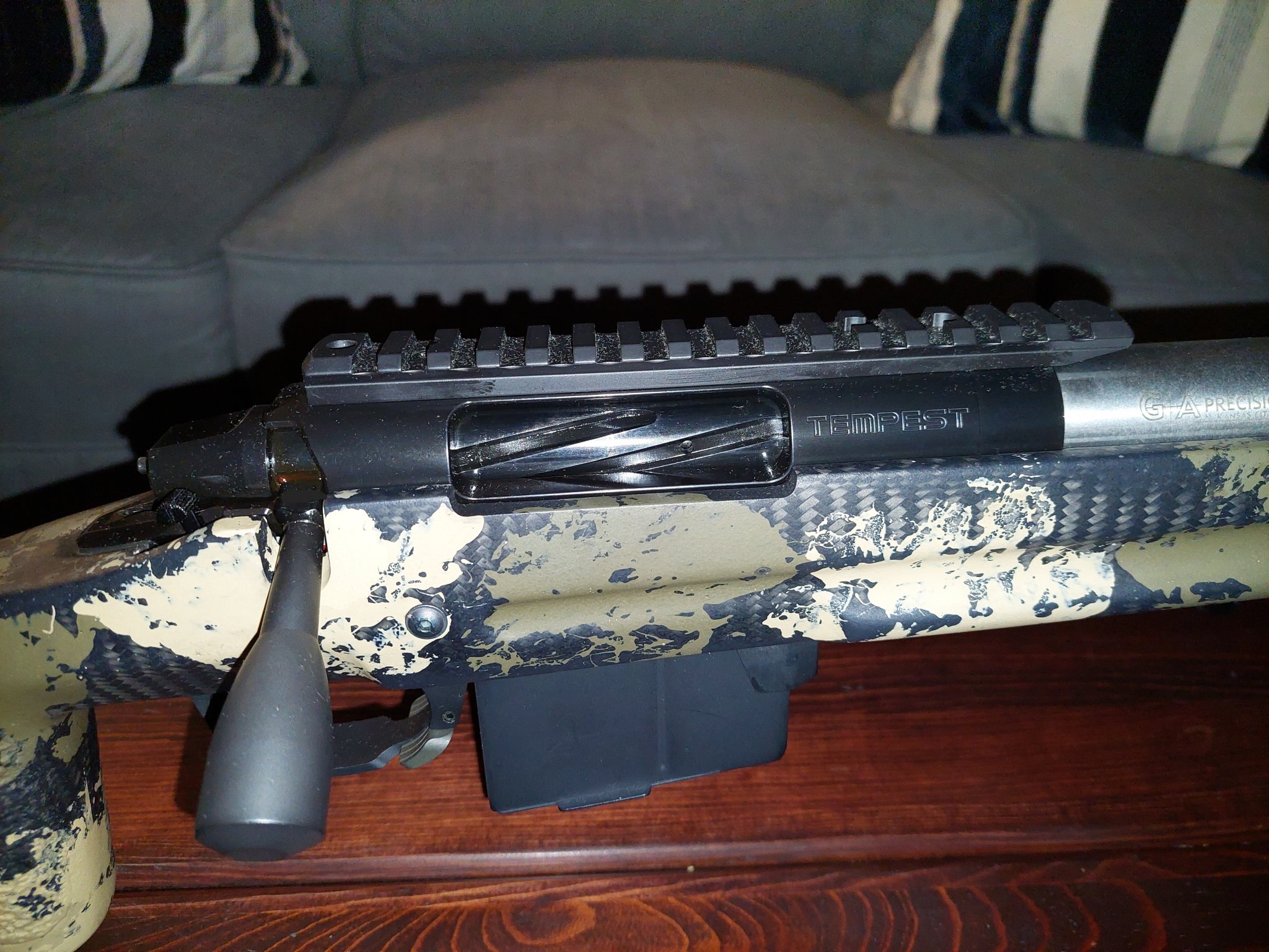

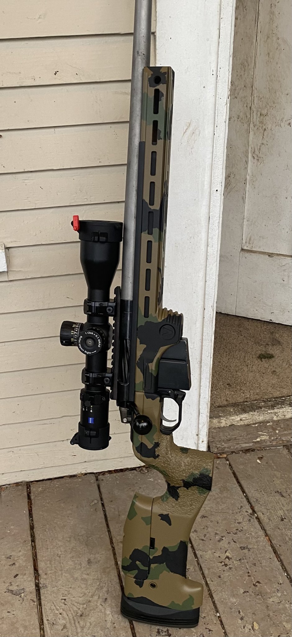

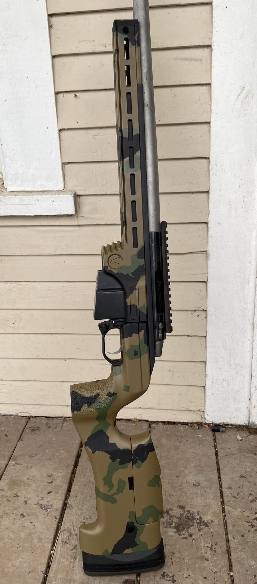

Surprised but i can’t tell that it’s interfering anywhere seemed to drop in just fine. I think the height of the mag latch might need to be adjusted. With like 5 rounds loaded the rails of the chassis push down on the first round cussing the tempest to slide over. 10ths loaded there are no issues though
How are you liking the Tempest in the rem 700 ATX chassis? Are you gonna add the bridge and weight system to it?
I don’t think I’ll add weights to it. I love it though first time I’ve actually really enjoyed a chassis. I will be adding the bridge.

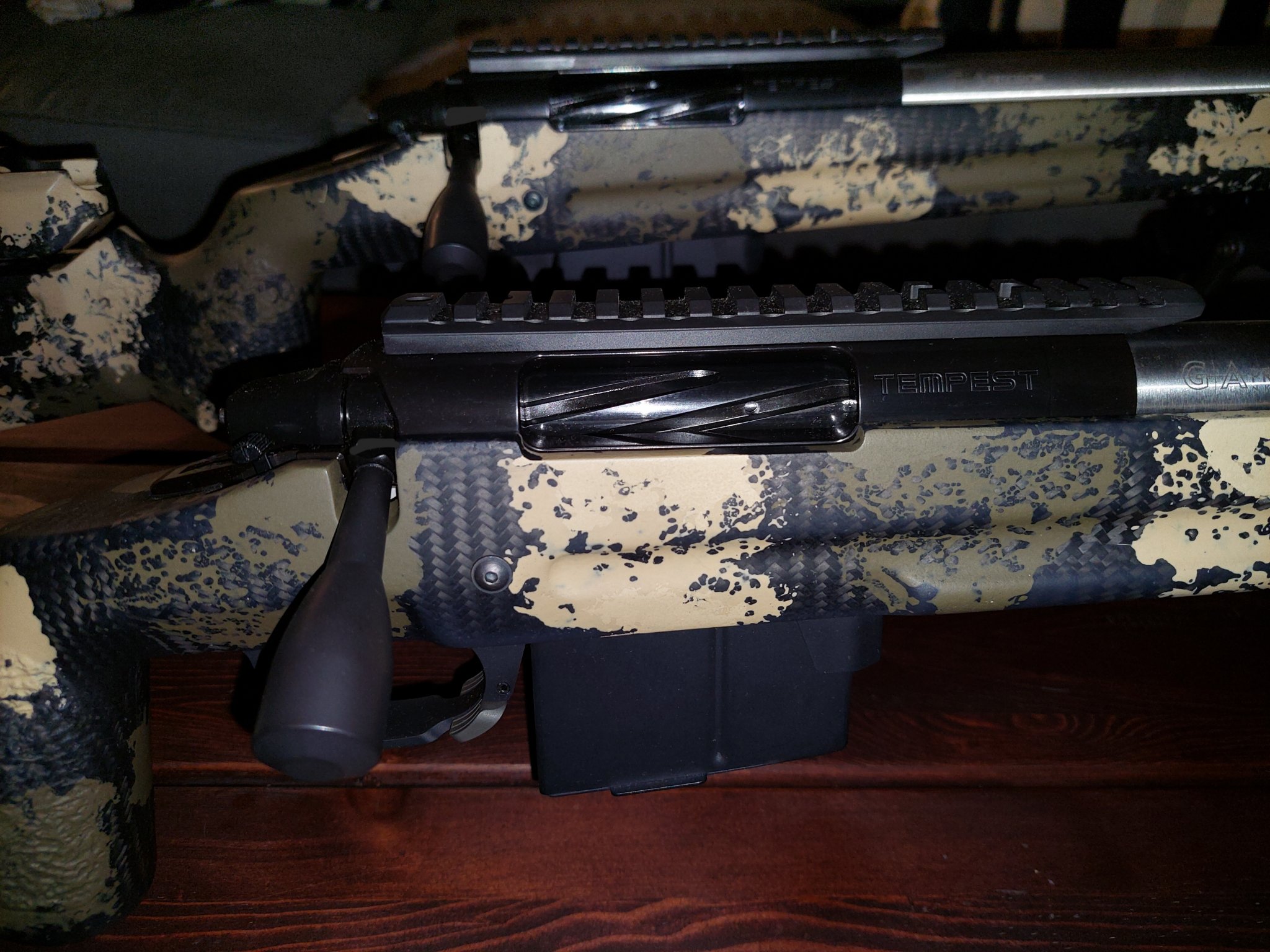

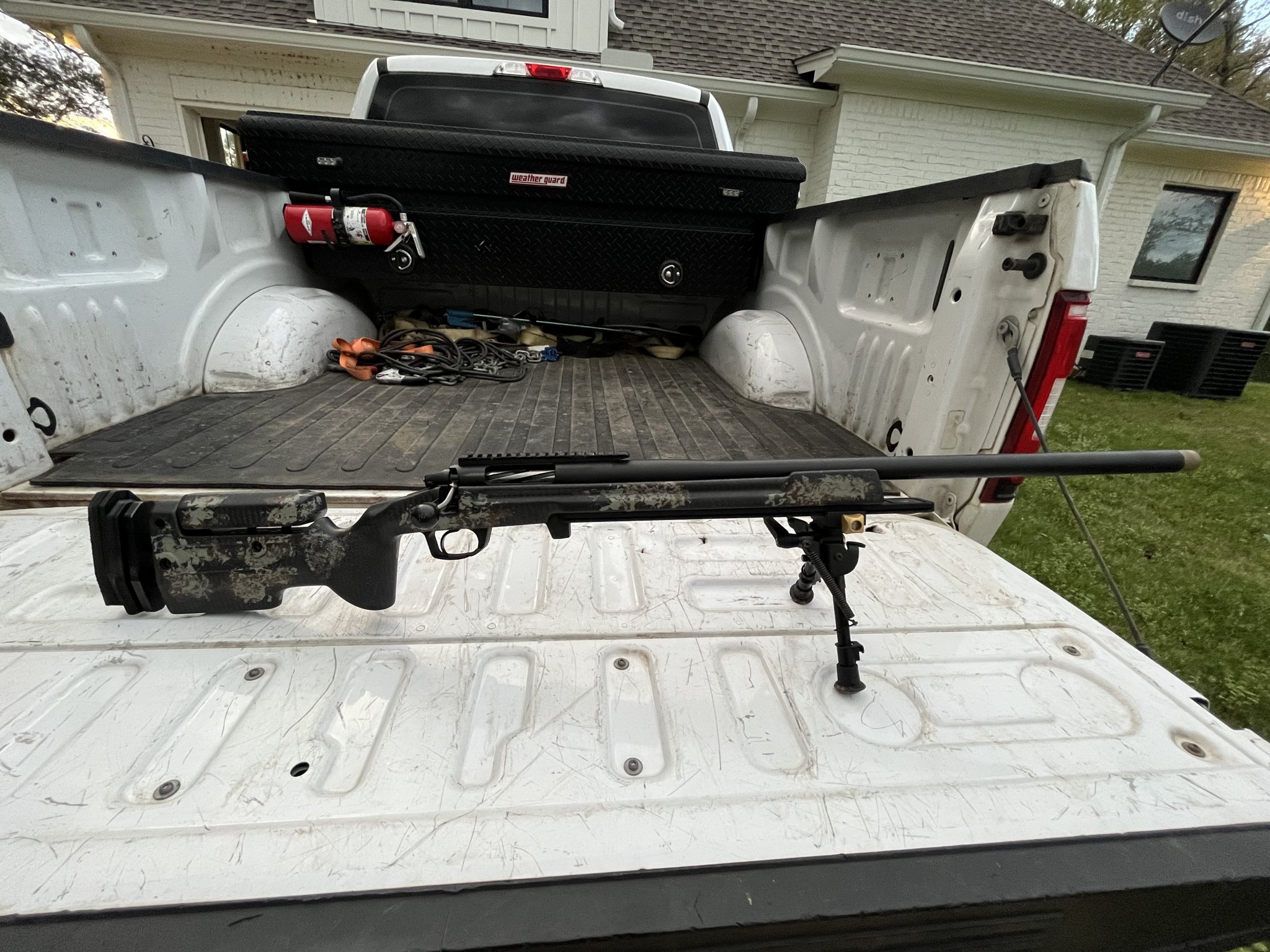

Reviving this thread. Got my Tempest in yesterday. UPS broke the trigger but I had a spare TT diamond. Used the .30 hanger. Bolt lift seems heavy and I had 3 fail to ignite BR4s. Good hit on the primers. Factory ammo I shot had no issues. For a TT diamond, what is everybody else using for the hanger? Thanks!

Go back in this thread and check for the pin protrusion range. Possible your firing pin may need to be adjusted if you’re already using a 30 hanger.
Edit: Hopefully the measurement wasn’t on Scout. I don’t recall what it’s supposed to be anymore, but a call/email to GAP should fix that.
Re-edit. Found it
Holy shit. It doesn’t seem possible I built this rifle 7 years ago.
Thanks @FatBoy. I'll check on that.
Correcting pin protrusion fixed mine. The culprit was my gunsmith was not familiar with these actions (they were new, mine was un-coated) and when he coated it, the pin was loose after reassembly.
FWIW, I sent mine into GAP and asked them to check the entire bolt and Firing pin assembly over. I also requested a heavier firing pin spring, which they installed . The spring change was not necessary, but I don’t require super fast cycling with two fingers so for me there is no downside. At least for how I use the rifle now.
@FatBoy I called and talked with GAP yesterday. I made some adjustments like they told me, didnt know there is a dimple in the fire pin that is held in by a set screw. Dissembled my bolt and firing pin assembly. That dimple on mine is very galled up. I may just get a new firing pin as this one has some life on it.

Was it out of adjustment ?
I was looking at 0.172-0.175" of pin protrusion. I think the pin was one or two rotations out but not sure. They told me to look down in and see the dimple. My eye site is very good and I couldn't even see it. I gave it a good cleaning, made a small mark on the retainer for the spring on where the dimple was. But the firing pin will move a little because that detent is so galled up. Hope to shoot some today to confirm if it's fixed it now.

The earlier versions there were reports of the tempest having a problem lighting off cci primers. I had a early gen 1 and a gen 2 tempest and ran cci exclusively without a single FTF. If you are still getting ftfs with that protrusion (you can go more but it will have stiffer bolt lift) id look at maybe your firing pin protrusion in the bolt face. If I recall there is a double grub screw if you look into the bottom of the bolt shroud which should let you adjust that. You don't want to adjust to much or you'll get pierced primers.

FP protrusion isn't anything magical since it has to be standard across the board here. 0.055" is they average but it could go as low as .040 and as high as .065. Since the rifle is so "old" you may need a new FP spring if both protrusions check out fine. You could call up GAP and have them send you one.

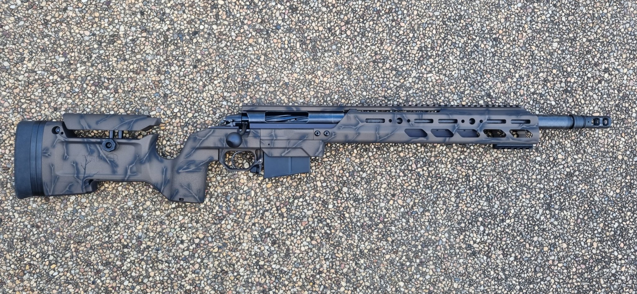

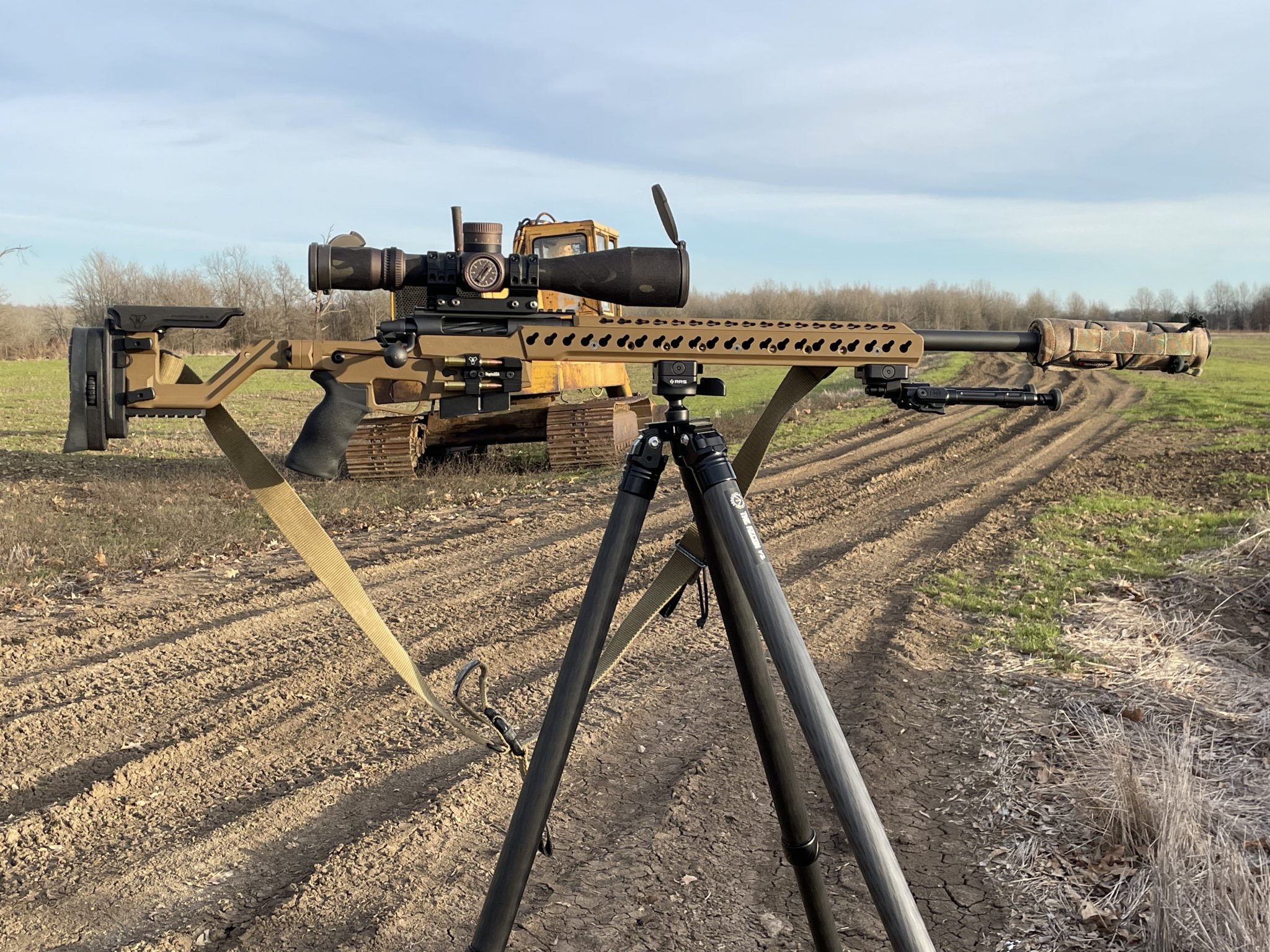

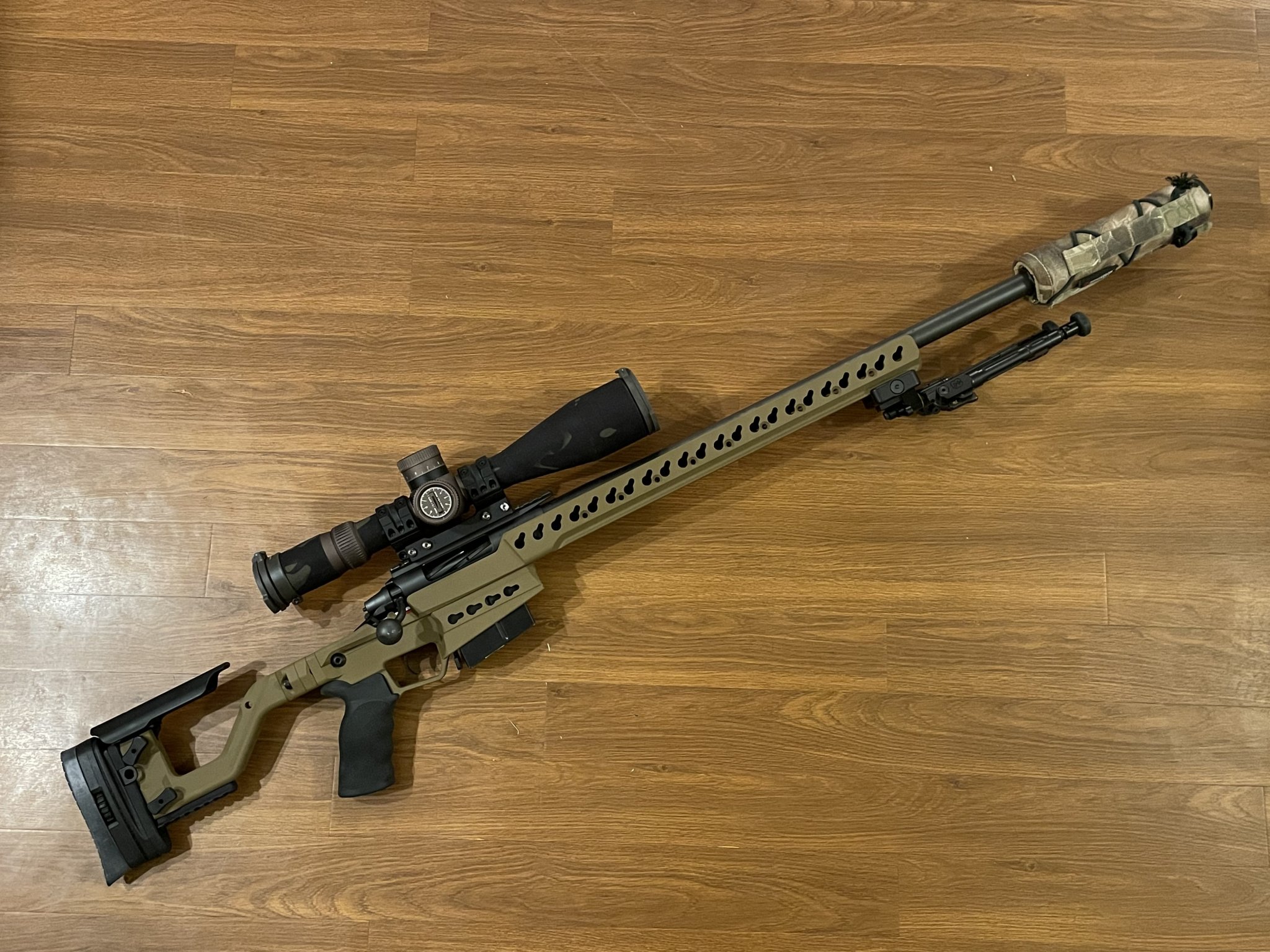

My Tempest kind of looks like a TRG now 😂
That is the best looking rifle I seen yet! My TRG was the most comfortable rifle I owned however; I hated the magazines, so I sold it.
What is the parts list for this?
-You started with a KRG Bravo for a 700? Then found a TRG rear end and added a vision forend?
- Vision forend works with AW magazine?
-Any modifications required?
-Any leads on a TRG rear end?
-Does the forend have a slot to accept a TRG bipod?
Much appreciated!
Reactions: Alpinebeard

Started with a KRG Bravo which I used for many years. I carved a wood stock/chassis for my Sako TRG so I had a TRG stock sitting around. I modified it to work with the KRG. Put a Vision forend on it. It does not have a slot for the TRG bipod (wish it did). The vision does work with AW mags though I haven’t run it a lot yet…
I agree the TRG has better ergonomics than most stocks and chassis. To beat it by much you have to carve your own!
