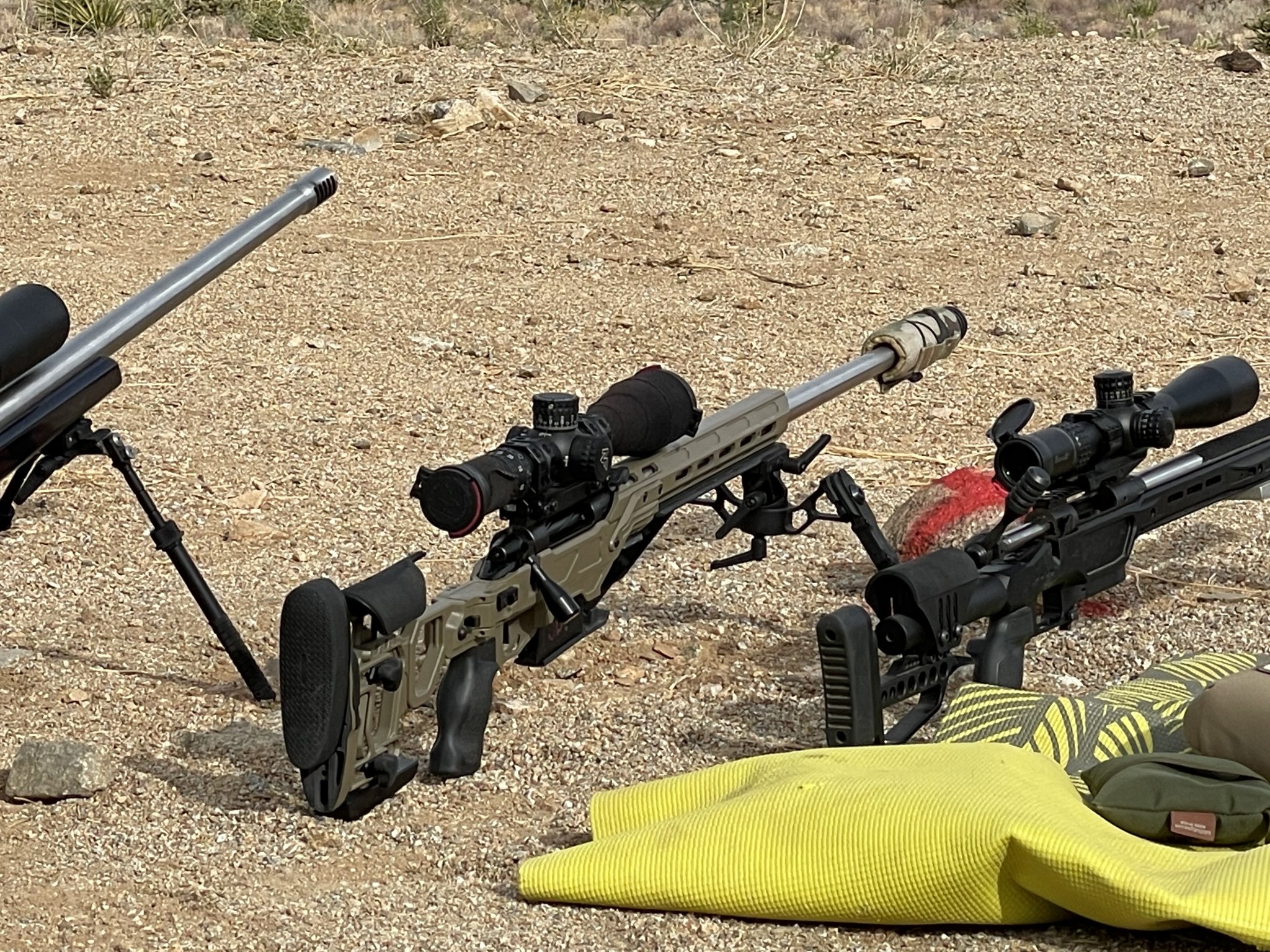

I can confirm MDT 3.850 CIP mags feed 300 NM in my Kratos. Action is mounted in a Cadex long action Lite Competition chassis with a CIP magazine sleeve installed.
Nice!
Same chassis I have for my TL3 LA. I’m thinking about throwing a Kratos in this chassis and using my TL3 LA in a hunting build.
