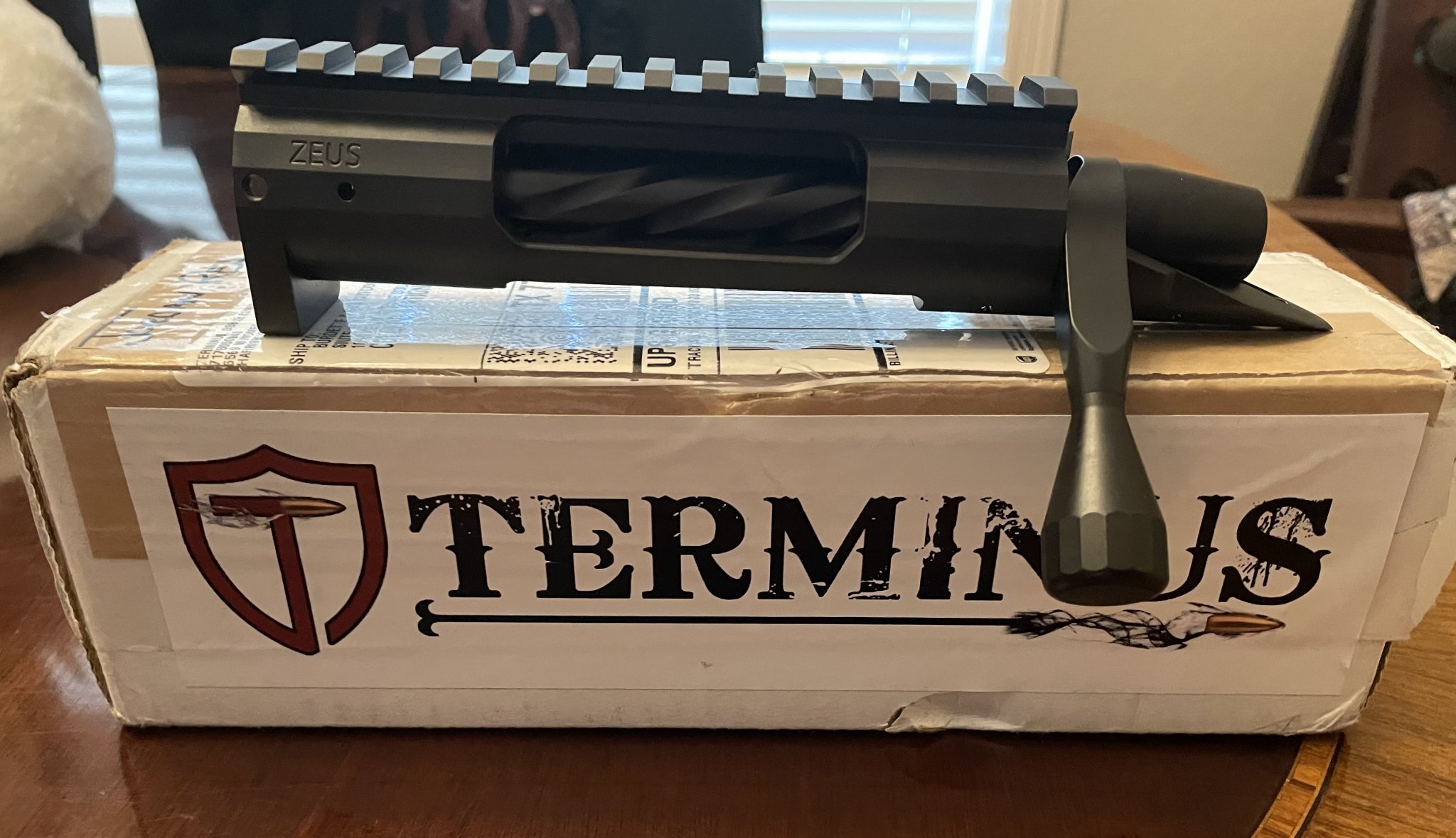

I went terminus because the barrels were easier to find and I’ve been happy
ETA: some are saying Zeus QC barrels are interchangeable with Curtis. I went long action
Action should be here tomorrow barrel arrived today and is a tank lol proof comp contour 😂 I went with valor because I got a good deal on one in the px brand new but I don’t think you could go wrong with eather one I know that there was another brand new valor in px so you wouldn’t have to wait

Picked it up this week
Following up to my previous comment, I’ve also got my hands on a zeus qc to run along with my valor qc. As expected, the zeus just feels nicer and smoother, same as my apollo. I couldn’t be happier.
I shot a match this past weekend with the valor where my bolt stop decided to fail on the 3rd stage and my bolt started randomly leaving my action while cycling. That made for a fun day. I had the same issue with my axiom back in 2020. These continued issues with curtis actions are getting frustrating, especially when they’re known and are still not resolved. Hopefully this bolt doesn’t also wear down like the last one did.
Cool thing is I can move all my barrels between the actions at will. Once I get the Zeus bedded into its new chassis, it’ll certainly be my primary rig.
