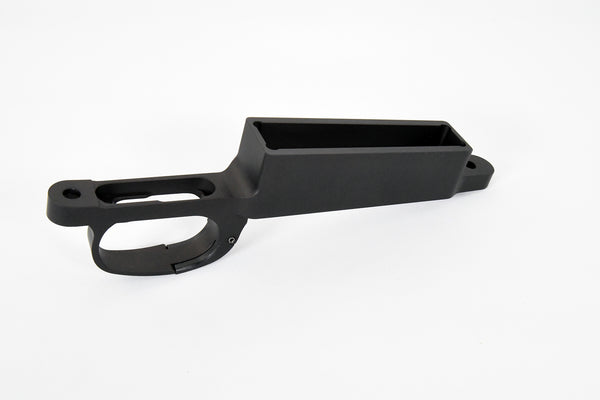

Would these mags work with Hawkins precision bottom metal or would I be better off getting the accurate mag bottom metal? That's awesome that they make long 308 mags that fit long action! I appreciate all the information.
I cannot speak to Accurate bottom metal but Hawkins Precision has a good video on the topic:
and....
As you have not stated what chassis/stock set-up you are going with, you would be wise to call Hawkins Precision up and tell them exactly what mag you want to use and they will make a recommendation based on your given information. American Precision Arms also makes and a call to them might help:
I run this PTG bottom metal with the 5-round 3.850" CIP AI mags with no issues:
This bottom metal below is for the 5 or 10-round 3.715" 300WM AI mags from MileHigh or EuroOptic I listed in the previous post:
Others here on the forum scoff at the length of the long single stack 10-round AI mag. Pay CLOSE attention to mag lengths/widths/sizes as AI has like three different sizes of mags for the SAME cartridge depending on SAAMI or CIP standards (got burned on this point and then got wise real fast once a few hundred got spent on mags I could not return [were gifts] or use).
