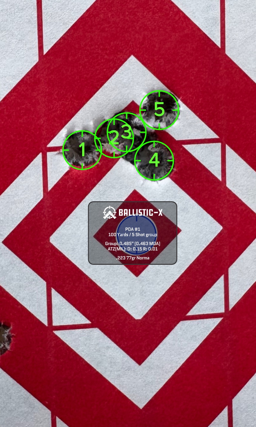

Recently bought a rifle with terminus .223 setup. Picked up a plastic MDT mag and have ran 180 rounds through it (Norma box 77gr) and it runs like a champ. Haven’t had a single feeding issue. The Proof pre-fit is a hammer as well.
This is the only time I shot for groups with it.
  • image_cropper_CE9E5605-9BE6-495A-98B7-E59C706E4A0F-23381-00000C6159D82050.jpeg
