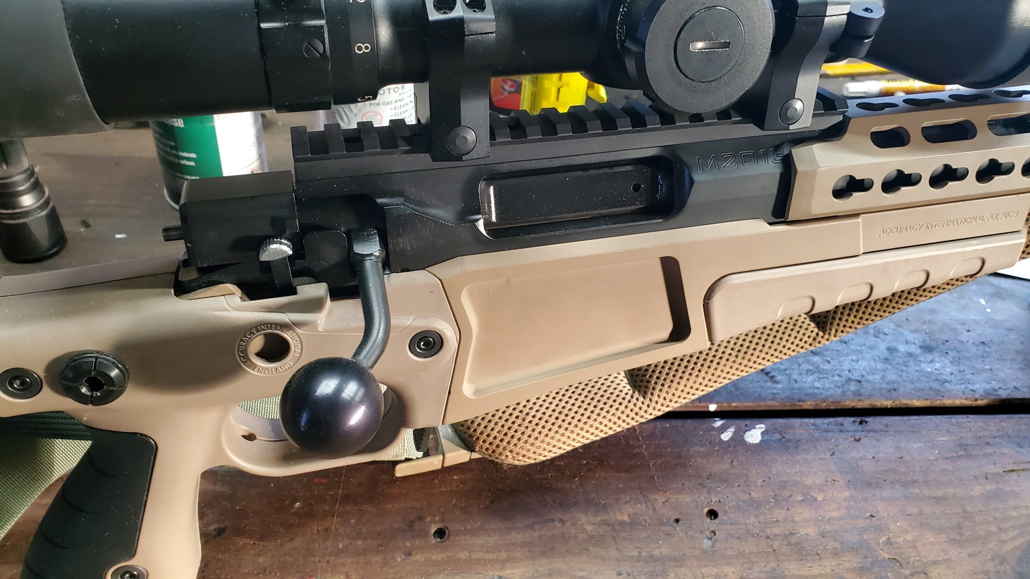

    I just did a Deadline build in 6 x 47L. I'm very happy with the Action. I have it in a donor/temp stock (T2A), waiting on my new T2A from Manners. The mag latch will need to be fitted on the new stock, something I'm not going to do to the donor. I will be running AICS mags, but haven't crossed that whole bridge just yet.
    I've even thought about a threaded shank, one end deadline thread and other 5/16-24. Screw in on, find proper index, and heat and bend threaded part to mimic sweep, then add a glade armory rd ball knob.

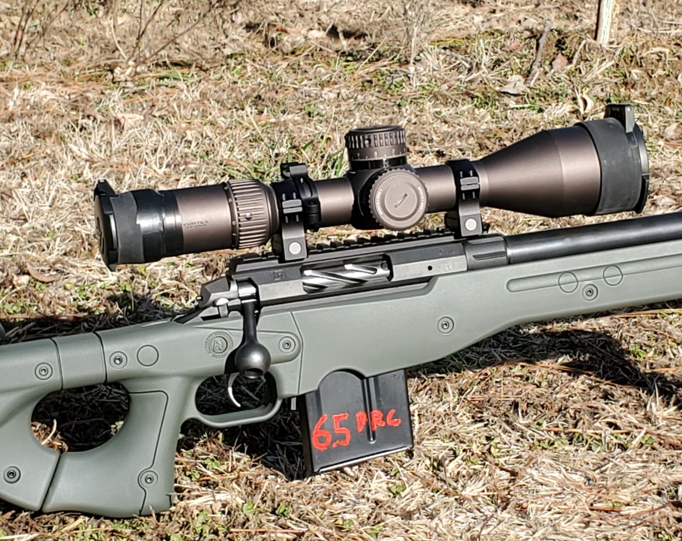

    I just used my Zeus at the best in Texas match a few weeks ago and didn’t have a single mag issue the entire match. I used an aics mag and I also used an arc mag with 2 round extension. There were a lot of 12 round stages. That match was mostly shooting off props so I’m sure at some point I had some pressure on the mag. I would prefer a Zeus due to the integral lug and rail. I also got mine with full threads and no quick change.
