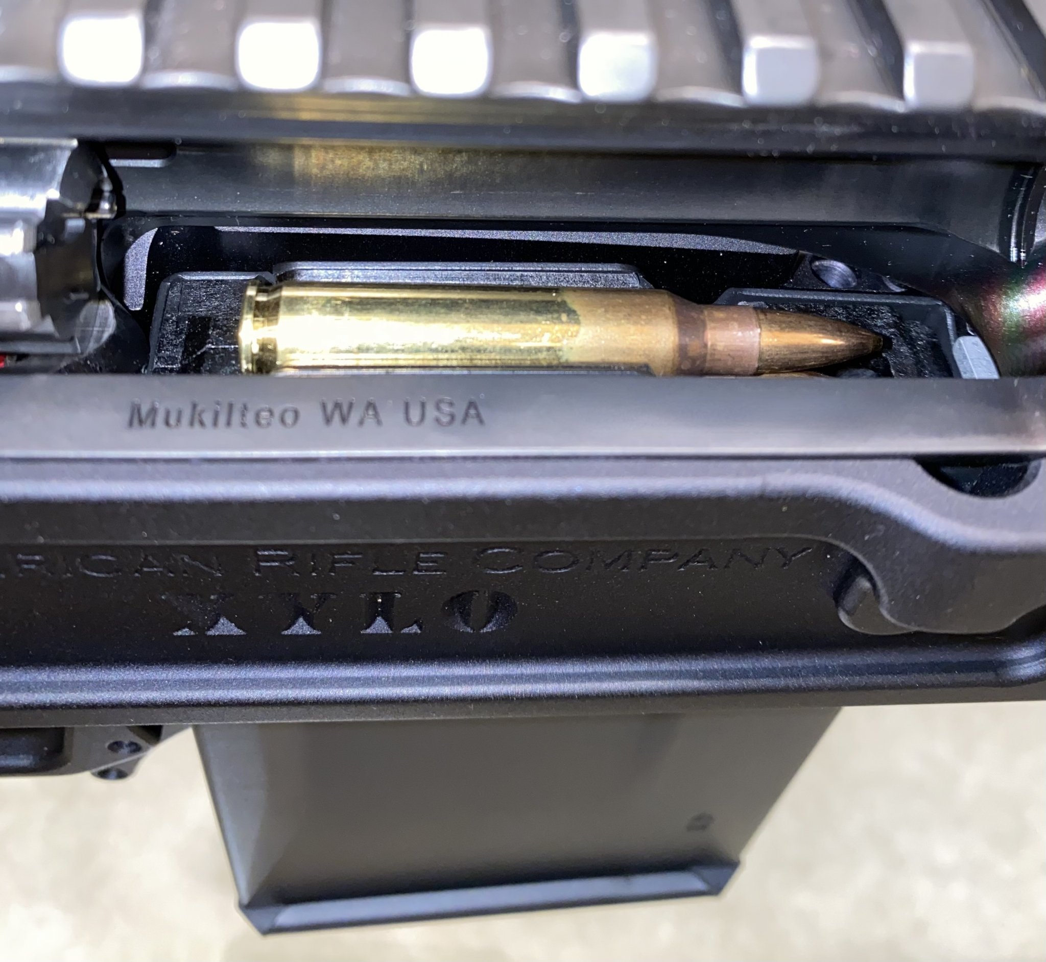

Does CRF really gain anything in practical reliability though if it's still within the R700 pattern custom footprint? Unless he's going to be hunting cape buffalo with the 6 Dasher I'm not sure CRF is any benefit.
It was just the same joke I’ve always made.
But yes, I would expect a control round feed to work better for the shorter dasher case than pushed.
But really it’s spring ejection in combination with the extractor that can allow the shorter case to rotate prematurely and release inside the action where as manual ejection won’t rotate the case out from under the extractor until the end of the bolt travel.

The only current aftermarket action that I'm aware of that's actually designed for use specifically with AW mags in mind is the ARC CDG, though I'm a bit ignorant as to the lug positions. The GAP Tempest actions were also designed for use with AW mags, though that action never really caught on. And I believe the Badger M2013 as well.
Other actions are designed to be compatible with AW mags, but there's a huge difference between something being made compatible and something being made optimal for use with a specific mag pattern.
I wish the Zeus had a 6 o’clock-ish bolt lug for better AW shenanigans. I don’t think it does. Don’t have a Zeus, but I’ve read it’s not ideal for easy AW mag use. Def correct me if I’m dead wrong.
Of course the Impact doesn’t have such a lug there either…
Works just fine with AW. It’s the same if you ran an impact with AW’s. Mess with the mag catch and feed lips a little bit. It’s not a CDG. But it works just fine and I wouldn’t say it’s not ideal.
For general knowledge, the CDG thread usually just mentions a 6 o’clock lug position but to illustrate here’s a pic I scraped from this post in that thread. Couldn’t find a better pic in the time I had to search.
If anyone has a better CDG one (like the Solus lug pic linked above), set it free!
