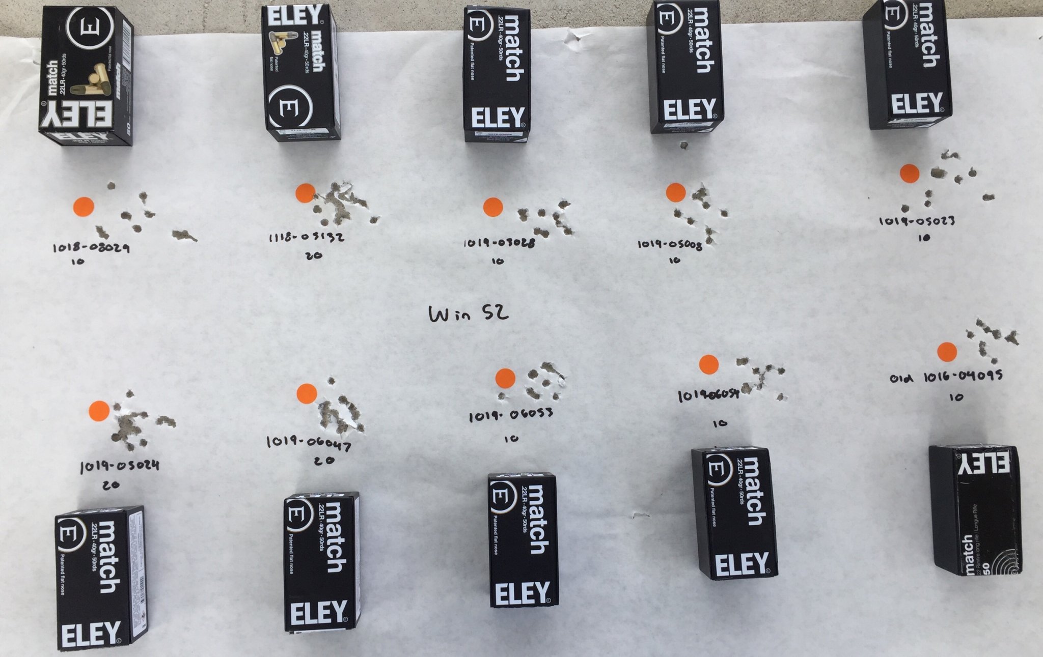

I tried about twenty different boxes of ammo, some were same company with different lot numbers and was amazed at the differences. Like finding the node with our centerfire rifles. I found Eley lot number 3116-30323 shot absolutely the best. Went to their page and found it was made a few years ago and only 200,000 were made. So the chances of finding more are slim.

With Goodshooting I just order 50 or 100 rounds of a few lot #s and go from there. They seem to have the best 'normal' pricing on Center X. Shipped. If you find better, let us know. :geek:

I order a box from different lots that killough has plenty of stock left for, shoot 10 rounds of each at 100, see what shoots best and then shoot 10 more of those for a sample of 20. Pick the winner and order a couple thousand of it.
