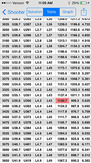

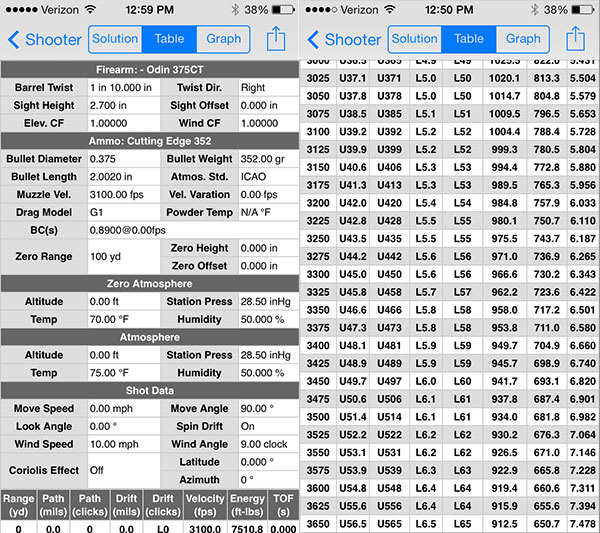

Some numbers from my 375CT at that distance. That's a lot of mils. If I dialed the scope down to where I could actually have enough holds in my reticle, with my turret maxed out, it is very unlikely I would still be able to see a 1moa sized target.

And thats why I'm questioning it. Says he used a 5-20x Razor Gen 1 scope to make those hits.
Whittington is between 6,300 and 8100 feet in elevation. Does that make a big change in numbers, including terminal velocity?

I hope that wasn't aimed at me. My post was simply to demonstrate just how far away it is, even with 375CT. As I said, I don't even have the equipment to attempt it. Another 40moa under my current 40moa mount, would get me started. As CoryT mentioned however, I don't find it at all practical, so I won't be changing my rifle setup to try. That's why I posted that firing solution... as most people don't even realize just how much elevation you need to make the trip.
It's quite certainly possible, and I have no reason to not believe it happened, but it is quite obviously not practical. Not as most of us see practical anyway. If I don't have a reasonable expectation of a first round hit, then I don't see it as practical. Even 2000yds is tough with 375CT most days in South Dakota. It blows hard here, almost every day.
I still would like a normal or avg station pressure from Raton though, out of my own curiosity. I'd like to see just how much easier my kit would push the distance up high like that.

Can someone give me a normal station pressure for raton? I can run those numbers quick.

They are at 8100 feet, so the Station Pressure is about 22.15
Update: The range varies in elevation from 6500 to 8100 feet, so Station Pressure will vary, but 22.15 should get you in the ballpark.

Thanks for the pressure Abq-Defense. Changing the station pressure to 22.15 changes things drastically, as I expected. As you can see, the velocity at 3650 bumps up right close to 1100fps. Makes me wish I lived somewhere higher! lol

I just took some numbers from my .375CT and with my MV of 3173 with the 352gr MTAC's and a generous summertime DA of 9000' (here in S.E. Idaho) I am getting a velocity of 1001.1FPS at 3650 yards. I drop sub-sonic at 2950. I think the number from the OP are a little off but I dont think its outside the realm of possibility.

I think what soured up this thread was the 1100 fps at 3650 yards being questionable.
