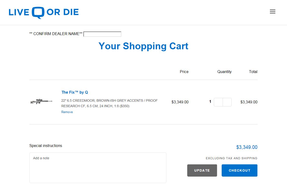

How much is the Fix by Q? Sounds like all that is already done in a factory package.
The Fix by Q is about $3,349 base, meaning NO optics, rings, bipods, etc. Granted you get a proof carbon fiber barrel, That's roughly only $588.93 +/- cheaper than this build. Now you have a rifle and chassis, but still need to go glass, ring and bipod shopping with that $588.93 budget.
