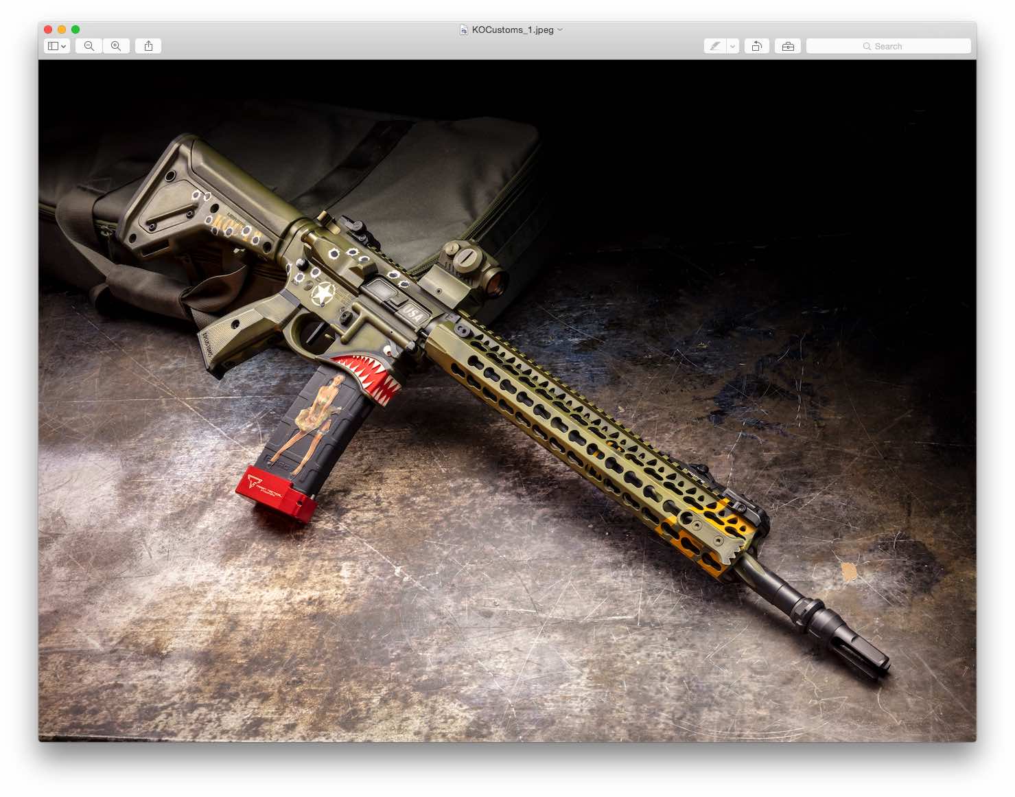

What's the Cerakote color on #3 there?

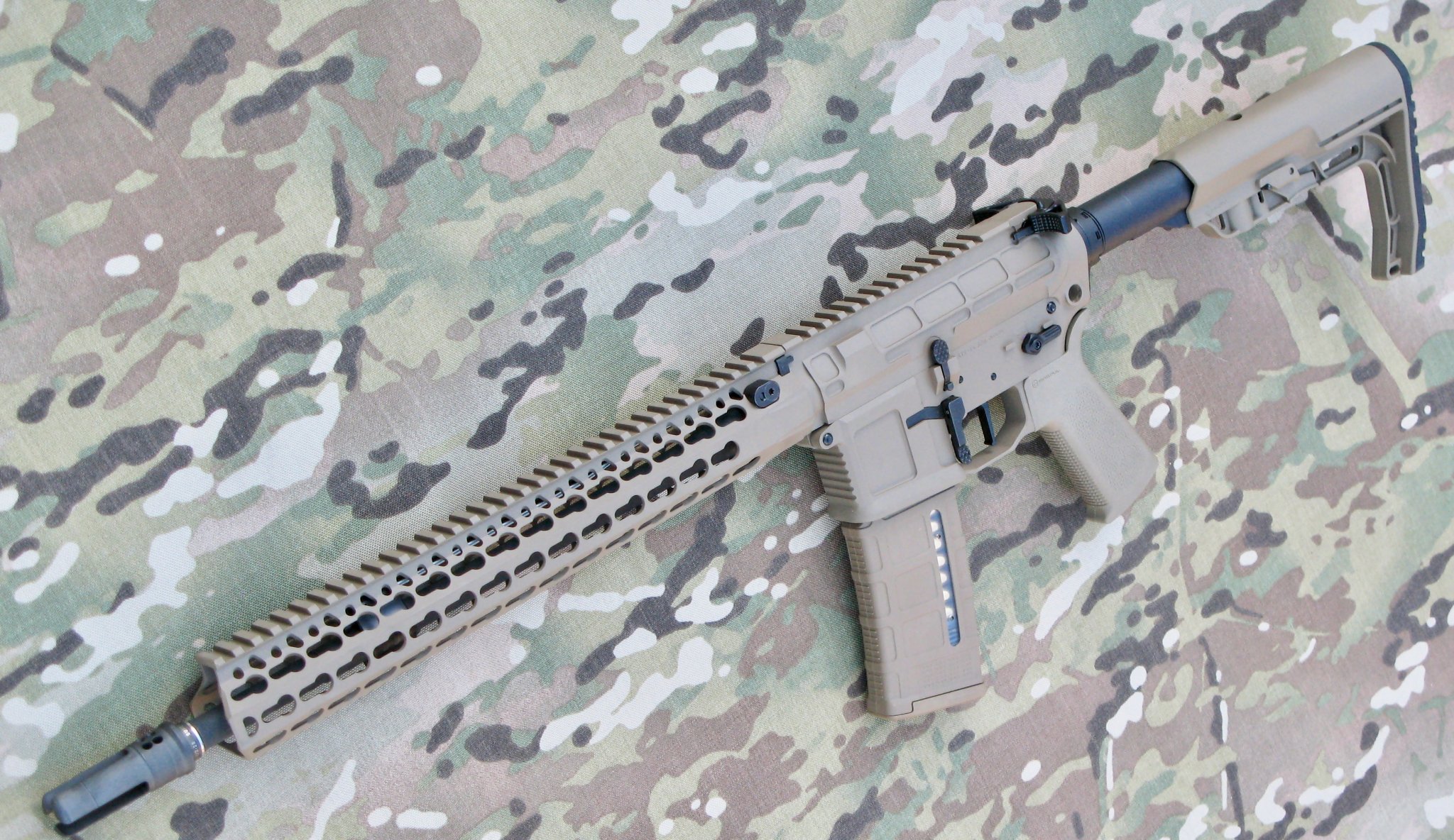

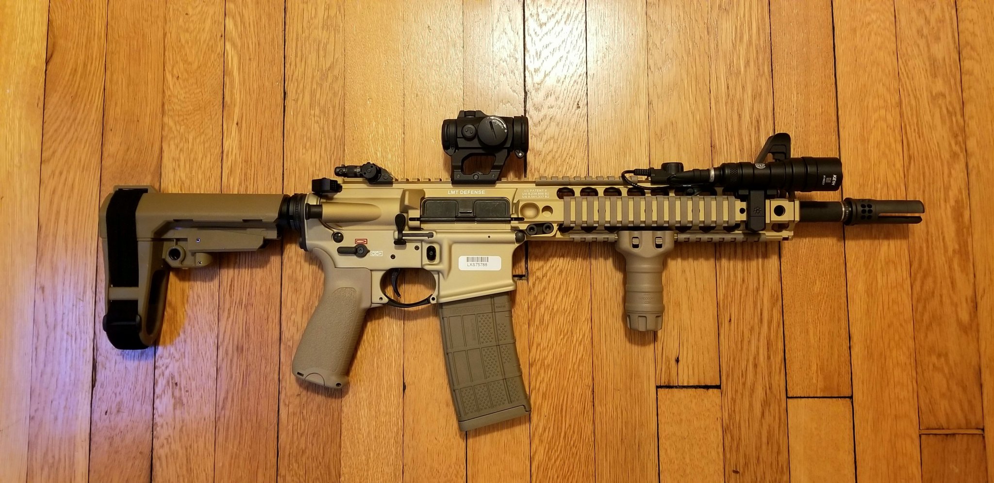

Finally got my LMT build together. I wanted a 11.5" CQB rifle... but they were always out of stock and not FDE. So I built one. I found the upper and MARS-L lower and filled it out with LMT parts along with a Geiselle SSA and ACH. I'm very happy with how it turned outView attachment 7326704
Thanks! When I first saw it I really digged the look, glad I had the 6 month patience for the shipment hahaThat tannodized MRP is boner inspiring.

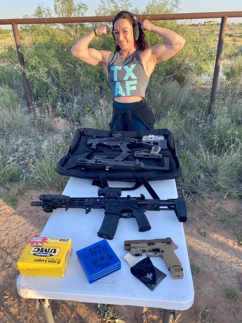

"DAM" mamma got some "GUNS" .......Few of mamas toys, out plinking last night.
HK SP5K
HK VP9SK
B&T GHM9

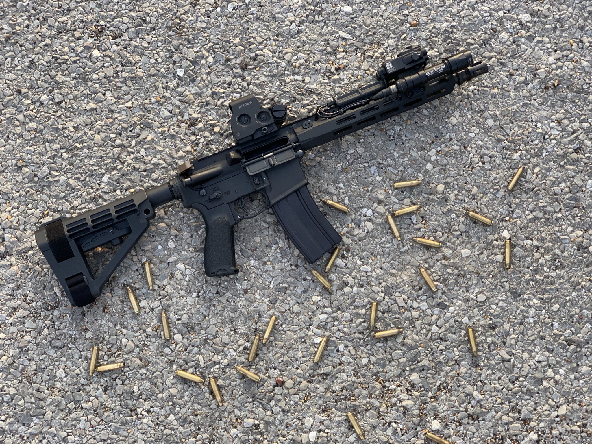

AR pistol build
Sig P320View attachment 7322646

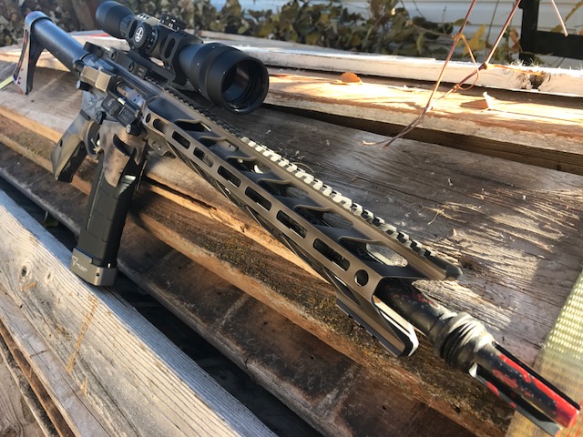

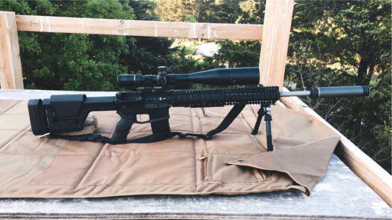

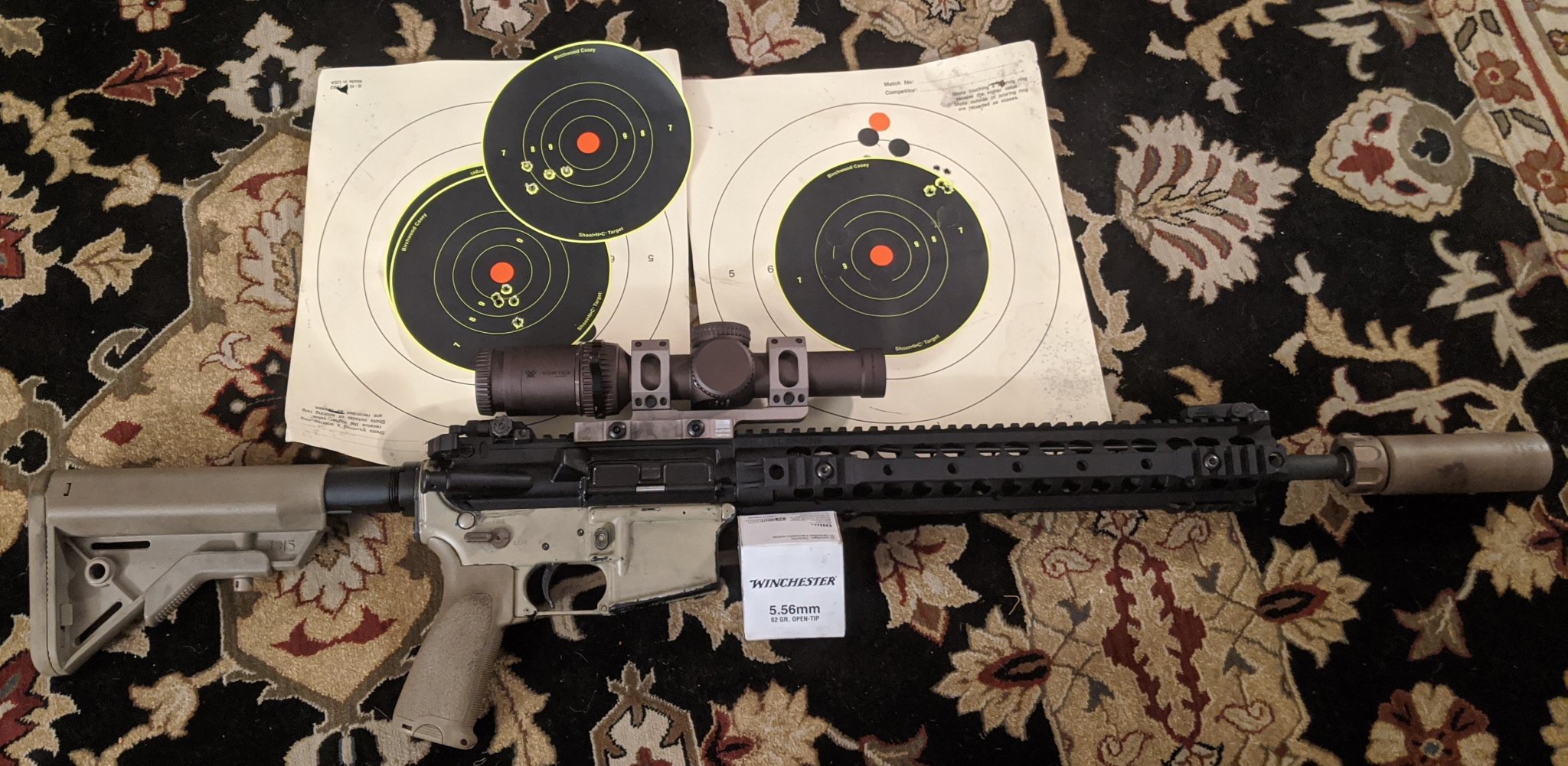

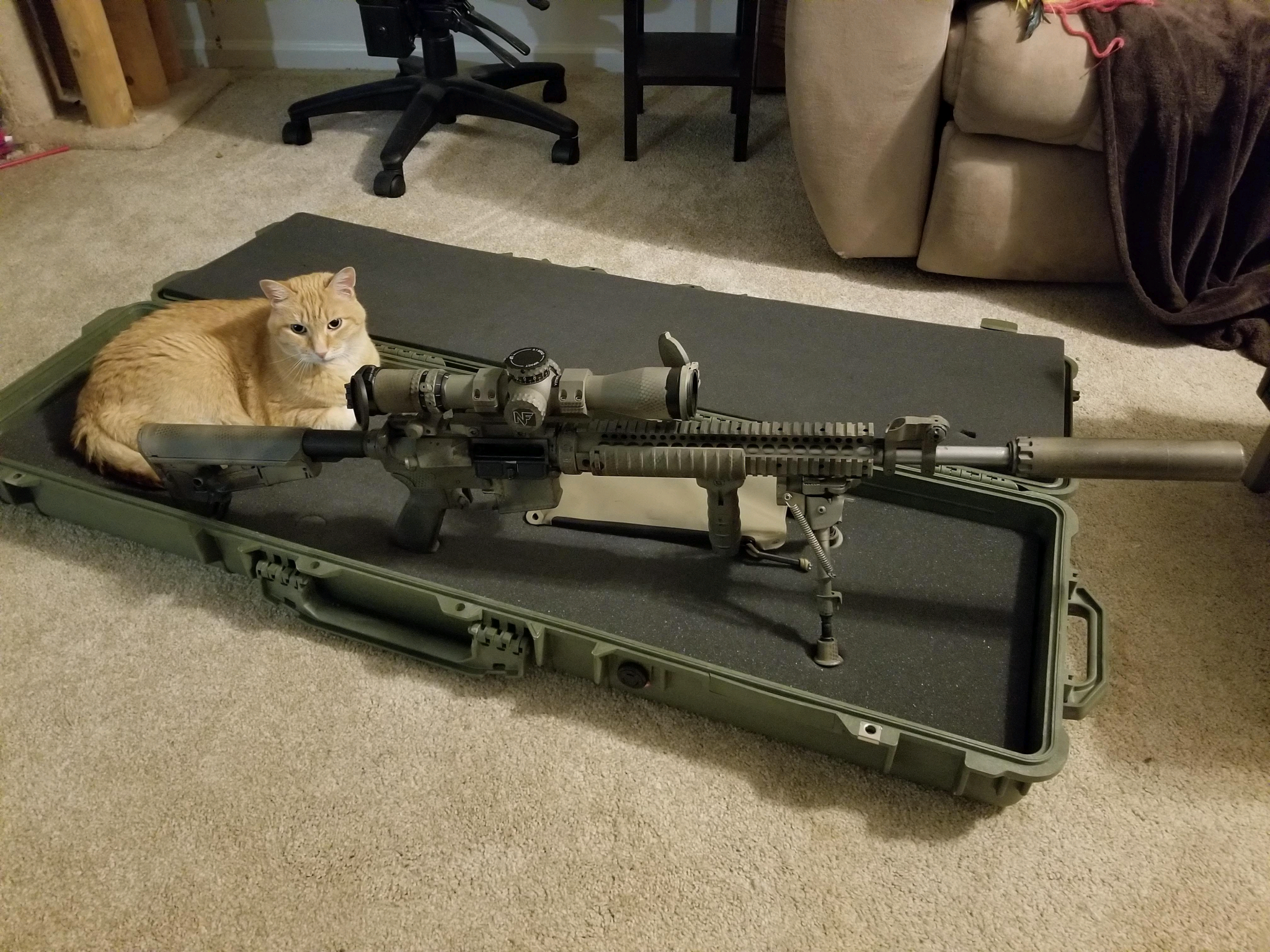

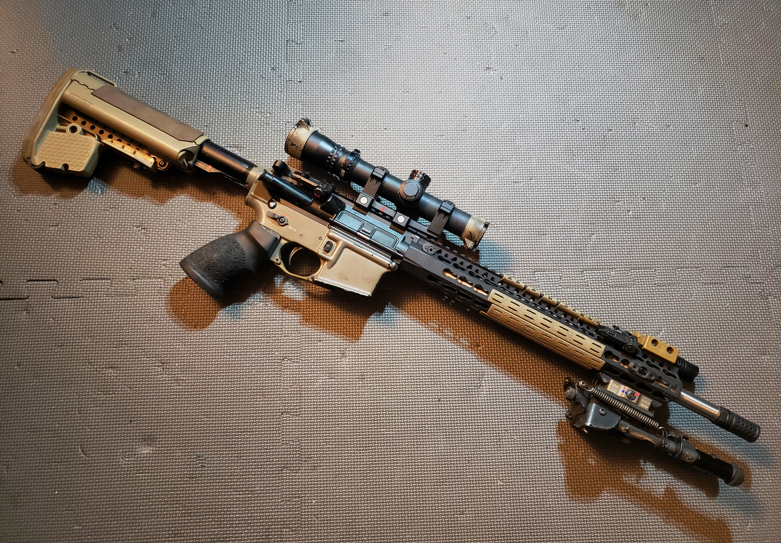

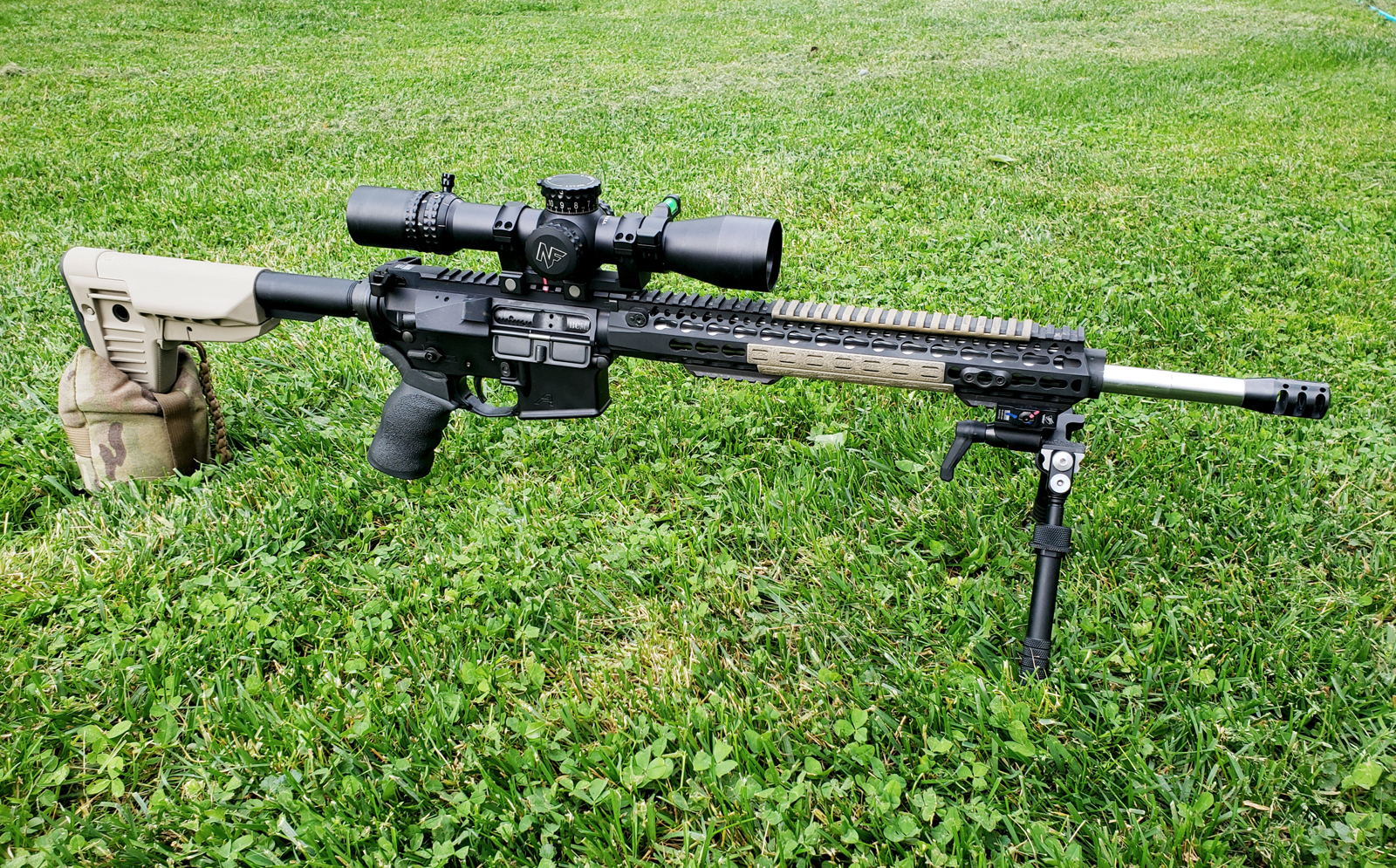

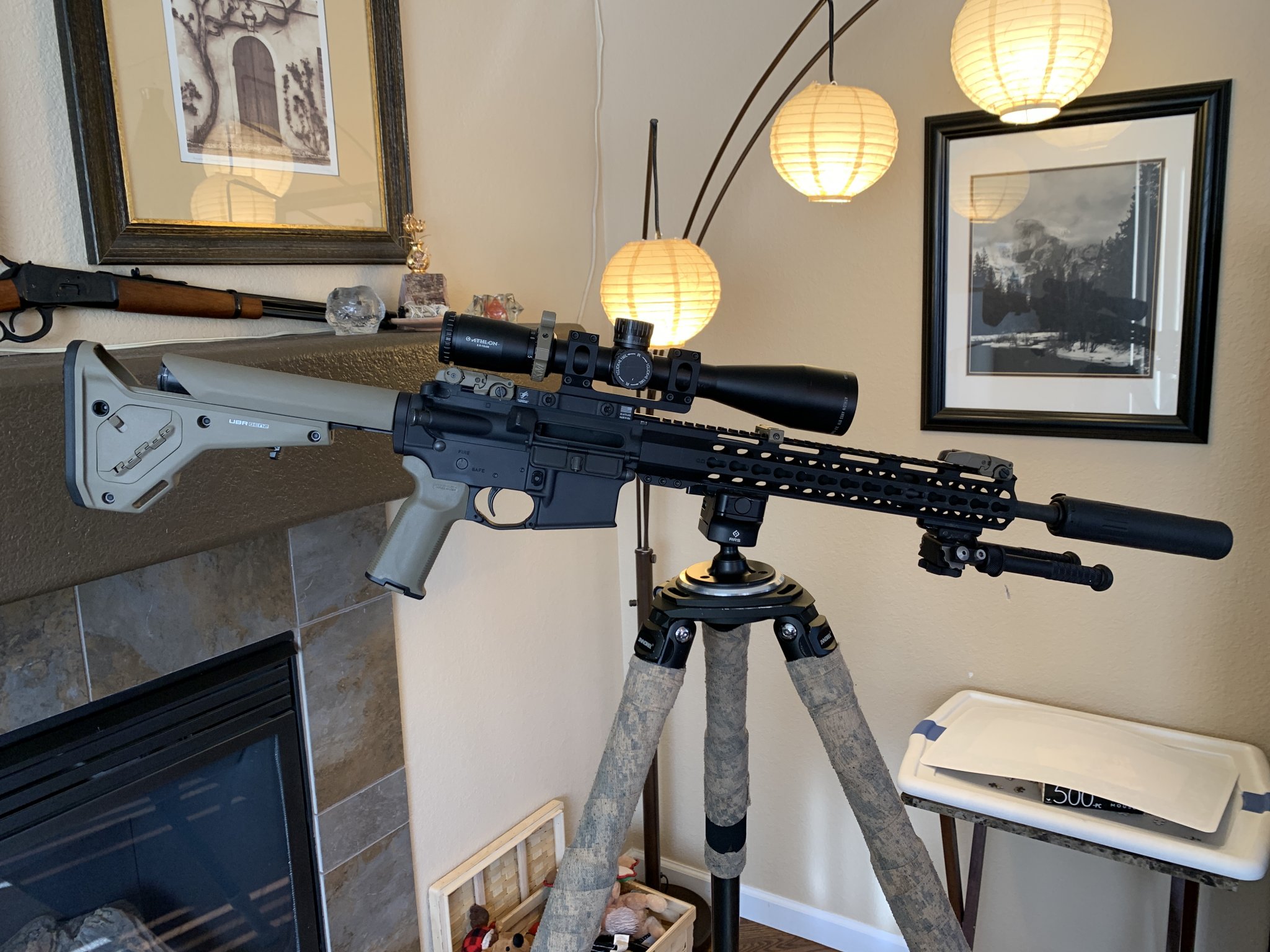

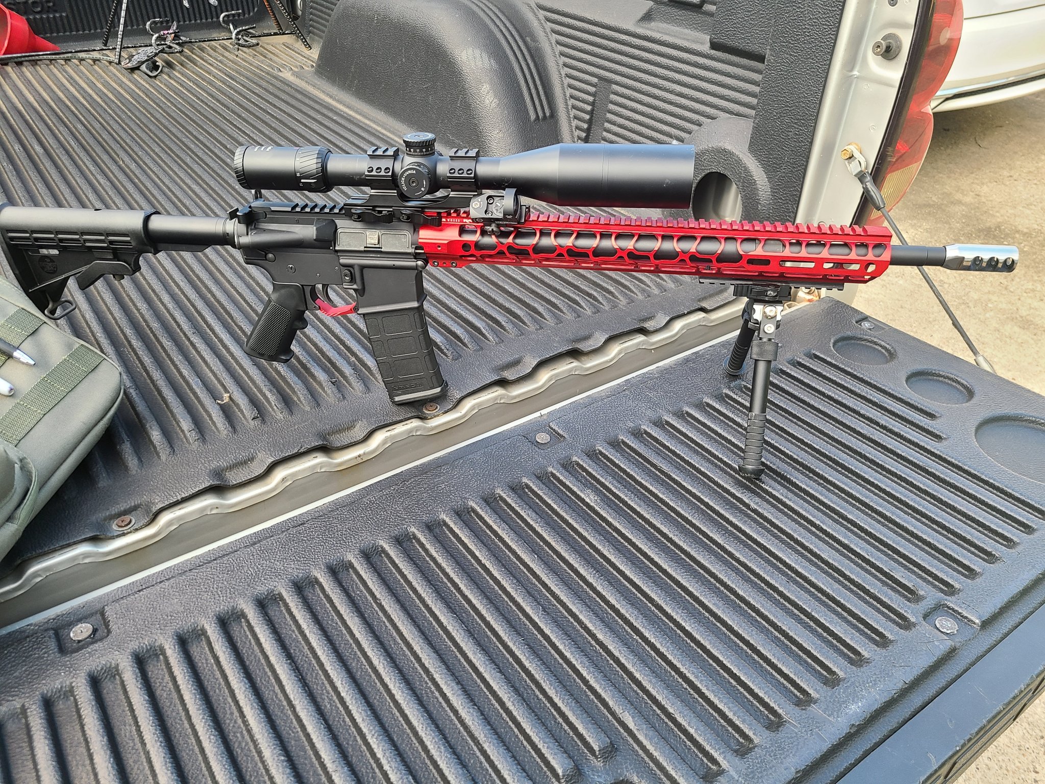

Updated SPR.
So, from the last time I posted this I've replaced the upper and lower receivers, new stock, new barrel, new bipod, and that's it I think.
Upper Receiver:
Vltor MUR
BCM KMRA-13
White Oak 18" SPR, RL Gas, 1:7 Twist
PRI QC Brake
Aero Precision Low Pro Gas Block
BCM Gas Tube
BCM BCG
Radian Ambi Charging Handle
BCM Pic Rails, Rail Covers, and Sling Mounts
Lower Receiver:
Aero Precision Gen II Lower
SOLGW LPK
Geissele SSA-E
Ergo Deluxe Grip
Magpul MOE Triggerguard
BCM Intermediate RE
Vltor A5 Buffer and Spring
BCM Mod 1 SOPMOD
Optic:
NF ATACR 4-16X42
NF Unimount

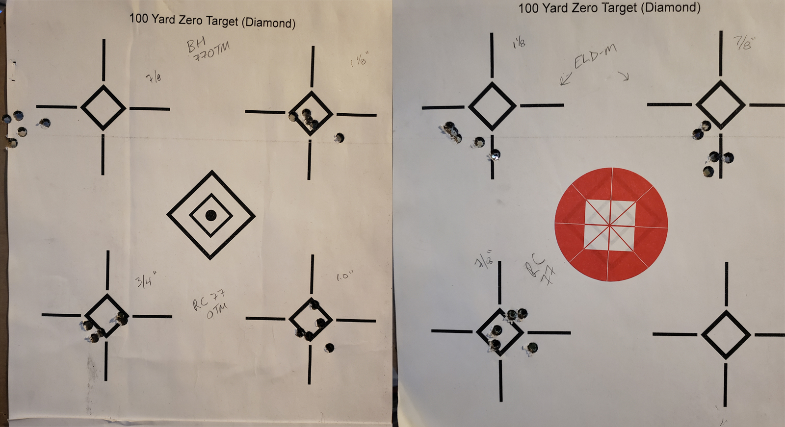

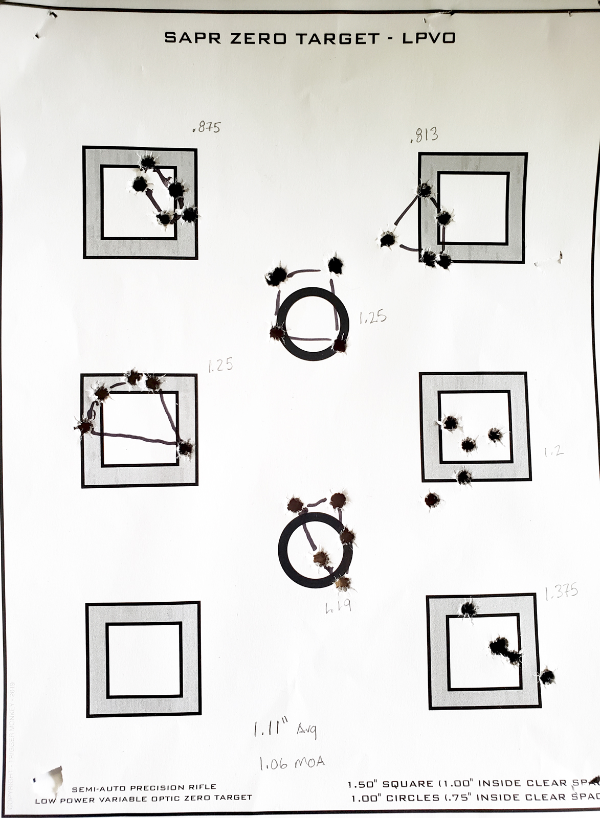

It shoots pretty good too, I did a test with three different kinds of match ammo and the average out of seven 5-shot groups was .98"
It's more snug than the Vltor E-Mod i had on there before. There's a little forward and backward movement but nothing really side to side, pretty solid for a simple lock up. It also feels considerably lighter.

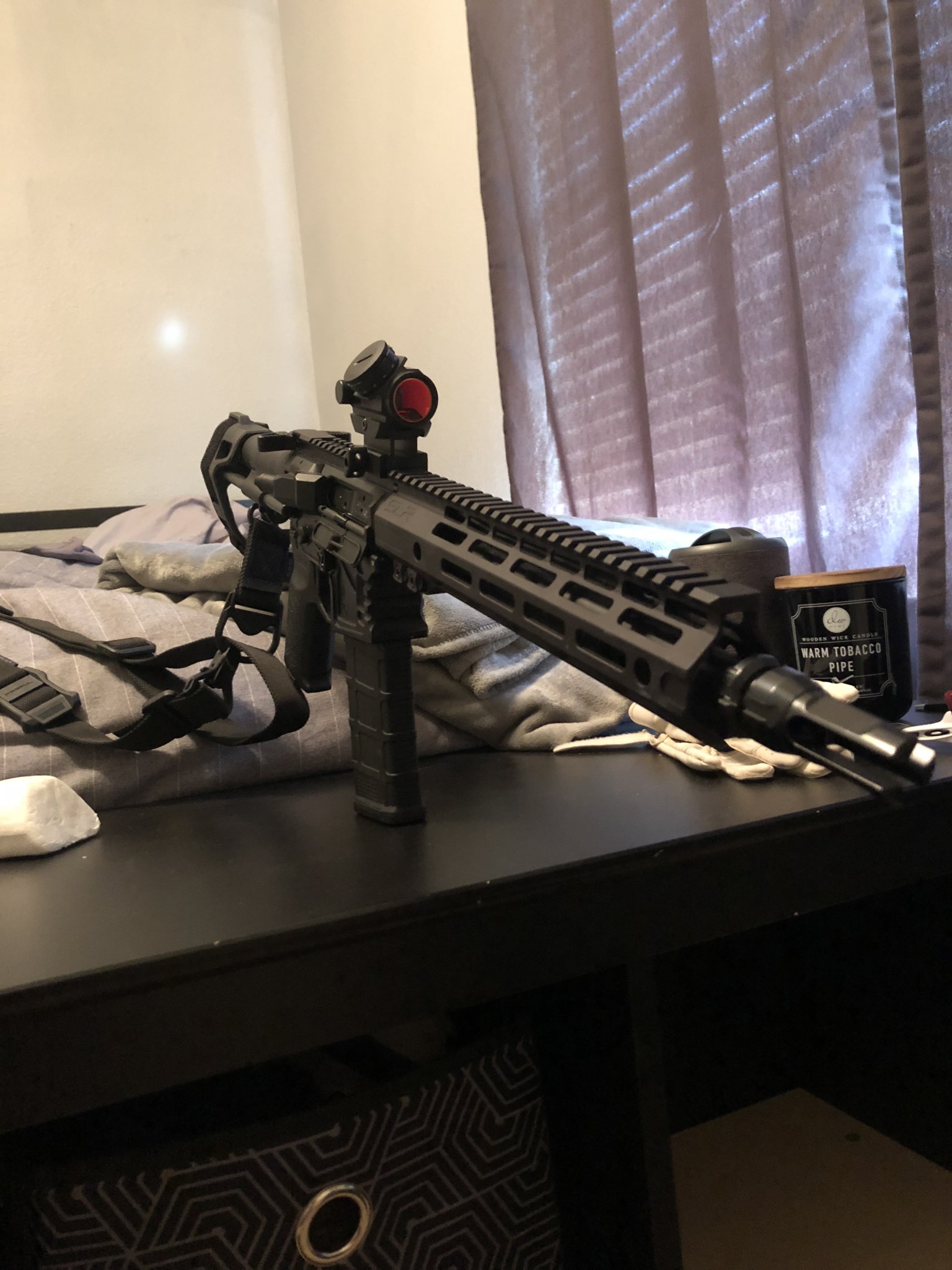

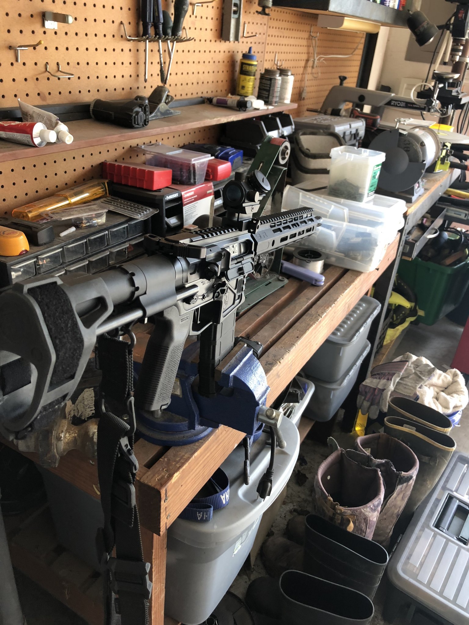

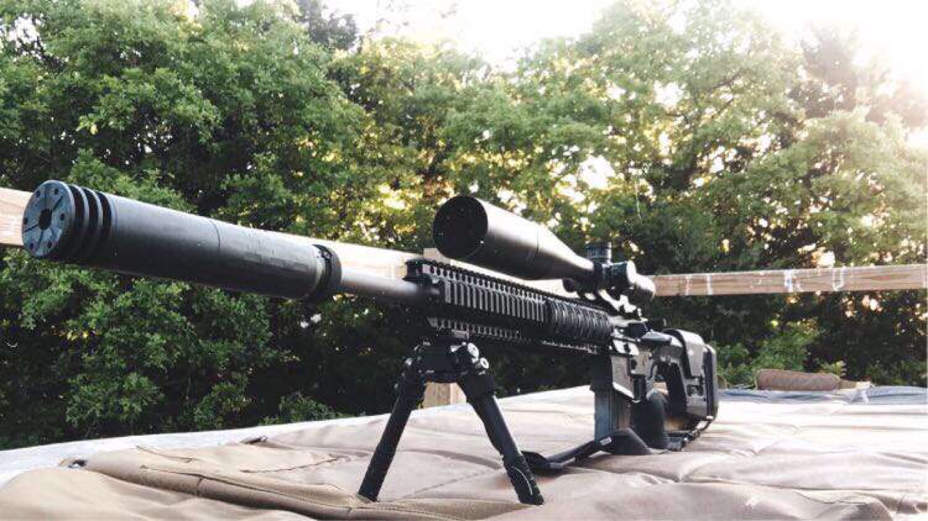

New build, almost complete...just need a light, sling and can cover.
The Reptilia grip is as stout as anything, it just matters if it fits your hand at that point. They make good stuff.
I don’t have any experience with the BCM or Magpul to compare it against...sorry.@Langford: Nice looking blaster. I have seen quite a few builds using the Reptilia CQG grip recently.
Do you have any feedback on how it compares to popular grips like the BCM Mod 1 or Magpul K2?
Thanks.

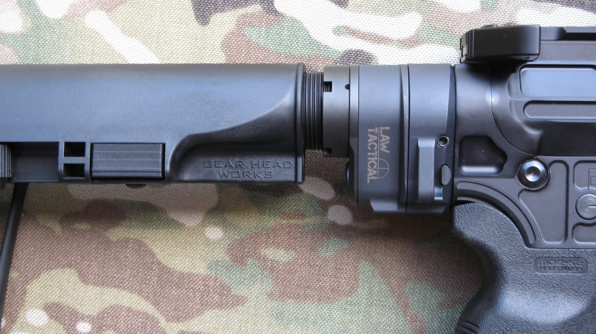

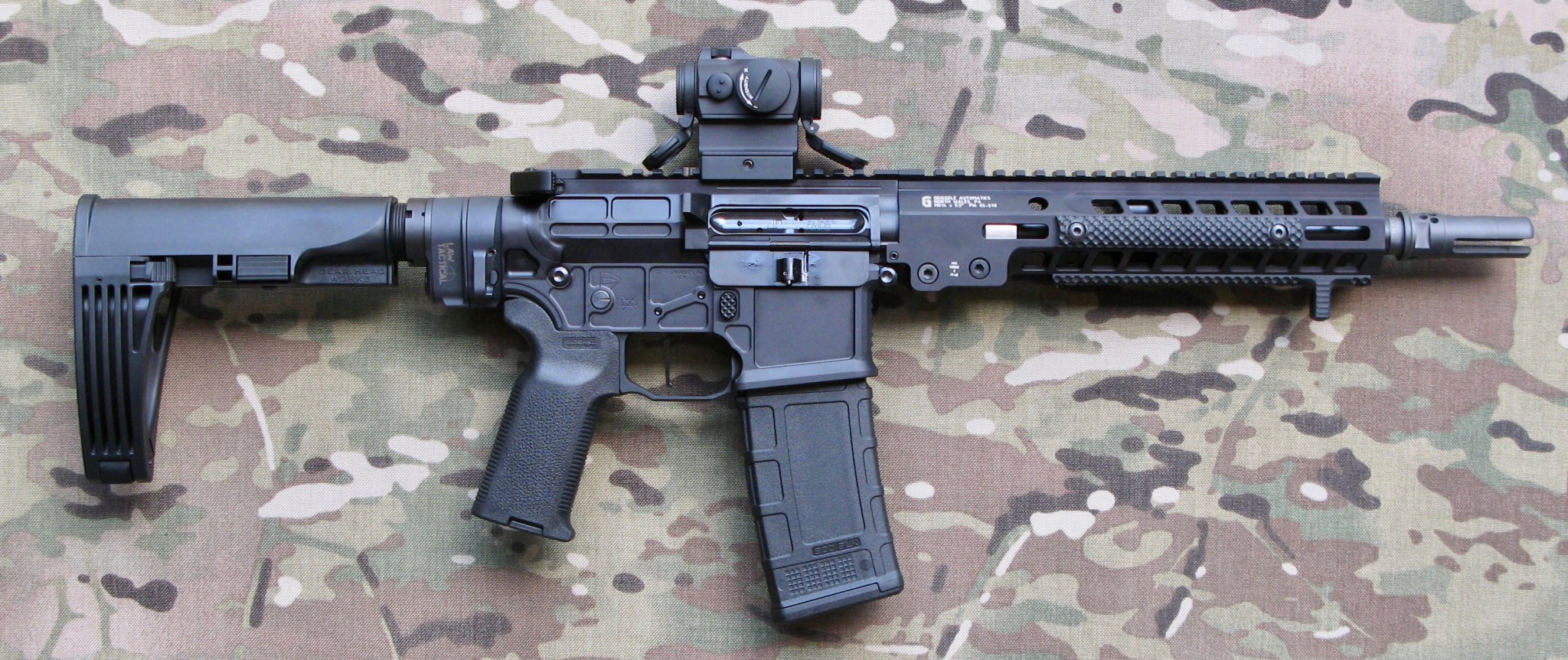

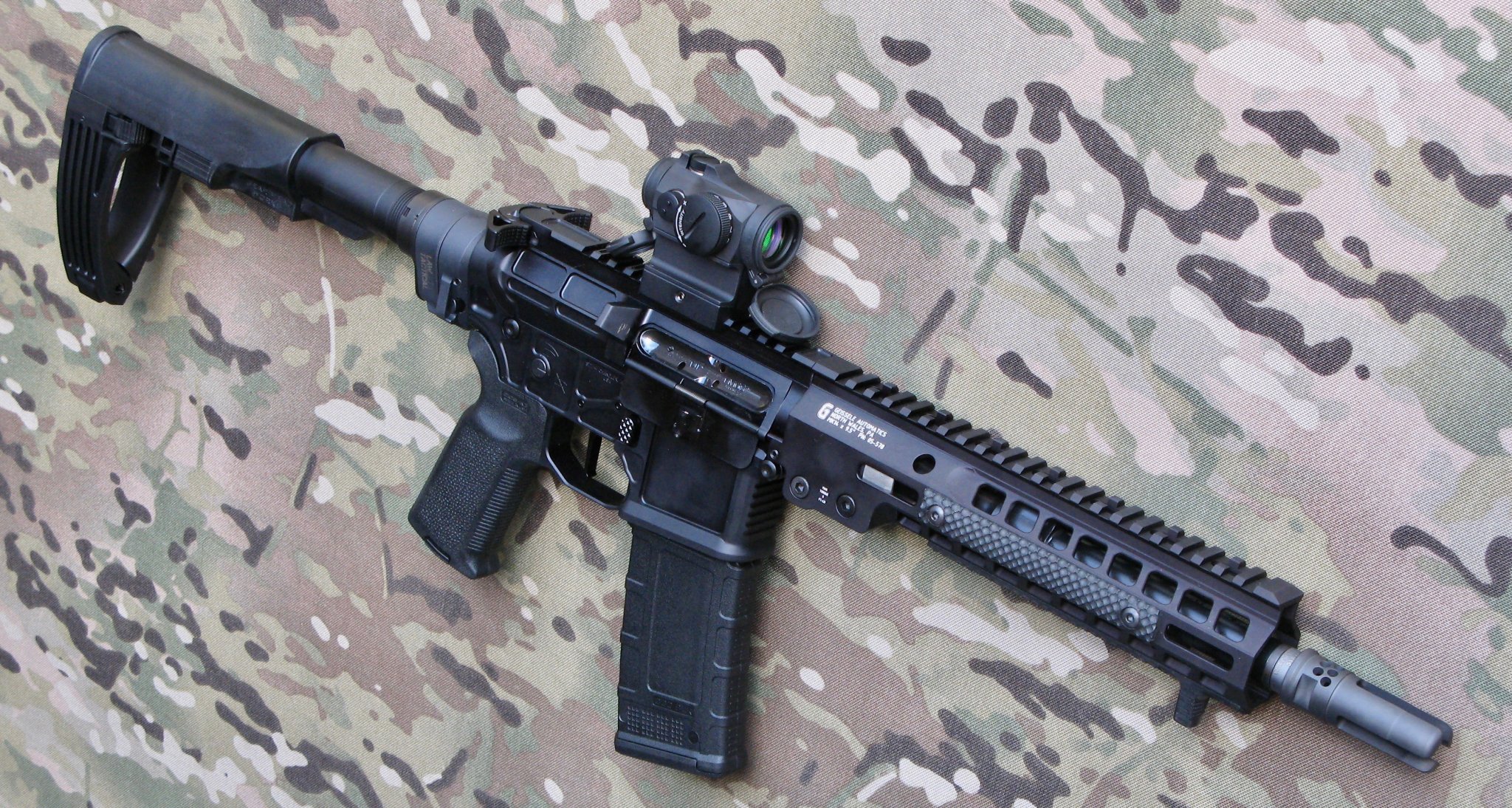

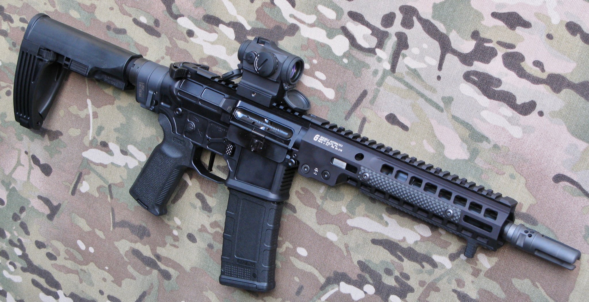

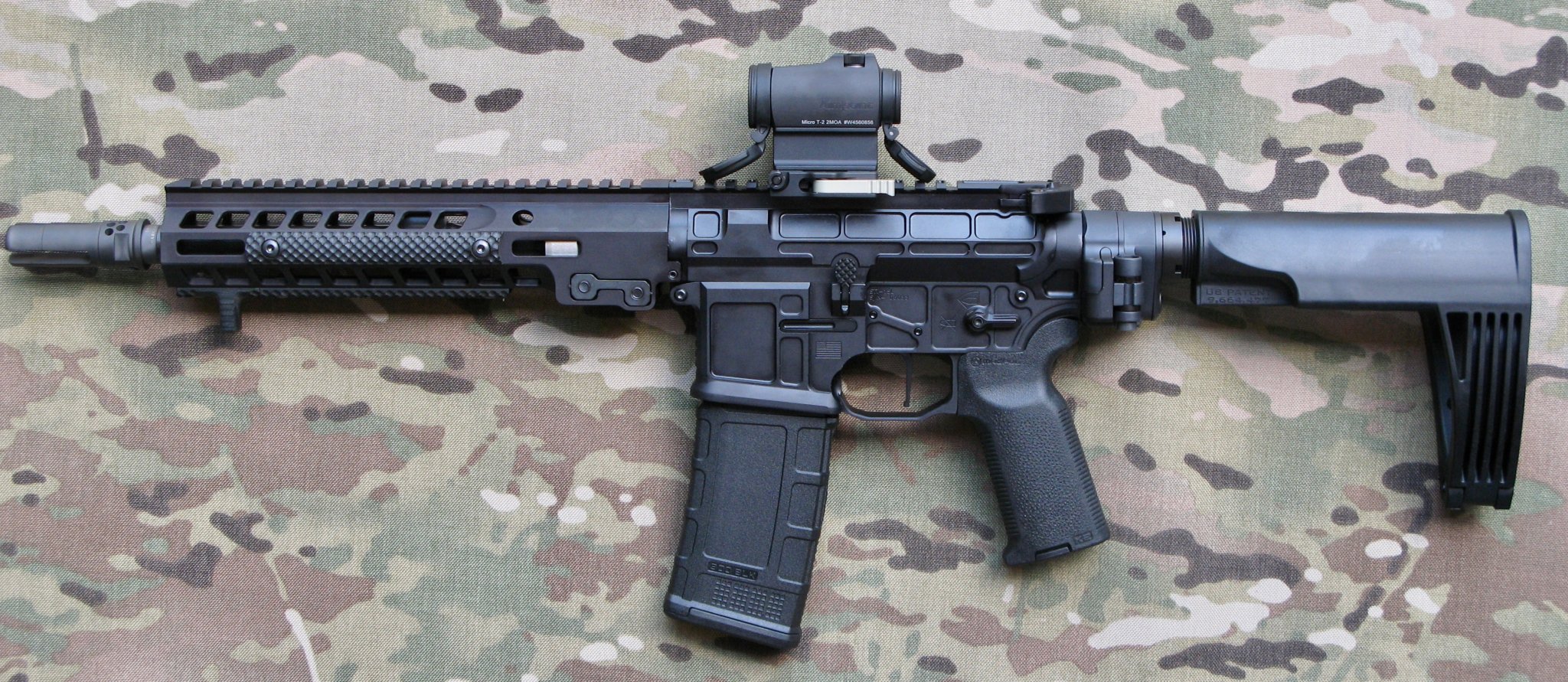

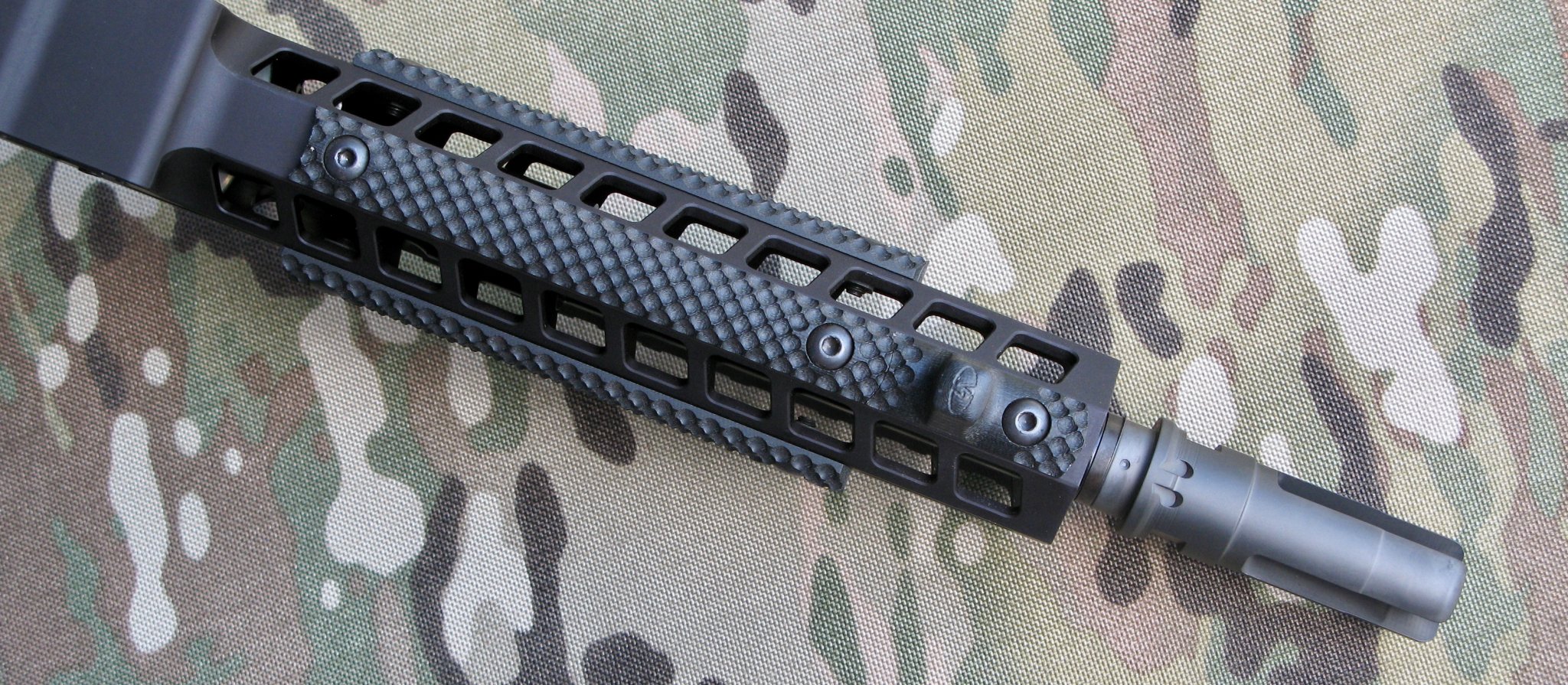

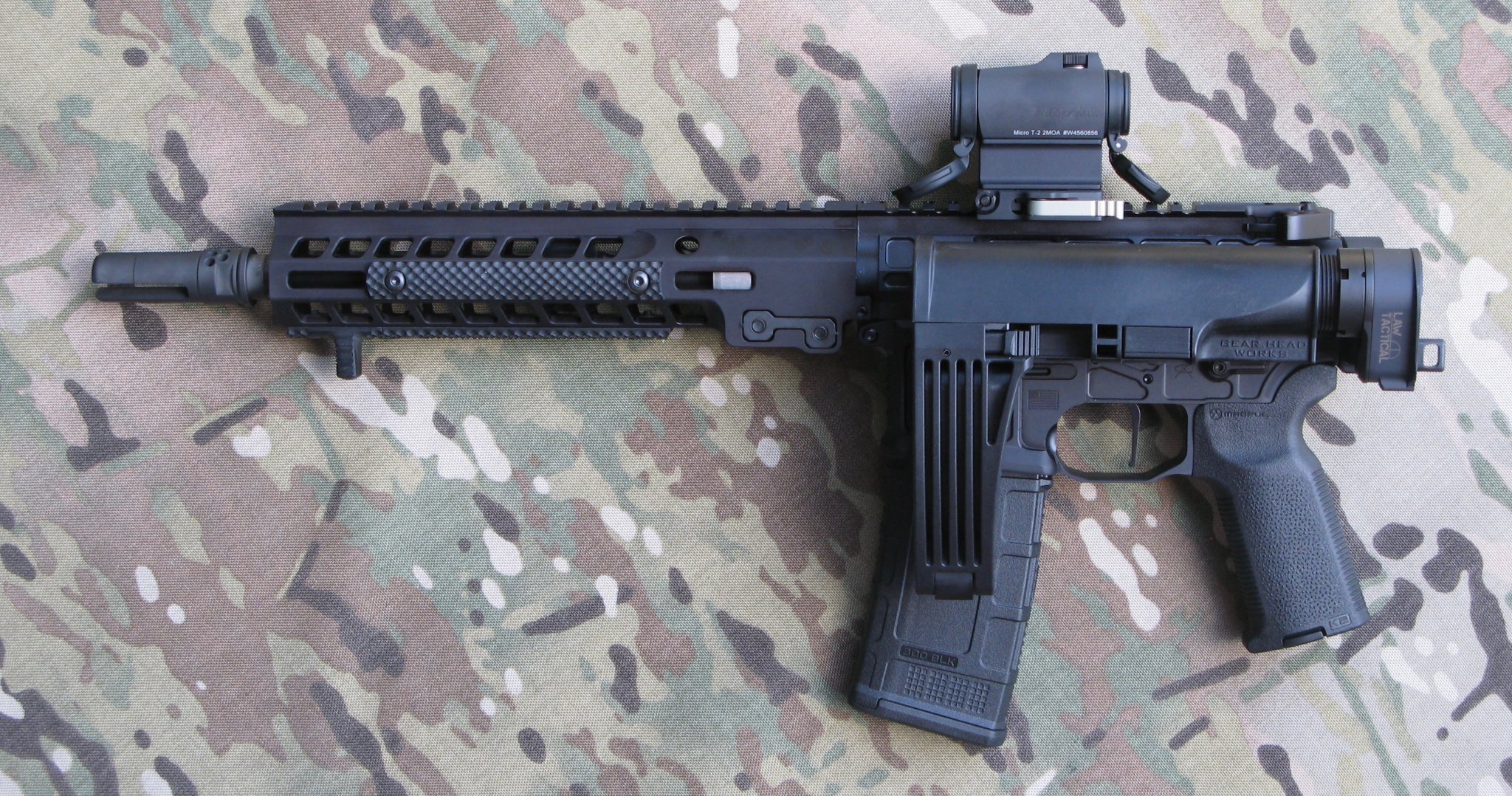

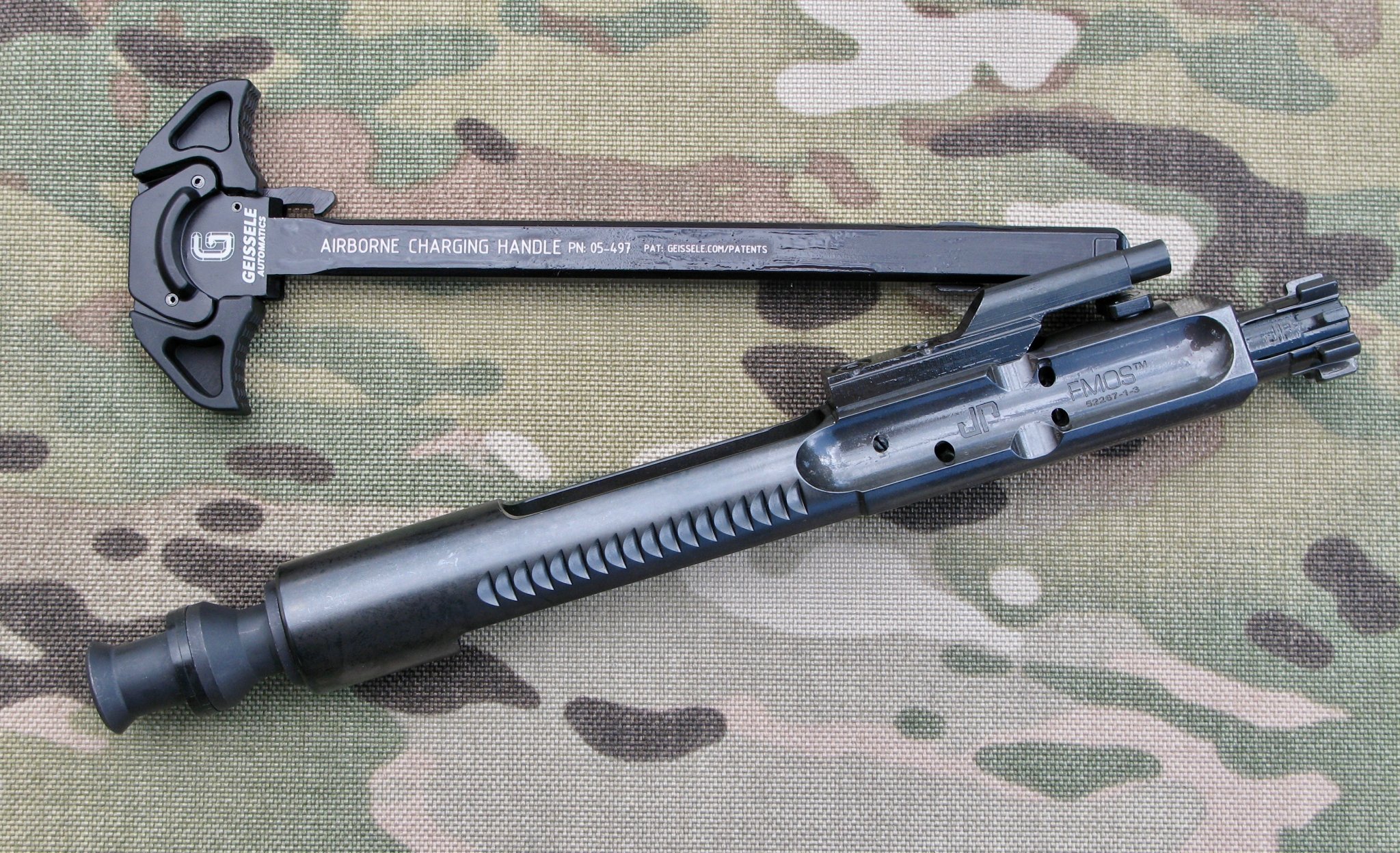

Very nice. Nice and compact!!This .300 Blackout pistol is I believe my best effort yet. It's more than just a really nice custom, built with the finest components available anywhere. Being a pistol, it can ride around, in all Free States, right next to you. It is one heck of a lot of horsepower in a compact package. With Barnes 110 grain TTSX marching out the muzzle at 2240 fps, it tops anything else in this size range.
The parts: SanTan STT-15L billet receiver set; V Seven 10.25" SS barrel and gas block, coated Black, with the only .30 caliber feed ramp barrel extension in the world (All the rest of the .300 BLK barrels out there of which I am aware have too-small .223 feed ramps.); Geissele Mk 14 9.5" rail with VZ G10 rail panels and hand stop; Surefire 7.62 WarComp; Geissele charging handle; JP FMOS bolt carrier group; LAW tactical folder; Geared Works Mod 2 pistol brace; Geissele Super 42/H1 recoil system; TriggerTech 3.5 LB Competition trigger; V7 small parts; Aimpoint T-2 in Aimpoint 1.535" mount. The LAW folder adds folding capability, obviously, plus 10.5 ounces, bringing the weight of the bare gun up to a still handy 6 LB 9 OZ.
View attachment 7342005View attachment 7342006View attachment 7342007View attachment 7342009View attachment 7342010View attachment 7342012View attachment 7342013View attachment 7342014

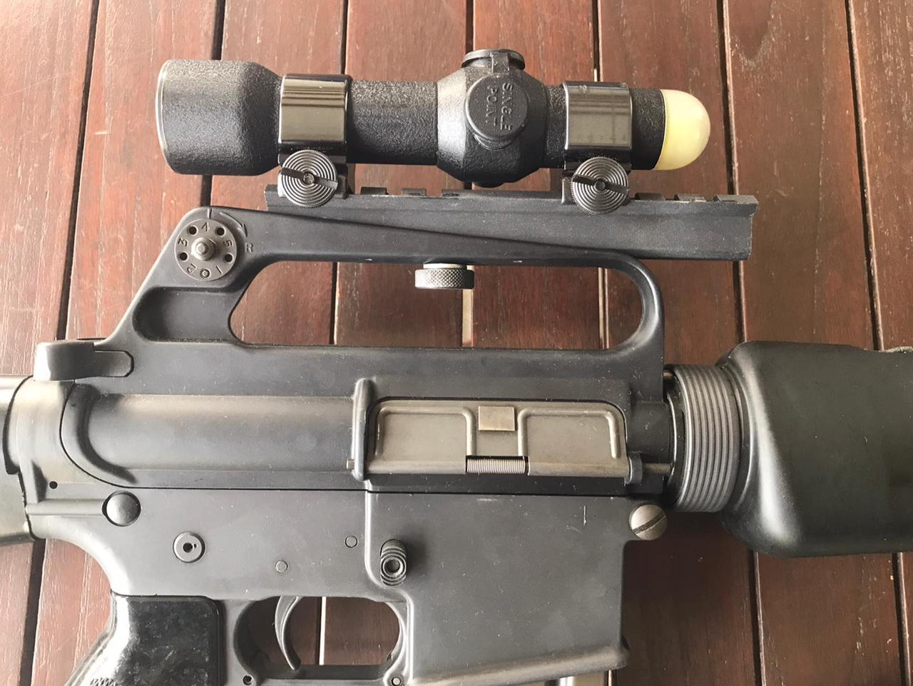

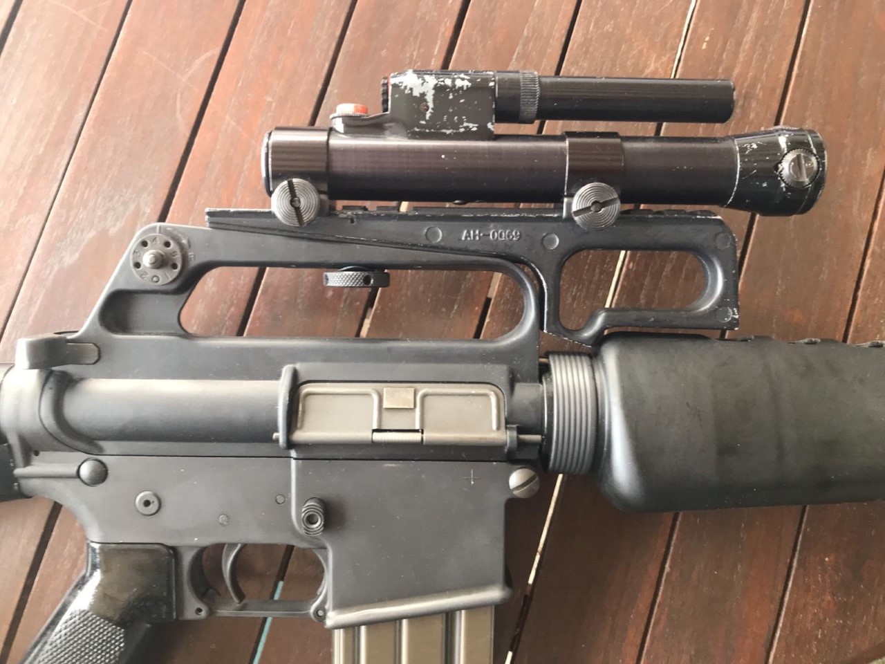

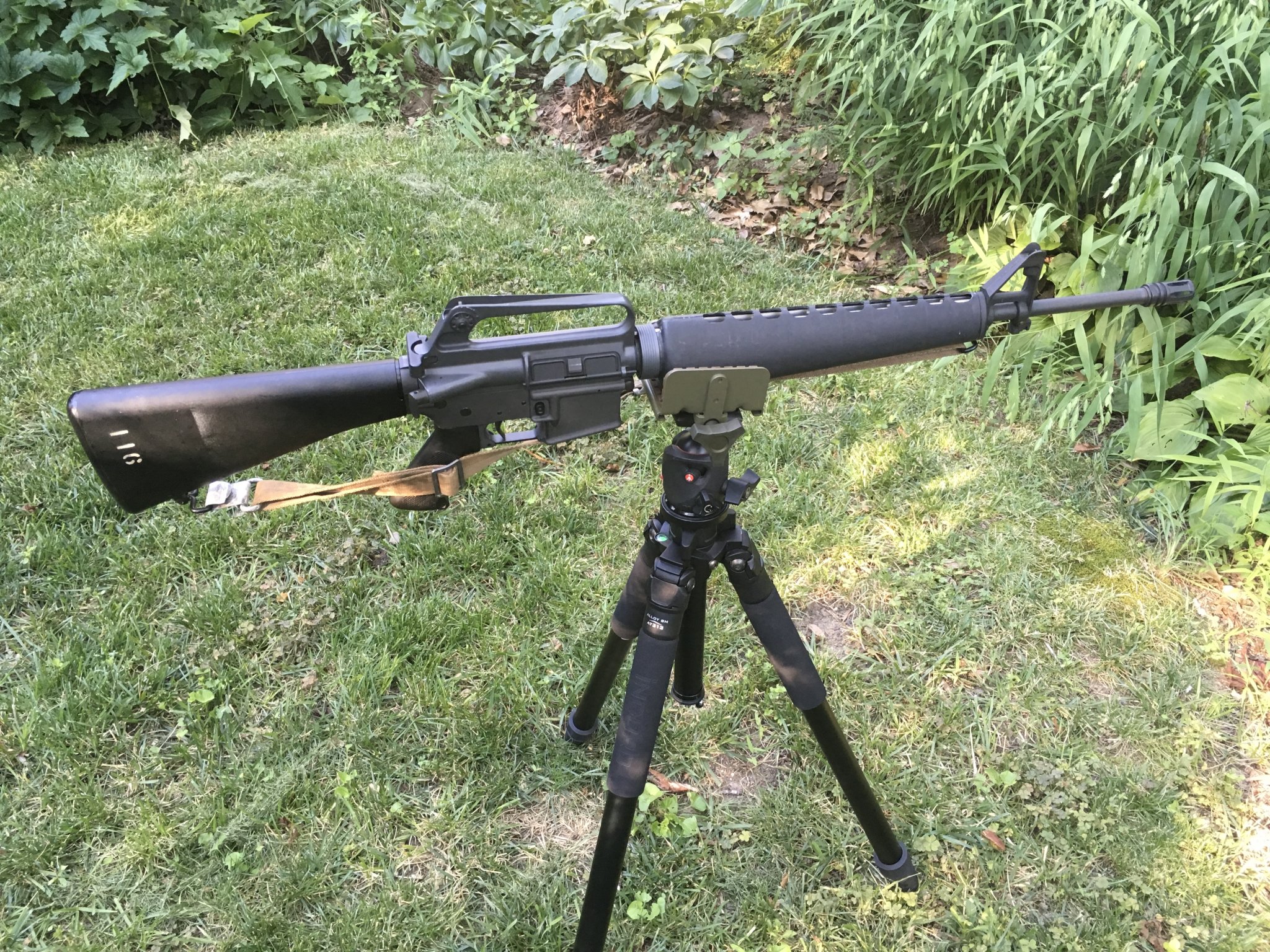

Classic beauty at it's finest!!! This never gets old!Needs a new port door.
