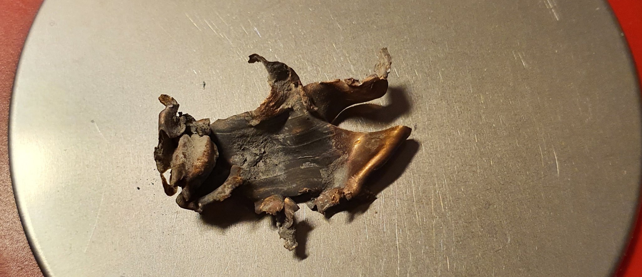

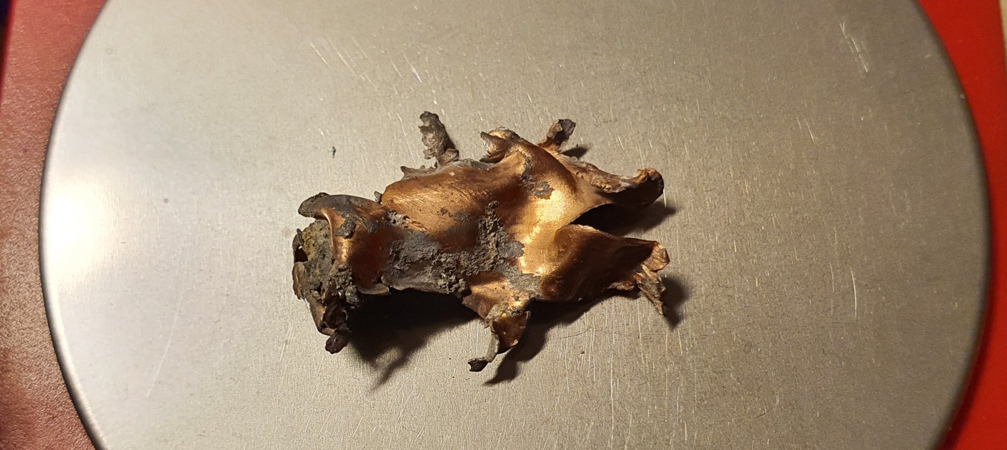

    Wanted to add that I tested shooting a 1.75L / half gallon milk carton filled with water at 313m / 346yds with a scenar 5g / 77gr.
    Out of 16", 2710fps.
    Velocity at target was 2000fps.
    939 Joules / 692 ftlbs.
    The bullet still disintegrated, it turned inside out. I managed to recover the jacket right behind the carton in the berm, but it seems the lead is in small bits, could not see any fragments on the ground but the jacket has them bonded to outer and inner side. The jacket remainings weighted 1.65g / 26gr.
    I expected for the round to just zip through, but indeed it shows that GB545 has potential. Now I am thinking if I should make some ballistic gel.

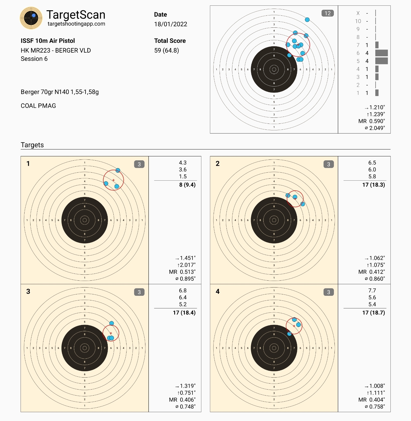

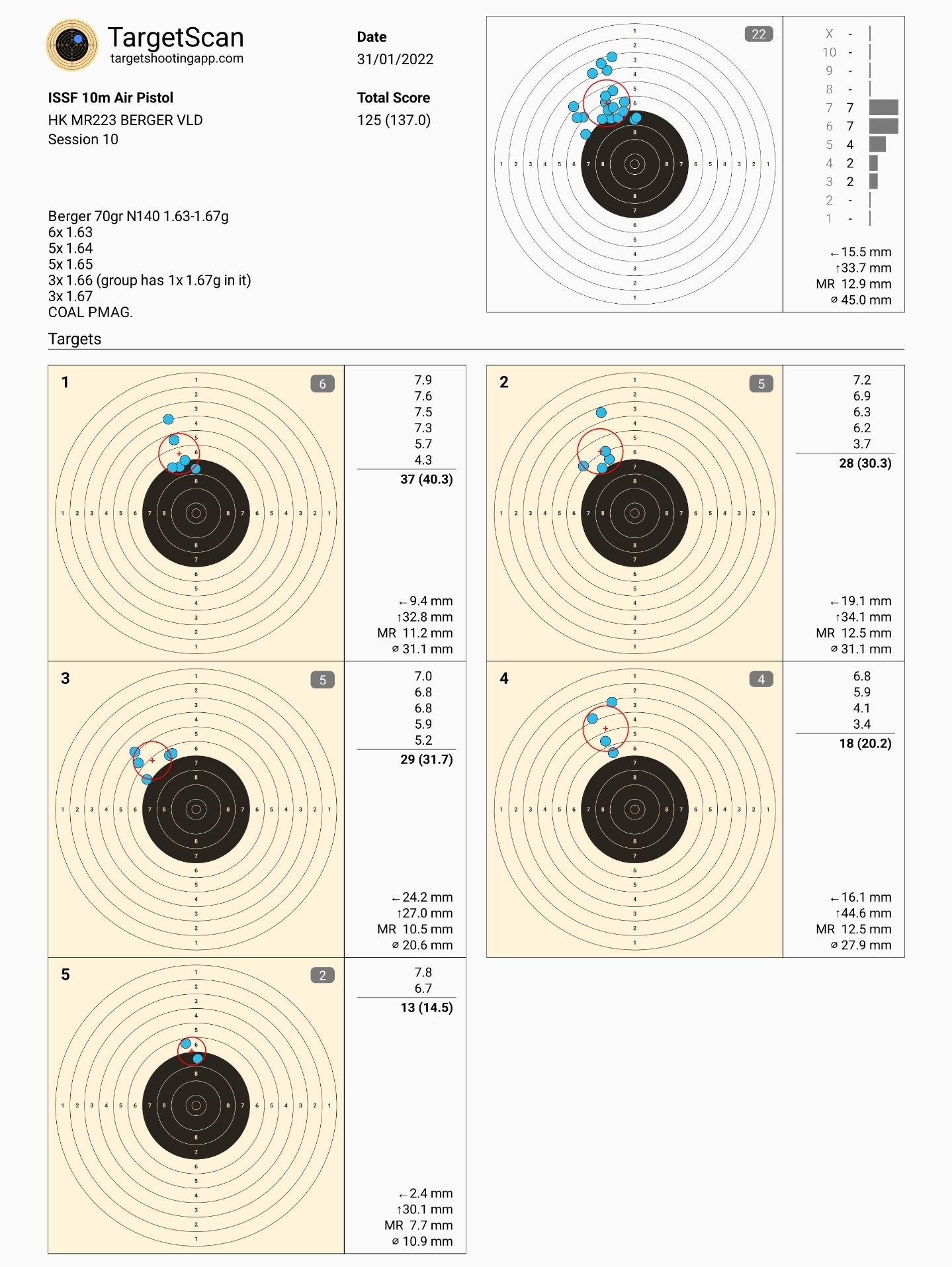

    I did test 70VLDs with N140 and it showed promising results.
    I did winter testing of 25.15 to 25.8gr (too much for summer) and it did OK. My testing setup was to walk on a field, bury into 2 feet of snow with glass ice underneath and somehow build a position there without the bullet entering into snow after exiting the muzzle.
    I also tested 23.9 to 24.4gr and while the single groups show pretty good (compared to Hornady, magnificent) I could not keep them clustered unlike the higher charges. My money is on that shooting was done poorer than usually, when I started reloading I really tensed up while shooting the reloads and sometimes this clearly shows. I usually do better at 300 than 100 because of this. This was probably shot on icy rocks, which was my main place to shoot.
