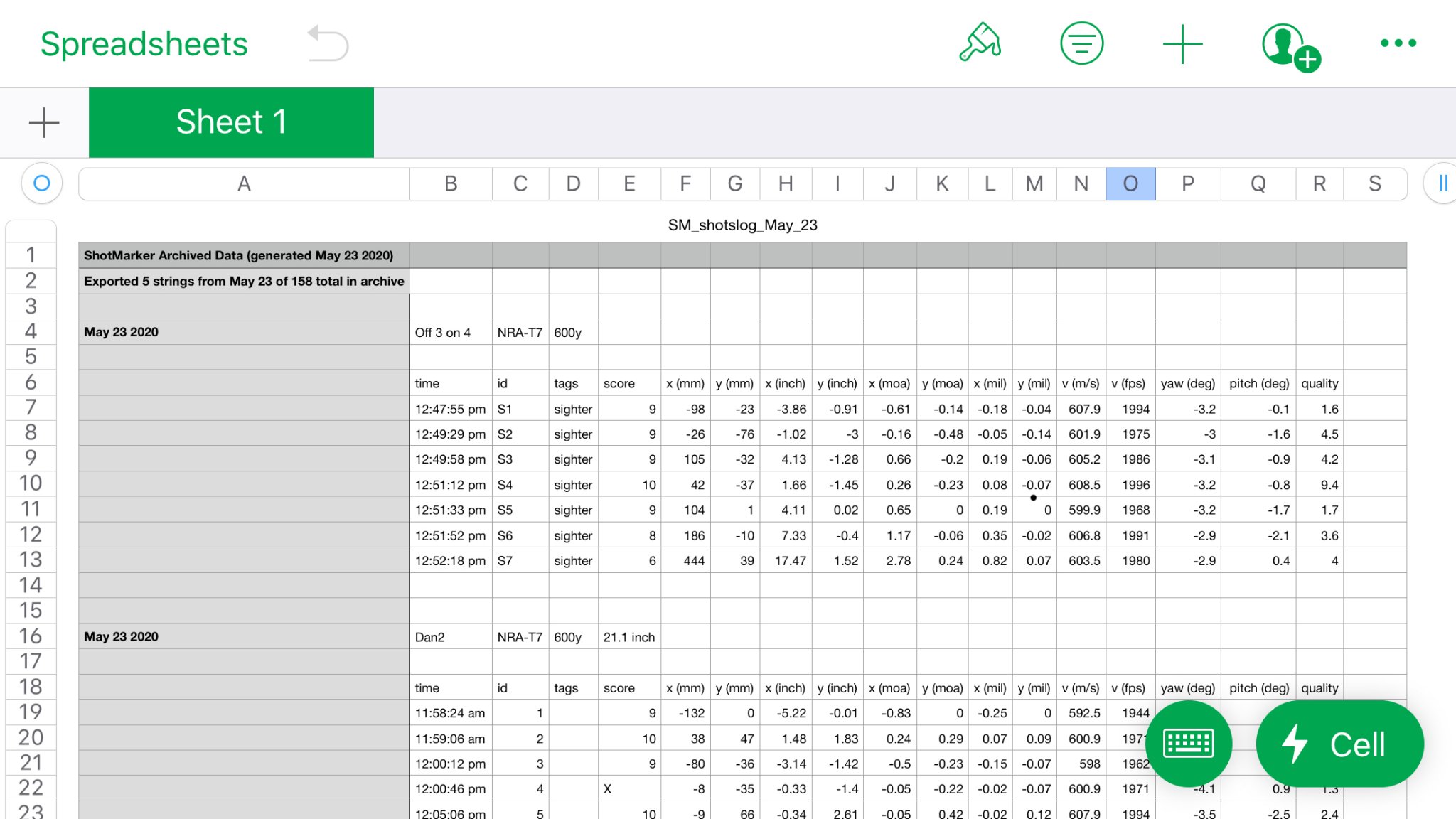

    Interesting, I’ve used shotmarker a bunch but never subsonic. Ill have to give it a try and see what happens.
    Its a great system btw.
    An example of the background information on the shotmarker system. This was me testing poi shift.
    Reactions: frost1235
