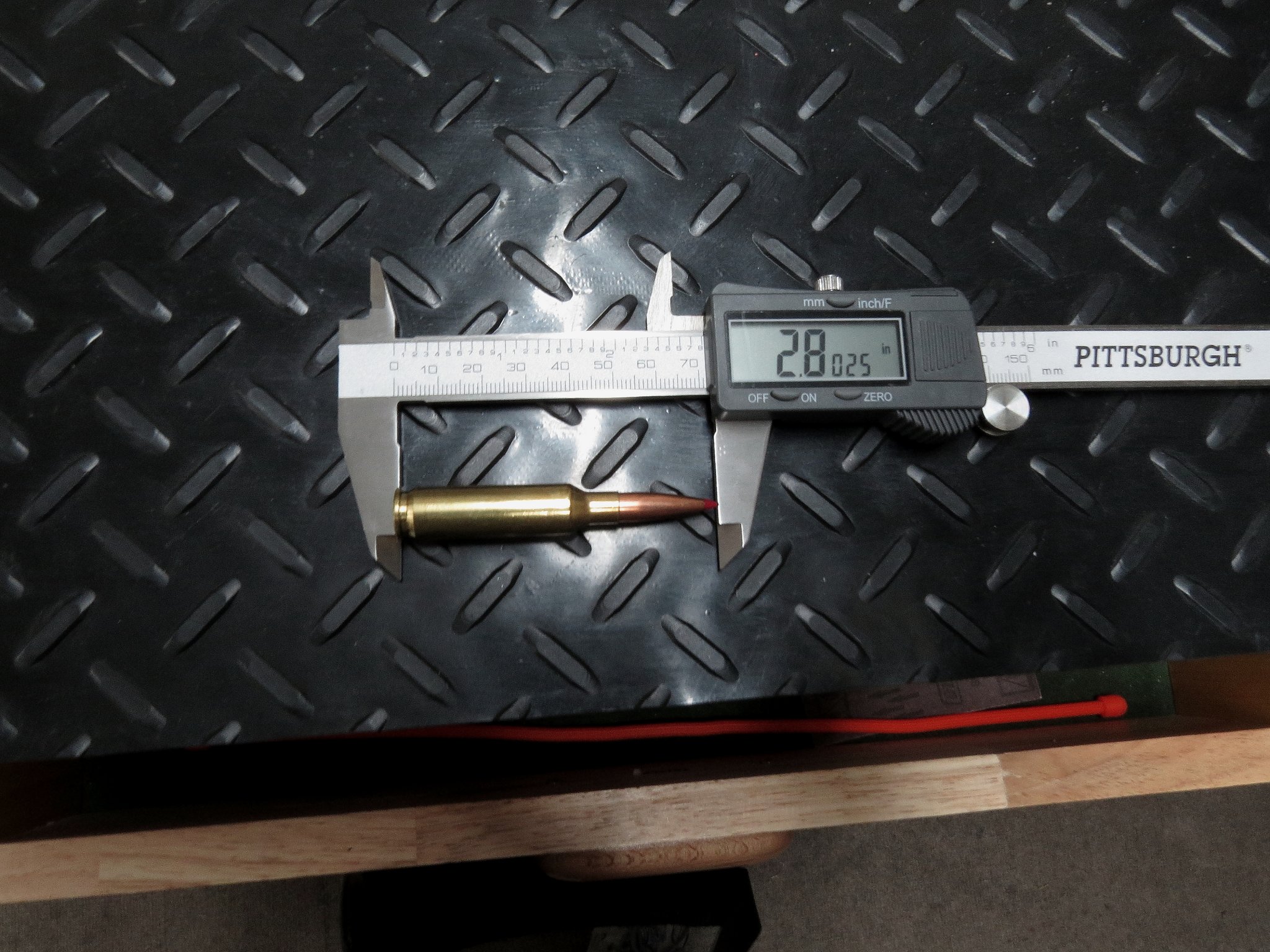

6.5CM from hornady is kept within specs for SAAMI +/- 2.82
The pic is a Hornady 147 Eldm.
And your info from MDT is also wrong so go back and read it again.

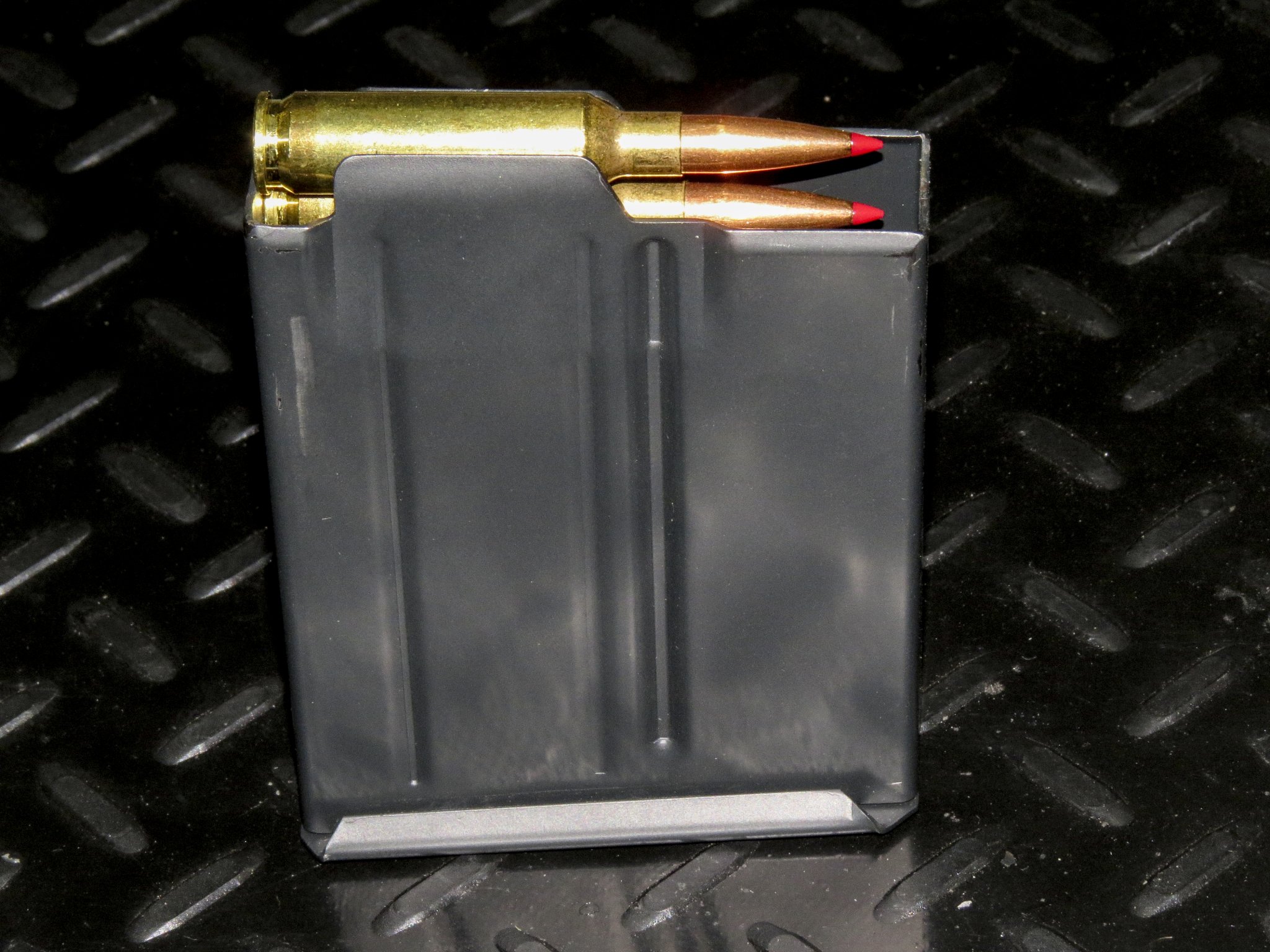

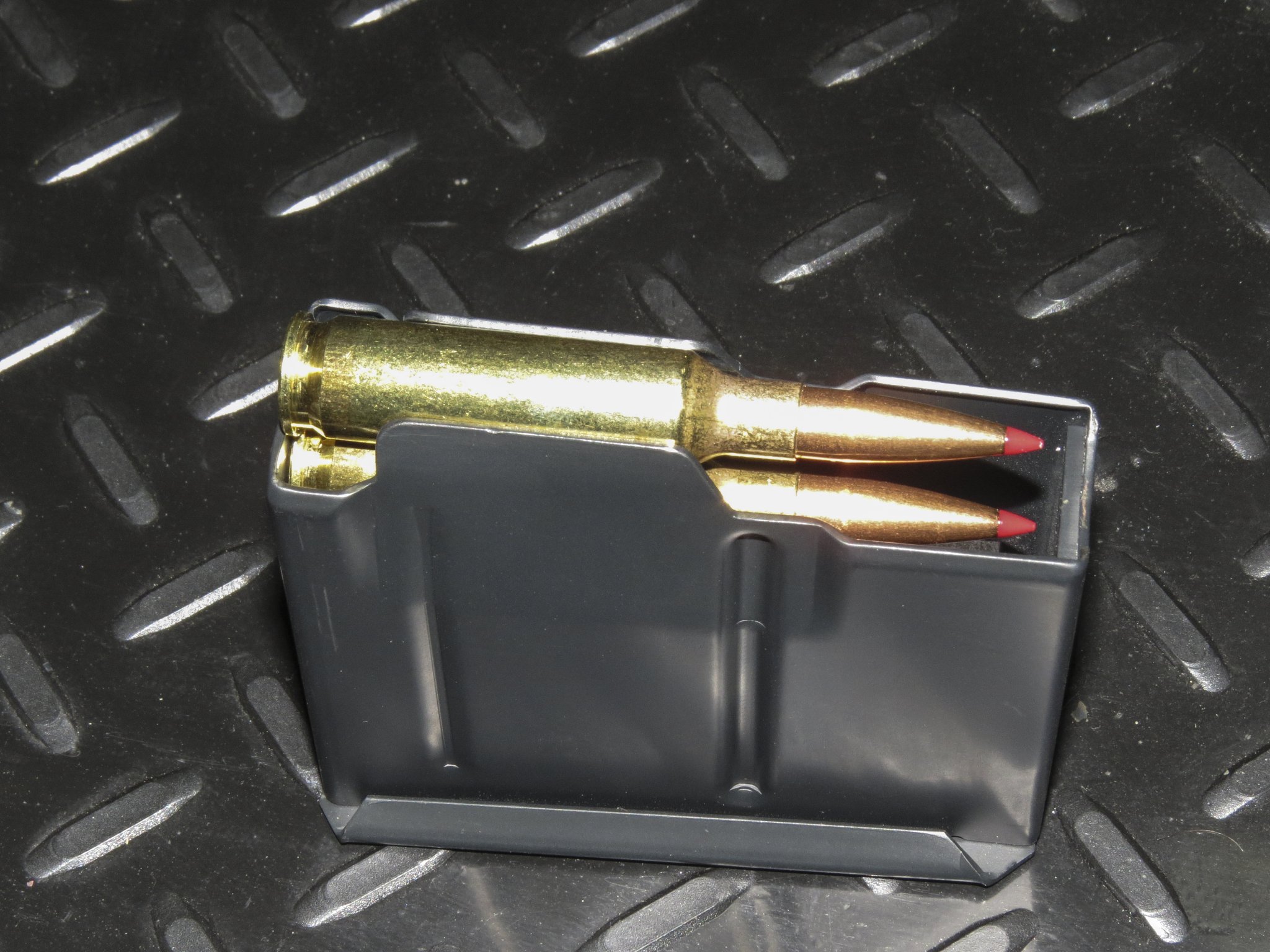

And just for your reference here are shots of the 5 shot MDT .308 with binder plate and the 10 rounder without the binder plate loaded with the Hornady 147 eldm 6.5 CM

Well It appears I can use the SA with binder. I just got the rifle Back and it has a Greyboe stock with their bottom metal. In fact Ryan from Greyboe just texted me the magazine they use for their shop 6.5. is the MDT Short action polymer hybrid with the metal top.
Thanks to all
Thanks to all
From the looks of this you have a good choice.....
