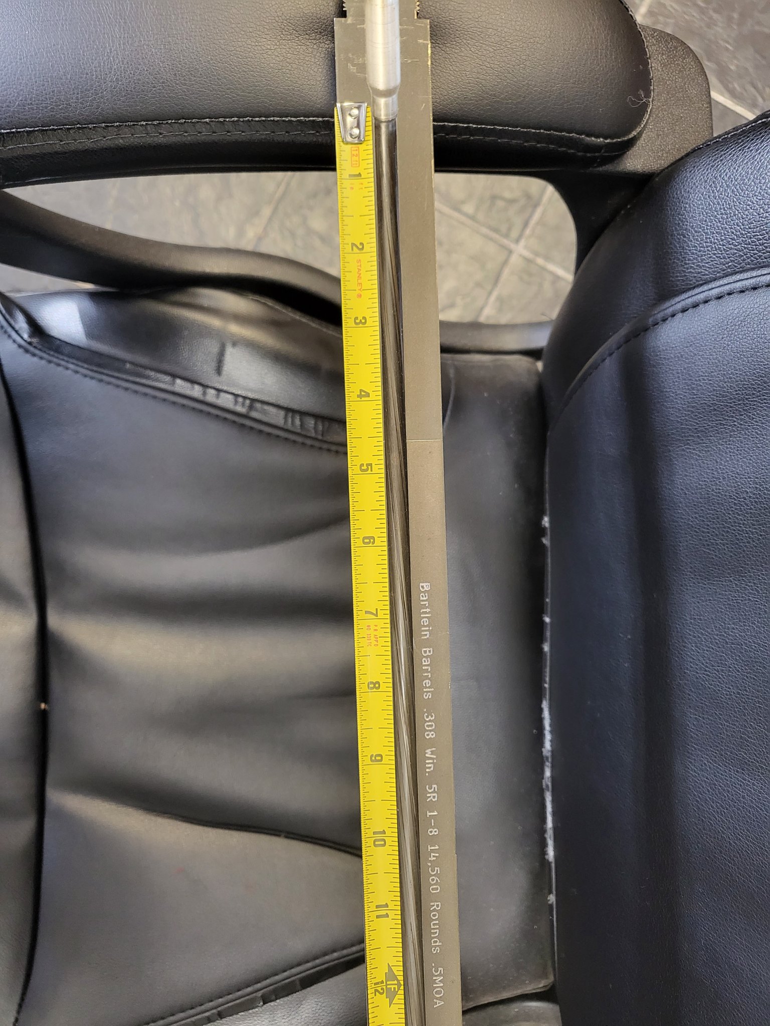

I know the barrel at 14,560 rounds we got back I had it wire cut in half. Here is a pic. About a good 1.5" of the rifling is gone from the case mouth. This is as I received it. No cleaning etc... you can see how black it is in the first part of the barrel from the carbon fouling.

I'll look at it again and see if I can come up with a close measurement on the 27k. I'll post back.
Holy crap, but still producing 0.5MOA groups per the etched info. That’s nuts!

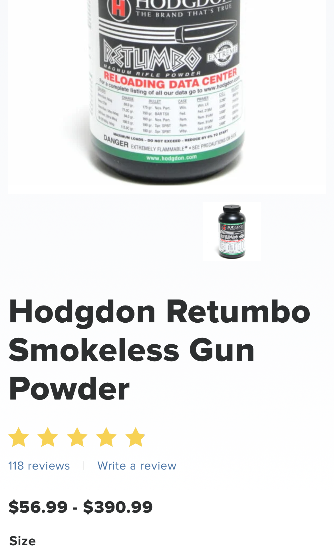

Then I guess you don’t buy Retumbo or similar powders now.
And don’t forget that unless you buy local, there’s shipping, taxes and Hazmat added. Easy $70/# .
$70/#, check again - 1lb H4350 $55.99 + Hazmat $22.99 + Shipping Under $100 - $12.95 = $91.93... plus state/local taxes, 6% for me.
