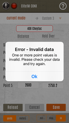

[No message]
Same error with the 7 Dakota numbers. I'm wondering if my firmware is outdated or something. Ser made in April 16'.
Well It works on my Galaxy Note 3 so maybe you need to uninstall it and re-download it again,
I don't have a Sim card in my note 3 because I only use it for the ConX so I don't use it as a phone. I will double check those figures before you change anything.
John
So I got,,,
sight In = 600 yards (NOT) metres.
point 1 =900 yards = 82.2" Drop.
point 2 =1200 yards =239.9" Drop.
point 3 =1500 yards =492.4" Drop
point 4 =1800 yards =867.0" Drop.
point 5 =2600 yards =2750.2" Drop
AND make sure the Icon is GREEN by pressing the ConX LRF's Range Button and Hit SAVE on the Lower right of the App Page..
Hope that helps,
John.
Yeah the numbers are right, its paired, just won't accept them. I don't know man. I've got it to accept numbers past 1000 on both of my other profiles to the 1300 range but it still wont give me a correction in the rangefinder past 1000. What is the ser # and date on the bottom of your unit?
Mine was made April 2016 and the S/N is and the model No is 202540
John.
PS have you got a Non Apple product you can hook it up to like a tablet or an android phone etc.
Same numbers here. I'll try it with an old android device tomorrow.
Ok mate no worries I will be here, Don't forget to remove your serial number from your post., I did hear about a couple of blokes having issues running the App on Apple gizmo's How true that is I don't know, So just a thought.
good luck,
John.
I've got an older android phone and it can't even find the app in the store. The only thing bushnell its returning is the trial cam app. Tried it with my daughters newer iPhone and it still won't accept the numbers. Look like I'm stuck to 1000 and under which isn't a big deal. I'll use the kestrel mostly anyway to get the correction.
