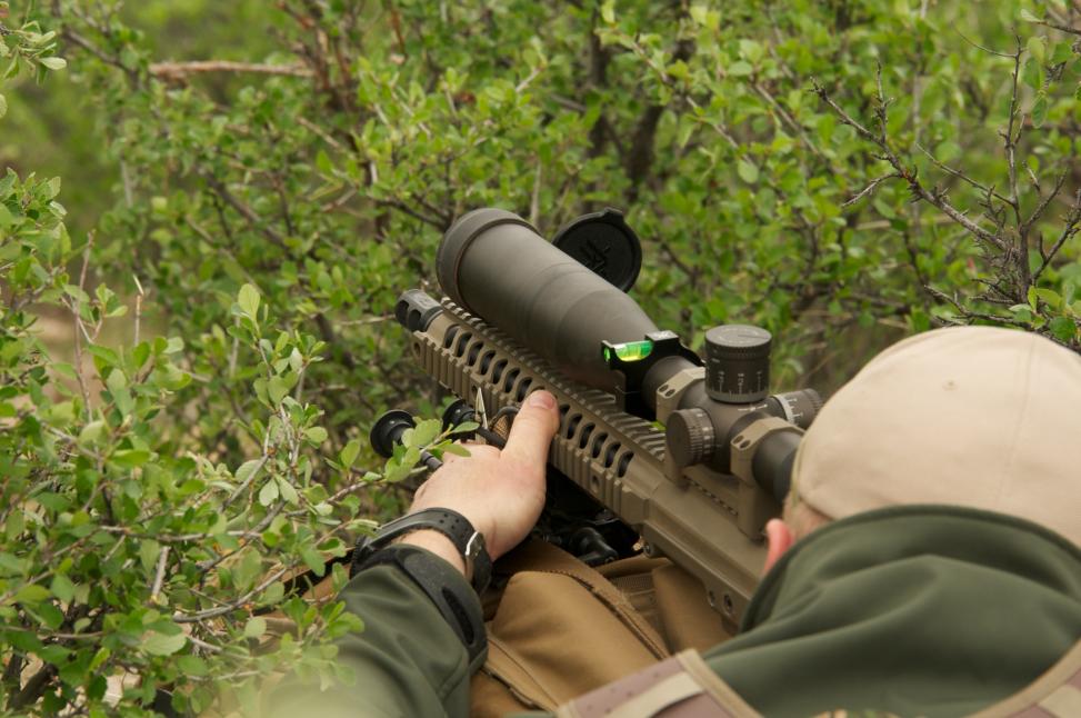

I took this image of a competitor during the 2013 Sniper's Hide Cup... a Field Match with high winds and targets out to 1200 yards+
At this point, this competitor "cleaned" the stage which included 1.5 MOA targets out to 800 yards... Note the Level on his rifle
Level's are a "training tool" and not a shooting tool, if you are using it while you are engaged in active competition or other meaningful shooting you're already too late. Still as much cant as you see in this image he HIT all his targets without issue.
The MAJORITY of the levels I saw on the line were exactly like this when the clock was running, ignored or off because the shooter had other things on their mind or did not set the level up to their natural position instead set the level up against their own body and mind. Levels are cool, but not the end all the hype makes them out to be.
Excellent work -- and a great reminder why the vertical cross hair must be plumb with the bore line.
The error will be just as pronounced (and confounding/annoying) when trying your darnedest to hold scope true to a bubble level while the rifle under it is canted left or right.
Shouldn't be a big deal (as we've had weapons like the BREN and top-fed Stoner 63) but there's parallax or off-set/non-convergence any time your sighting device isn't directly aligned.
