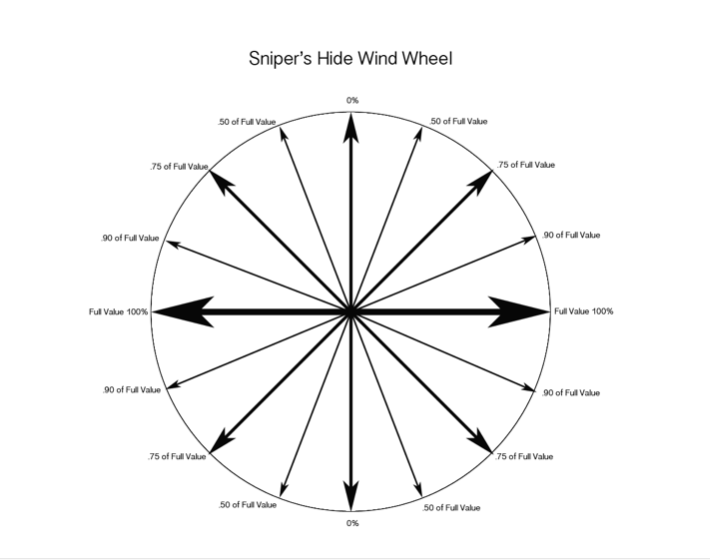

You have to have a basic foundation to begin with, like understanding the cosine of the wind angle
7:30 would be .75 or 75% of the full value wind as noted by the wind rose
Frank I have your wind diagram printed out and laminated for in the field And i use it. There is no way though I can do those calculations in my head. I need a calculator maybe your guys are just better at math. Like my example I would have to do .75 x full value wind at 700m. Then I would have to times that by .7 for the 7mph wind which I can't do in My head.
