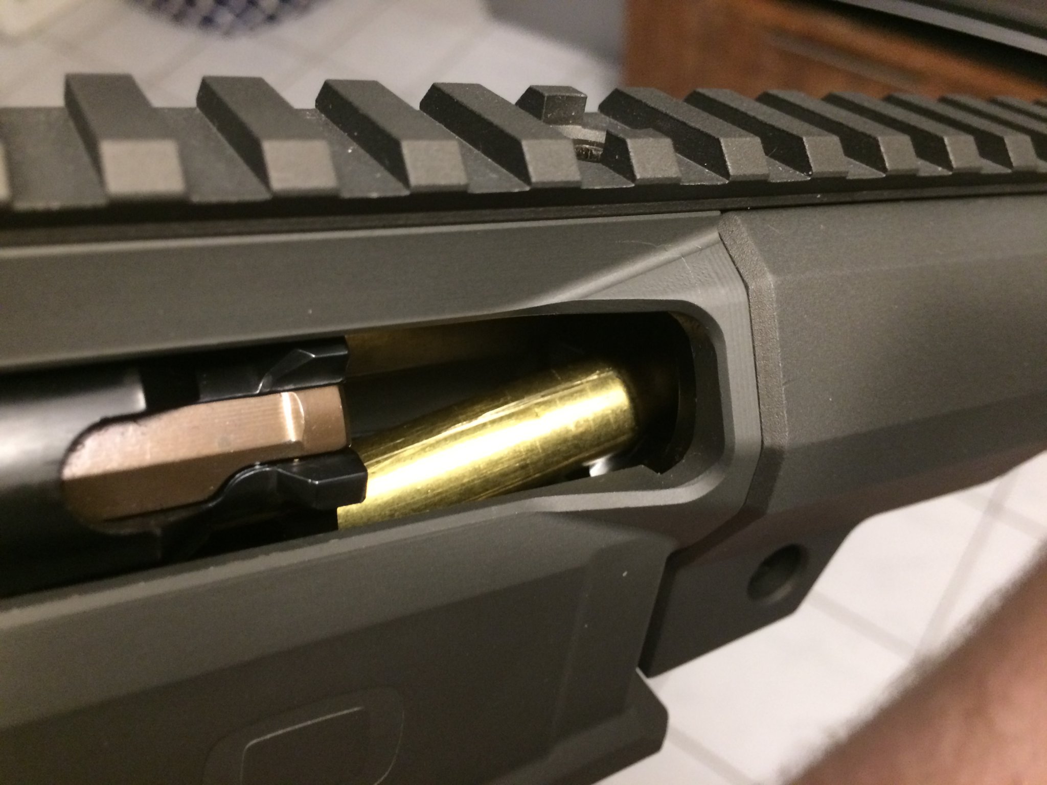

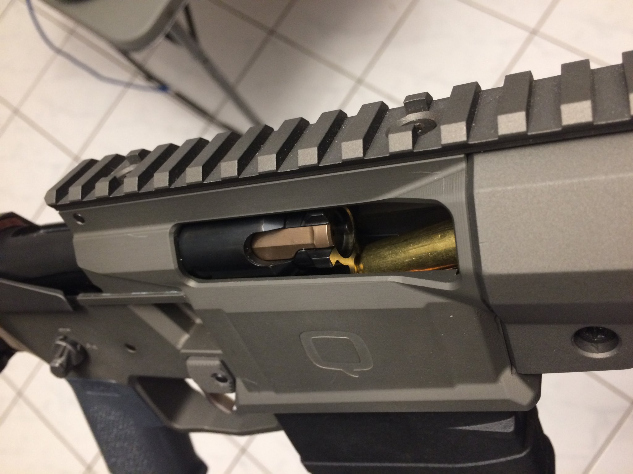

Mine is there now to see if they can straighten it out. It's been a week and a half but I haven't got an update. With some mags bullet tips hit below the feed ramps. 20 round mags greatly exxagerate it. Unusable for the most part. Running the bolt hard only tries to set the bullet back and maybe, sometimes, it will jump up on the ramp and load. Velcro in the magwell for me corrects the tip/ramp alignment but then I get bolt over base issues as the rear of the round kicks down while entering the chamber.

This looks a lot like my old savage. Cases would get stuck on the boltface about 1/2 way into the chamber. As far as shimming the magwell, instead of using velcro, would a thin strip of this work better? https://www.mcmaster.com/standard-plastic-sheets

Is yours having issues entering the chamber or not even getting out of the mag too like mine has trouble with?
Looks like it's virtually the same issue as yours.

It's the same thing as mine. It's not a short stroke issue. As the round is coming out of the mag sometimes the case head slips underneath the bolt lugs or feet. Similar appearance to short stroking the bolt.
Larue mags work in yours? They're a solid no in mine. Basically 0% functionality unless I hold the mag up and forward. The meplats or plastic tips basically just jam into the inside of the magwell right below the feedramps. "Running the bolt hard" only serves to jam the bullet down in the case.
Magwell is too loose and let's the mag sag at the front.
Feedramps need to be more like m4 style.
Mag sits too low.
It's one or a combination of these issues with mine.
Mag sits too low.
