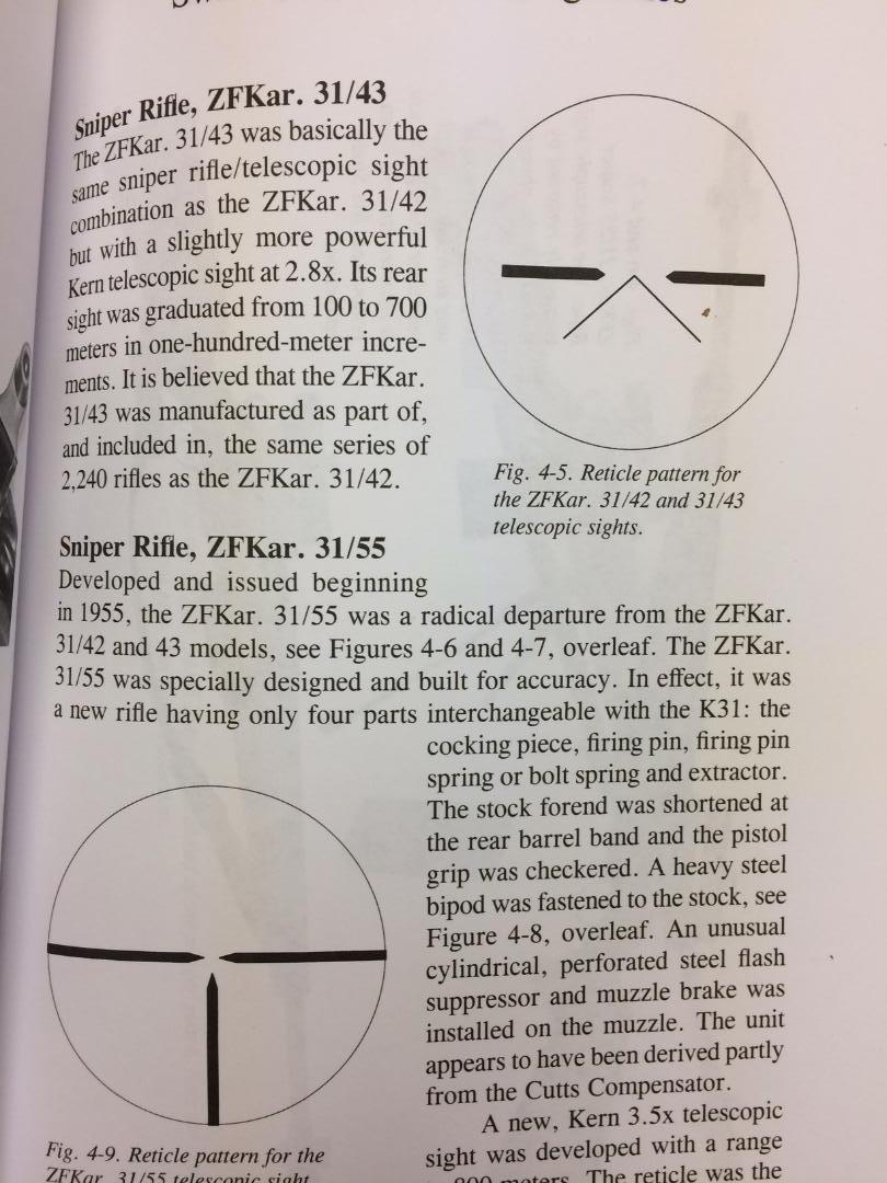

Sorry to go off topic a bit, but any chance anyone has a picture looking through the optic on one of these rifles? Or a published diagram of the reticle.
Purely for my own curiosity. I see a few for sale here and there and haven't seen much of anything about the scopes.
Picture of reticles as shown in book by Joe Poyer, "Swiss Magazine Loading Rifles 1869 to 1958" (North Cape Publications, 2010)
(I'd love to own a ZFKar 31/55, but doubt I'll be able to find an affordable one, but Poyer's book is pretty good):
7085292
the k31/43 and k31/43 reticle is correct above. the zfk55 does not look correct at all. I don't have a picture on hand but I can take one through my scope. I have owned a few of them and I have never seen one that looks like the one in the poyer book. I agree its 3 post but the vertical reticle is blunted at the top not pointed like german or russian (not sure why).
