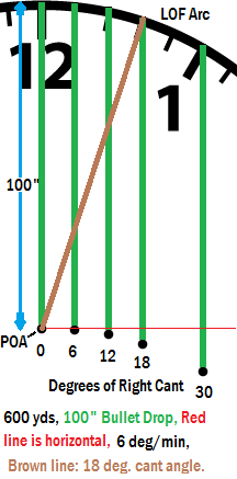

The horizontal change in bullet impact for a given cant equals bullet drop at target range times the sine of the cant angle. Vertical change is insignificant for the first few degrees.

OK, Culpepper, here's the first part in English.
Do you understand that bullets drop virtually the same amount at target range regardless of where the muzzle axis points? This is for horizontal line of sight +/- 1 degree vertically.
If not, this has to be well understood before going further.
Do you understand that bullets drop the same amount at target range regardless of where the muzzle axis points?
Does it? I thought that was the point of incline/decline compensation, that if the axis was up or down your drop will change?
Yes, it does. What trig function calculates the drop difference for a cant angle?
Note the line of fire is seldom more than 1 degree above the line of sight in horizontal fire. I edited my post to clarify this.
