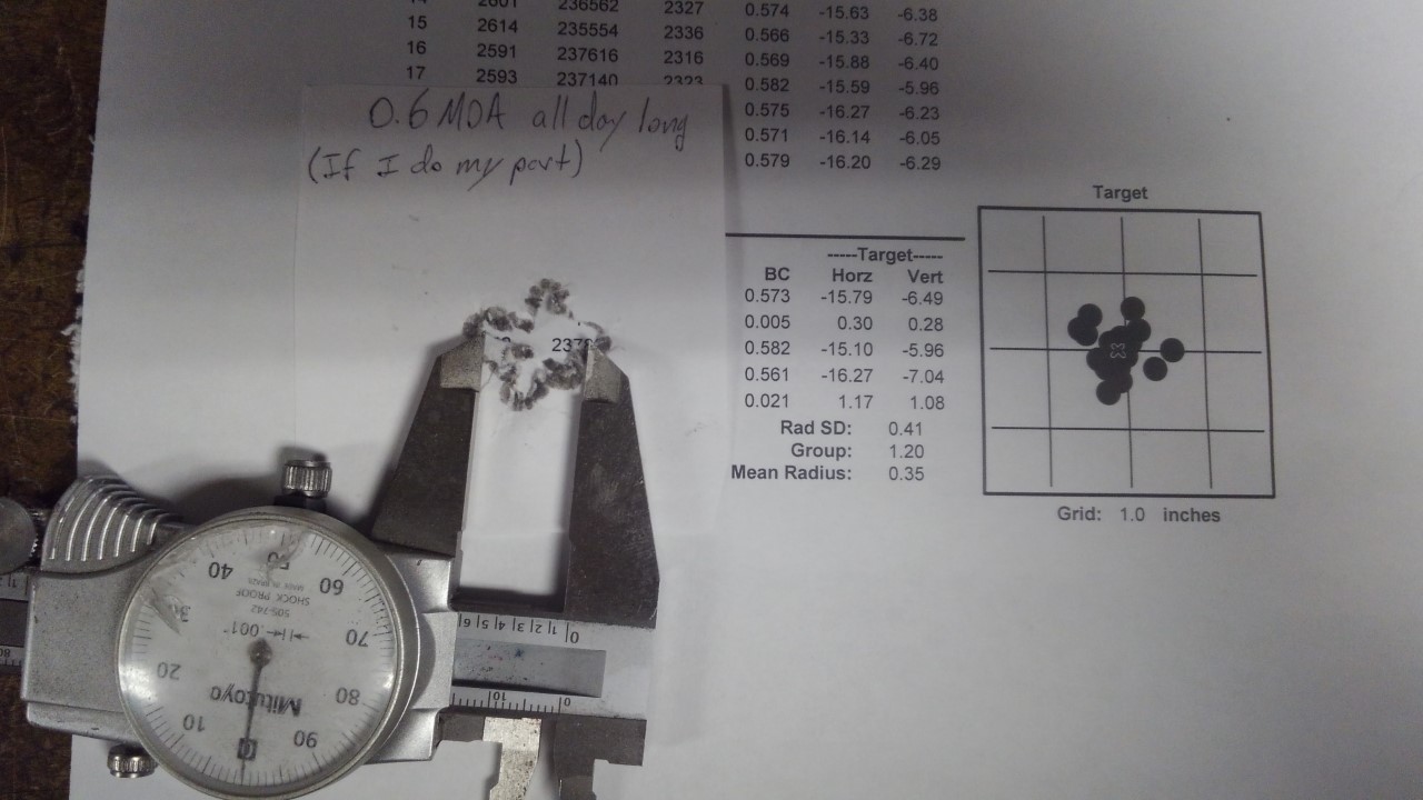

Ok, so now that I’m back home here is some information about the above target.
It was shot fireforming .223 AI, 69smk with 24.5 RL15. No load developent just started with a good load from another .223 and shot. Check out the brass.
You can see that the bigger dots I shot when the sight picture was good enough, as it got smaller I slowed up and focused a bit more. A big dot means a big group.
got to hand it to "real shooters" (not like me) that can shoot good 5x5s or 6x5s. i tend to screw up on shot #5.
btw, who chose 5x5, the hotdog and bun guys?

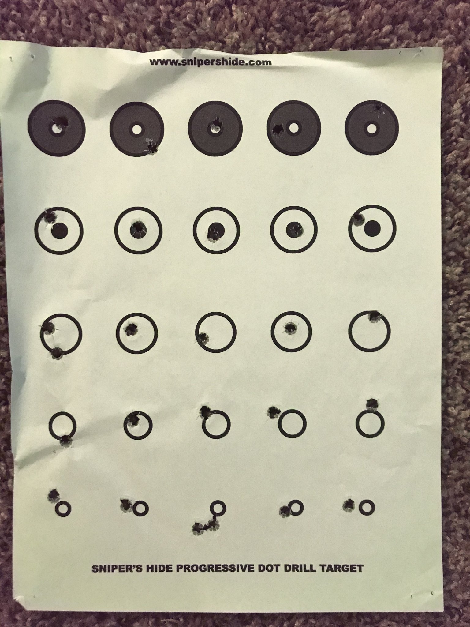

I had meant to run the dot drill tonight but didn't get to it. I'll try to get it done this week some time. Nonetheless, I wanted to see how I compare to the accuracy fixture I use in the large sample tests. This same load shoots 1.0-1.1" at 200yd in the fixture. I tossed the action in a chassis and put up paper at 100yd and let the accoustic target pick up 200. Take note those of you who think that group size somehow is larger at 100yd than at 200 or 300...
Reactions: DJL2
Reference target configuration, I have used coroplast backers, doubled them up via glue, fix a shoot n see target to them. Just keep patching the target via pasters and re surface with target if need be. Used one at the 600 locally and can track shots over a certain time period. It's best to look at the backside and make a note with a sharpie with anything wild or you can take a pic each trip. It is interesting to see the pattern, mainly wind calls. I have done something similar at closer distance by taking a sharpie, mark the outer corners and use the same target(replace target each trip), track over time via the backer pattern.
If this helps any?
Tried out the dot target. All prone shots. Top row is support side slow fire, second row is slow fire strong side, third row is speed drill (I jammed the gun after first shot so had to restart), fourth row is up and down with descending time limits of 15,12,10,8 and 6 seconds. Last row is slow fire prone. Took two shots at third target because first shot the round fed weird and thought it might have been something with the round, but it was just me.
