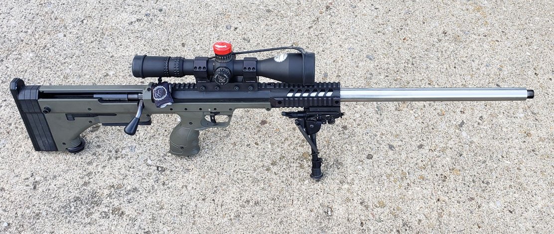

Received my Schneider blank on friday and just about have the barrel finished for my Desert Tactical SRS. I got some brass from Tubb along with the dies about a month ago. Right now I'm working with the Cutting edge Lazers as a friend has been dealing with them for his 375 Cheytac HTI and doing quite well out to 2700yds. I need to start looking at powders. Getting close.
Reading through I see a number of questions as to why someone would go with the 33 or 37 XC over one of the larger guys. I think the main reason is using an existing rifle. I can build a barrel for my standard SRS Desert Tactical rifle and not shell out another $5K or more for a custom 375CT or bigger rifle. I've got a few friends and customers in the same boat....waiting to see how this works out. With the switch barrel rifles its a no brainer to build a barrel to test the waters before jumping in. ELR takes some dedication along with the cash too. Looks like more math classes and calculations.....

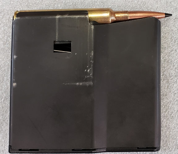

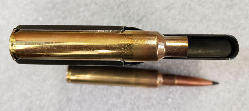

I know the 338 lapua AI can have issues because the shoulder is where the mag narrows down. The xc won't fit in the magazine.
Reactions: PowPowHawg
I'll have a look in a bit but I don't think the brass case will fit in the mag much less one with any bullet seated. Its pretty much a single feed setup and I bought it with that in mind. I tend to single feed anyway. I don't like the shoulder stop on the mag as it prevents a lot of other rounds from fitting like the 510 whisper. Overall length on the XC is a problem for the mag with or without the shoulder though so no mag feed I can see.
Frank
I did check the mag. The 33XC case will not fit in the mag due to the shoulder being ahead of the mag shoulder. Its too wide. The loaded round only hangs over a bit.....
I got the barrel done enough to test fire and check the chamber. It works fine and is good to go. I just need to engrave the cal and twist on it now. I hope to get started on load development this week. The barrel ended up 31" long and is heavy but I'm not going to carry it far. It doesn't tip the rifle on the bipod as some might think despite the length and weight...and the covert handguard.
So far so good.
Frank

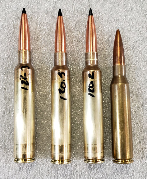

Got to shoot the new barrel today and learned a lot. I was running 250 Cutting Edge Lazers to start while waiting for the 265's to get here. I started at 120gr of Reloader 33 and worked up to 123gr. ES started at 70fps at the low charge and got down to 4fps with the 123 gr charge. Groups were tightening up too. I think I'm going to go a bit higher on powder and see how that goes. No pressure signs so far. Velocity at 123gr average was 3388 out of the 31" barrel so not too far off Tubbs results. The Desert tactical rifle shoots great with this barrel and with the 70MOA scope mount I've got 120MOA of adjustment up while shooting dead on 3.4 MOA off the bottom stop at 100yds.
I also tried a couple strings of WC868 and WC872. The 868 looks promising with 3350fps avg of 5 at 120gr and no pressure signs. The 872 looks a bit off running 3150fps avg of 5 with no pressure signs. Maybe its too slow? Groups with these two were not bad but I knocked the ammo box off the bench and broke the plastic tips on a couple bullets when it hit the ground. Not a very good test.....

Got to shoot again last weekend and had some odd results. I switched from the 250 gr Cutting edge Lazers to the 265 gr. Started at 123gr of RL 33 and went to 124. Average vel on the 123 gr load was 3462 but the ES was up there over 80. Group was about an inch at 100. I had problems with the 124gr load piercing primers which is something I'd not seen since I bought a mauser with a broken firing pin in about 1976. Primers weren't flat, no sign of ejector pin flow or any other high pressure signs. I'm wondering if its a Desert Tactical problem with the tiny firing pin in the too big hole in the bolt face or is high pressure something that would do this? The little slugs from the primer jammed up the firing pin so I had to take the bolt apart after every shot. Not an easy thing with a gen 1 bolt and after 3 rds I stopped. The firing pin was a little rough so maybe it was damaging the primer?
Anyway, I also tried the WC868 loads at 122 and 123 gr. They were quite a bit slower than the RL33 at 3360 for the 122 and 3370 for 123 with an ES of 15 for the 122gr load. I'll fiddle with this one a little. It might be better to be consistent than fast. No pressure signs with these but oddly the last round fired had a pierced primer.

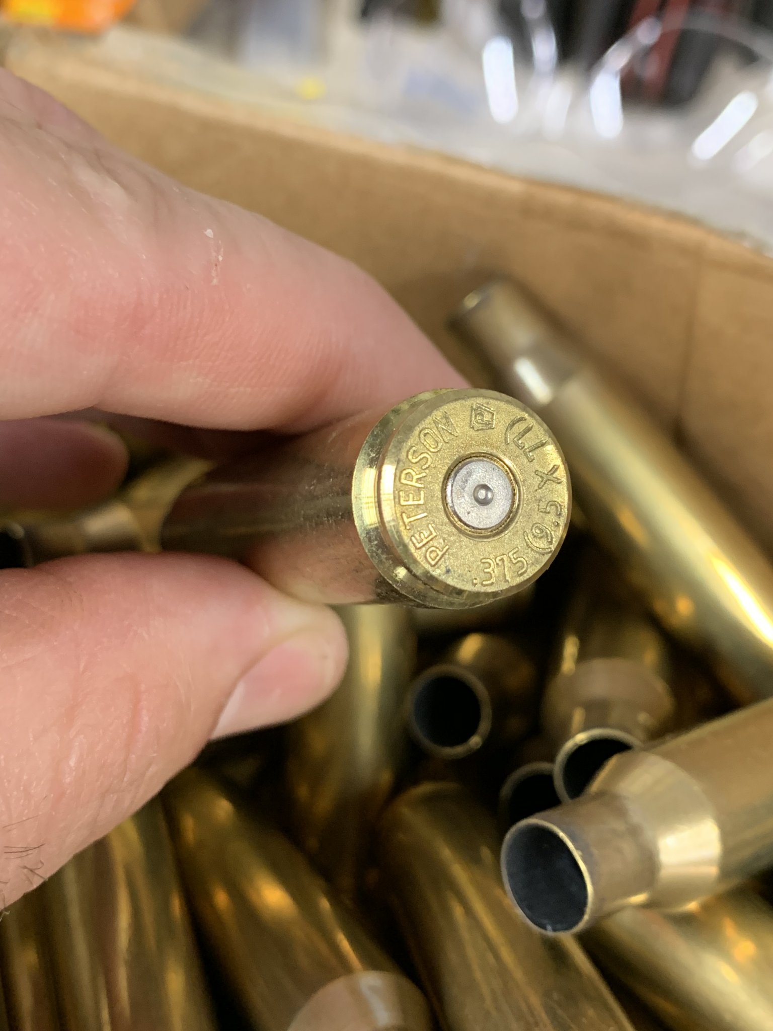

U can get Cheytac cases with rebated rims for the Lapua .585 bolt face...I believe Peterson. The reason Dave developed his new case is the Cheytac case was designed for the .408 and at .375 it is way overbore and u end up with a cartridge that has a low fill ratio with higher peak pressures. So, overbore, poor fill ratio, and high chamber pressure all lend themselves to less chance of broad stable nodes which equate to high ES and SD equalling poor accuracy at range. His goal was to design a cartridge with perfect fill ratio for .375 that's optimized for modern powders like H1000 that are less temp sensitive trying to get the best ES/SD
They exist. I have 230 of the 375 CT with the Lapua boltface that I’m not going to end up using. Peterson did these for Tubb and I got them from SSS (Tubb) a while back. I’ll probably throw them up in the Reloading For Sale section soon as I’ll end up going with the XC down the road.
