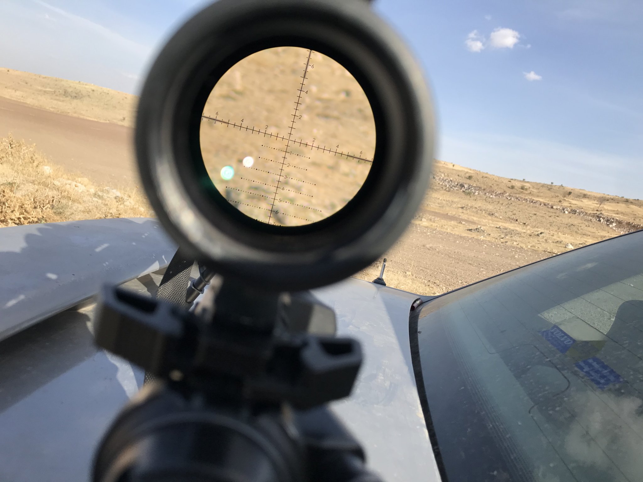

Hi everyone,
i wanted to share and take some advice for some nightmare i’m having for last couple week,
i decided to get a budget scope as the athlon argos btr 6-24x50 ffp but the seller encourage me to get the vector optics marksman 6-24x50ffp. I got that and mounted without bedding and noticed that my parallax knob got stuck and the clarity died after 15x mag. Then i took it back to the dealer and i said i don’t trust vector optics anymore so i paid little bit more and changed with vortex diamondback tactical 6-24x50ffp. I was happy but i spent twice as my budget. Anyways i mounted it about 18 inch pounds and the exact same problem occured. Mailed to vortex and they forwarded the situation to distributor. Changed the optic immediately with the same.
Mounted again and torqued with about 15 inches pound and try to feel how parallax knob was free. Heard a ting! Inside of the scope! Stopped and untightened the screws and check the knob was ok.
Went shooting and parallax started to focus at higher ranges (like target @100m knob focuses at apprx. 300) then checked the 200m target with 24x guess what? Bloody blurry vision!
called the seller guy and replied like “ what the hell? Its been about 30 years in the sector and never heard a problem something like you are having?” Noticed that im all alone now. Tried to mail the distributor about the problem but no return yet:( i m pretty sure that my scope mount ruined 3 scopes in 2 weeks but i have to solve the problem. Sorry for the long story but i need some help because i m about to cry and that scope costed me about 1,5 times of my salary. And i feel pretty shy to talk with the dealer and the distributor. Im from Turkey btw. It will not so easy to send it to the vortex to be serviced.

so, the million dollar question is what rings are you using that hosed up three scopes in quick sequence?
Thanks for replies, yeah it can be said that the mount crappy. the vector optics one piece ar type one. six screws per ring.
But in Turkey these mounts are classified as “standard” or “useable”
Brother, I’m no expert but the only constant is the mount, really probably the ring part of the one piece.
sounds like you managed to screw up the tube/erector in three different scope. Has to be the mount as Vortex’s torque spec is indeed 18 in/lbs. inch/pounds, not foot/lbs...right?
send it back to Vortex. They cover anything under warranty.
an idiot friend of mine (well, no more of an idiot than I and the rest of my friends) fell out of a rusted tree stand and mangled his leg and the Viper onhis rifle. He was honest and told them exactly what happened and asked if they could repair it and he would pay. They sent him a new scope under warranty.
AND DO NOT PUT ANOTHER SCOPE IN THAT MOUNT. Haha
take a hammer to that mount and beat it into junk.
my suggestion is to look at a good quality mount. Since you like one piece, Spuhr comes to mind. Lots of decent ones out there to include Leupold, Vortex, Badger, really tight stuff, etc. but these are not inexpensive.
others here who know more will most likely have more and better suggestions.

I bet you money you are torqueing it ft/lbs instead of in/lbs...or if you are in metric...I bet your values are off...
Get a fat wrench....stay away from junk Chicom stuff unless it comes from a reputable company like Vortex or Primary Arms...
