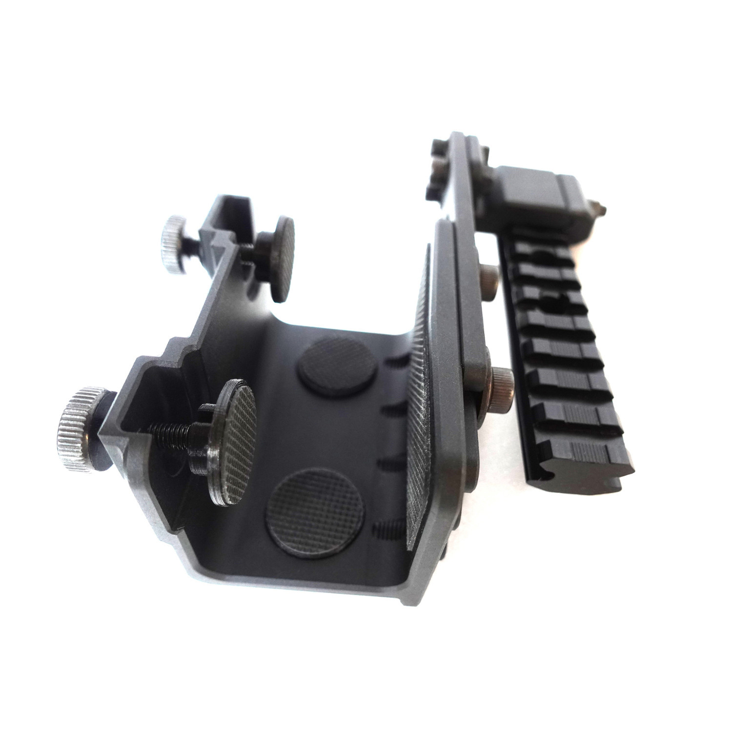

Hey OP, I also was looking for a poor's friendly WMLRF and found the Sightlok RF-1 recently.
It allows you to mount whatever rangefinder you currently use to your rifle and it comes with windage/elevation adjustment capability.
It's been working for me on a .308 using a Sig BDX rangefinder, but the risk with this option is that commercial rangefinders are really generally not designed to handle heavy recoil, so depending on your caliber, you could potentially kill your rangefinder.
All I can say is it has been working in my case.

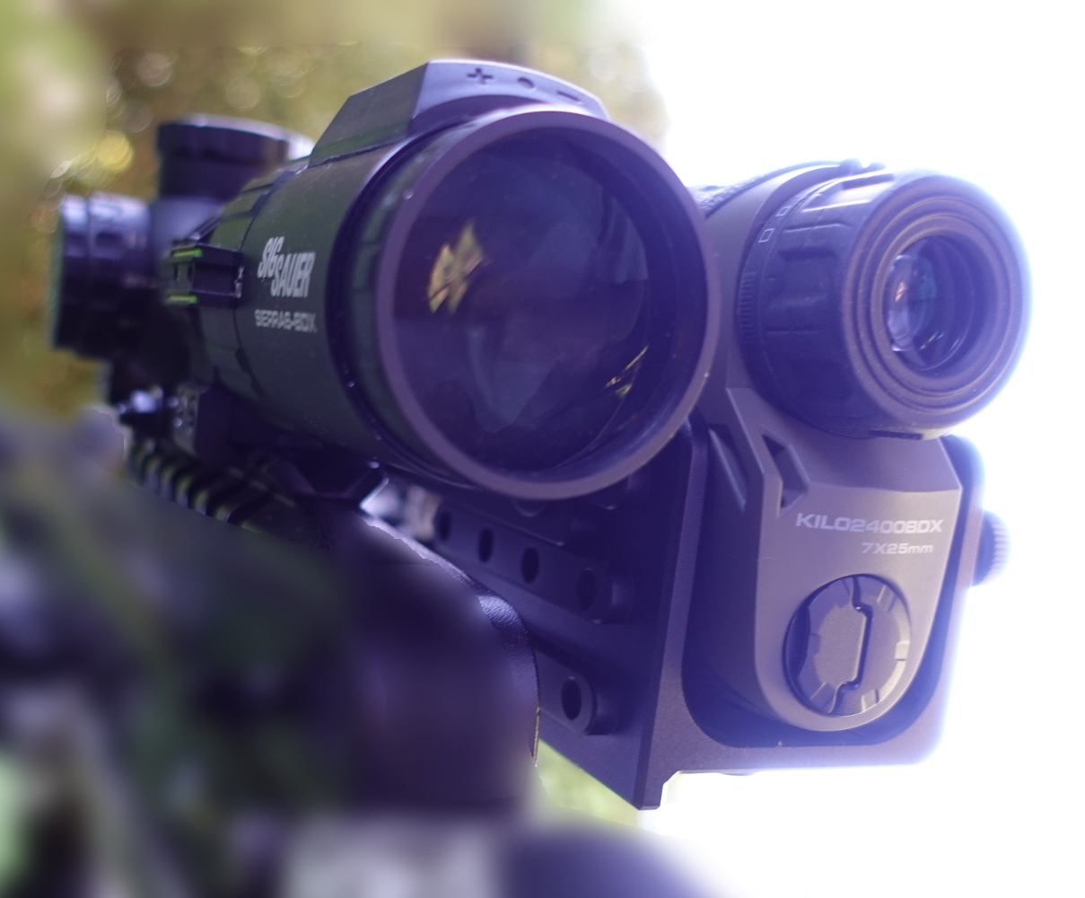

I'm also using the Sightlok RF-1 with a Sig KILO2400BDX rangefinder. I'm a WMLRF geek and own a couple of the available WMLRF options, including a Vortex Impact 4000 and a Wilcox RAPTAR, and I use the Sightlok over those options, even though it's a less expensive solution.

I'm also using the Sightlok RF-1 with an Sig KILO2400BDX rangefinder. I'm a WMLRF geek and own a couple of the available WMLRF options, including a Vortex Impact 4000 and a Wilcox RAPTAR, and I use the Sightlok over those options, even though it's a less expensive solution.
How do you see the little LRF display when behind the rifle?
Reactions: 338_Lapua
Wait, I was looking at the pics wrong. So one can align the LRF eyepiece to be right next to the scope’s ocular “plane”.
I see now how it could possibly work. Hmmmm I have an unused Leupold 2800 unit hmmmm
Right, and you can orient the rangefinder either on the left or right side of the scope. There's a fair amount of adjustability.

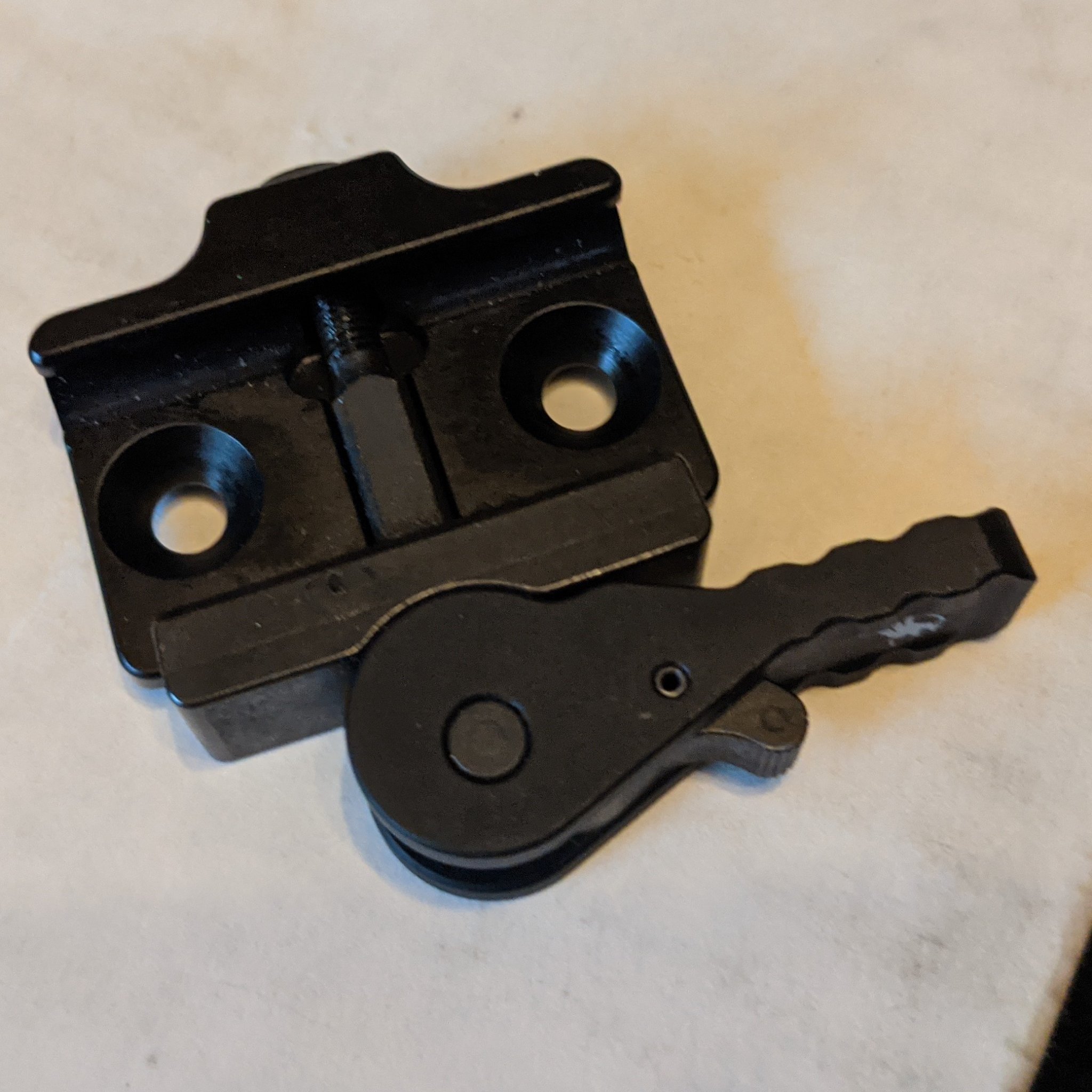

However, it doesn’t appear that the Sitelok has a way to mount to a vertical pic rail (or at least they don’t appear to show that).
Perhaps I missed something, but I don’t see an easy way to mount a pic clamp on the side of the Sitelok. Like the ADM mount.
That’s their 17s model, but they make a dizzying number of different interfaces.
So my question to you is, do you know of a pic clamp that will mount to the side of the Sitelok? If you don’t I can inquire with the manufacturer.

To clarify, our response to @carbonbased was roughly as follows:
The design objective of the Sightlok RF-1 was a universal rangefinder mount that offers enough flexibility to get around obstructions and address limited mounting points, left- and right-handed shooters, various rangefinder shapes and sizes, a wide range of scope lengths, and so on. Simply put, the goal was to allow the shooter to place their rangefinder where they wanted it.
Our current gen 2 design allows the mount to expand and contract in length, offers 3 different height options, and 3 different gap widths between the mount and the rail. It can be mounted on the right or left of the scope, and it can be mounted with the arm facing forward or aft.
Our engineering team considered a wide range of standards, including the 17S standard, during the design process. The problem with the 17S standard in particular, is it expects the clamp side to be "female." And if you accept female on the clamp side, you cannot achieve mount points at 3 different heights on the U-shaped LRF holder, which is flexibility our clients need.
If we have misunderstood how a 17S standard could be accomplished and still achieve mount points at multiple heights, perhaps @carbonbased you could sketch how that would work. We're always open to improvements in our designs.
Thank you for the opportunity and hope that was helpful.

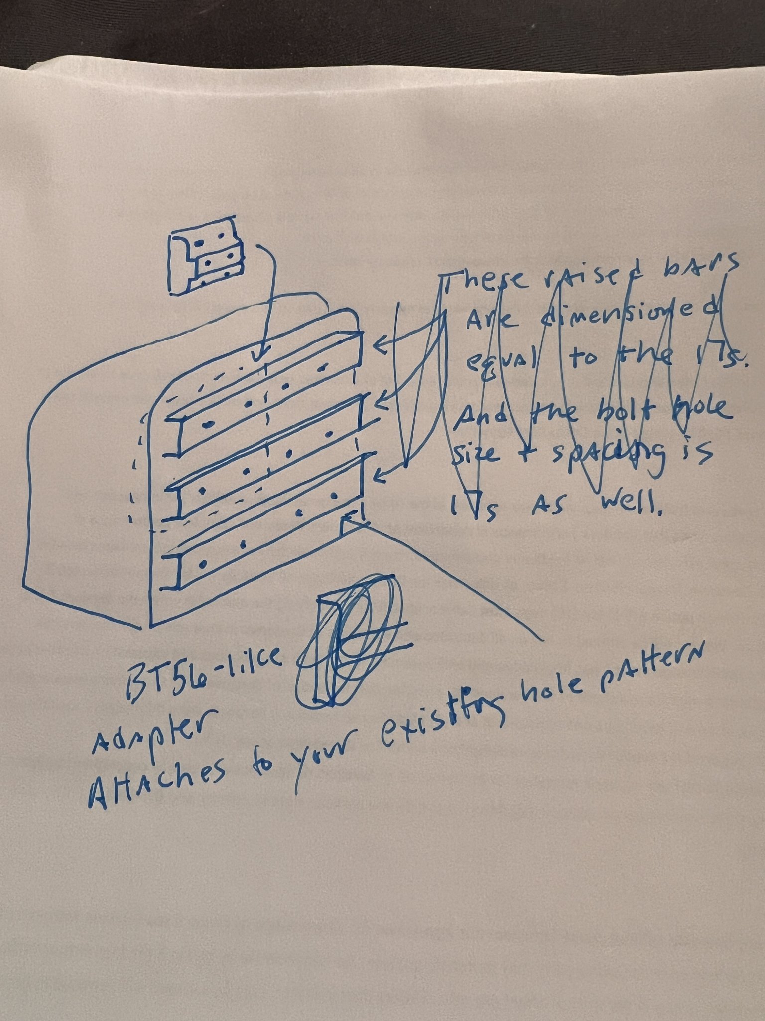

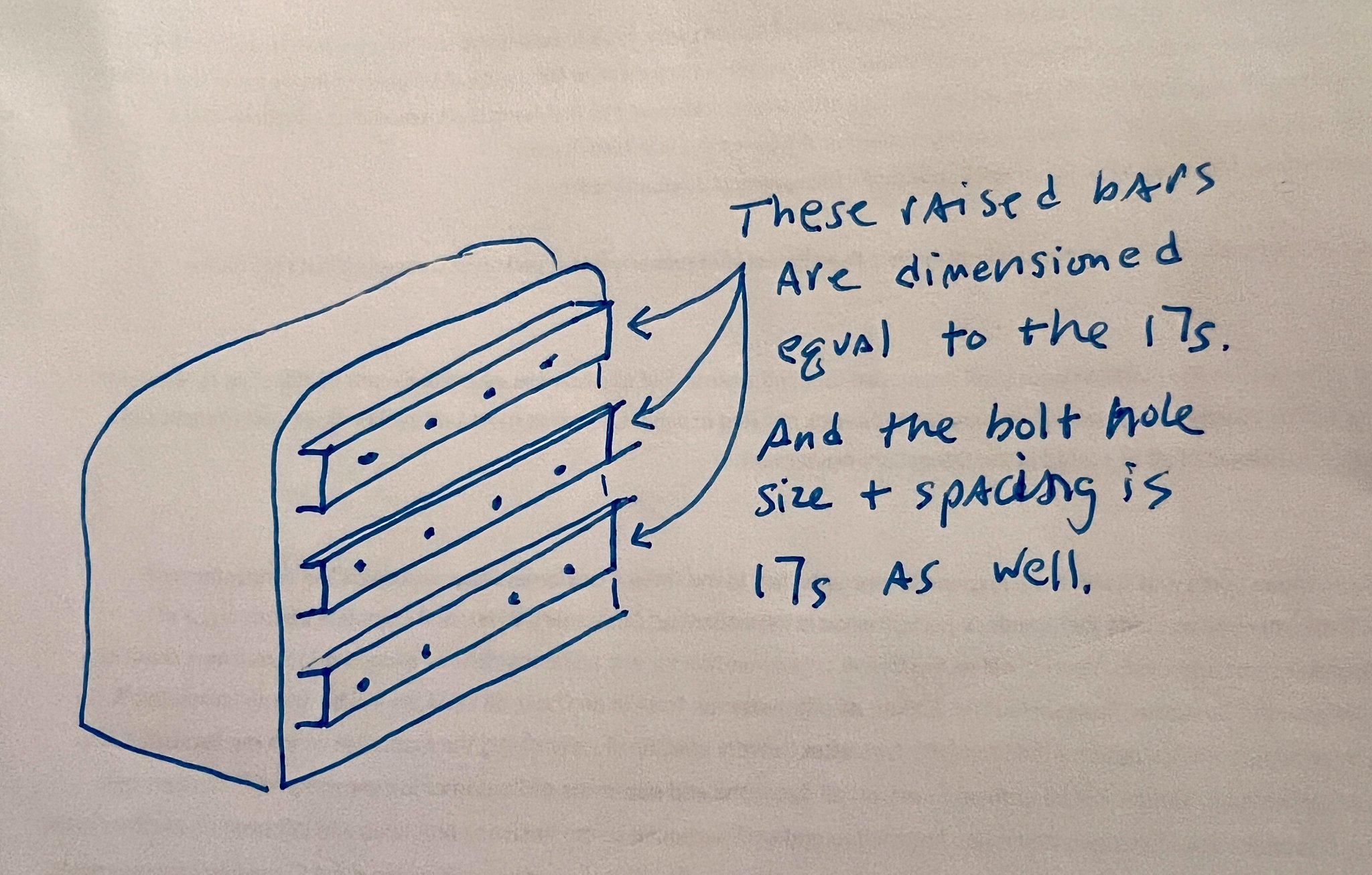

Hey! Nice chatting with you over email!
This is what I’m talking about.
Adjust the raised “bars” to mimic the 17s male bump. And adjust the screw holes and spacing to 17s spec too.
Then a 17s clamp will screw right on, and your existing tuning fork bar should might also work, especially if you deviate from the typical depth of the 17s male bump. Edit: or use a slightly different pitchfork clamp method.
Does this make sense? It’s probably dumb.

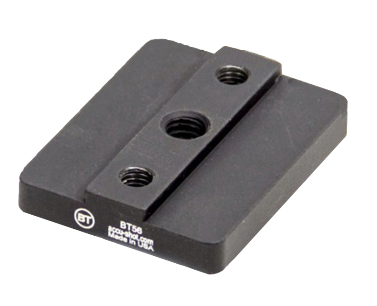

Or, here’s an easier solution.
Just machine an adapter; a plate with a single 17s male bump that screws onto your existing hole pattern.
Then one can just screw on their chosen 17s clamp.
The adapter would look like this, but imagine it without that 1/4-20 hole in the middle and screw holes that attach to your screw hole pattern.

Right, but the 3 male rails above are not going to mesh with a female 17S spec rail mount, as shown below:
These 2 parts will not fit together.
The only way the two parts would fit together is if we eliminated all but 1 of the rails. Then the two parts could be connected, but that would be a signification reduction in adjustability.
They would if the male and female rails & channels are all 17s spec.
You might need to make the walls of the U-shaped adapter taller to accommodate three 17s spec rails.
But just making the adapter I mentioned afterwards would be easier and you wouldn’t have to redesign your system.
Right, with that additional part, something like what you're suggesting might be be feasible. It's potentially a good idea. Just depends on the number of people seeking that type of option. Please allow us some time to discuss this internally and get back to you.
Thanks very much for your time and the suggestion!
Reactions: carbonbased
Right, with that additional part, something like what you're suggesting would be feasible. It's a good idea. Just depends on the number of people seeking that type of option. Please allow us some time to discuss this internally and get back to you.
Ok, whew, I’m glad we finally communicated. Hard to do without speaking or without drawings, eh?
But the little adapter idea is probably way easier. Or make a clamp that conforms to your male bumps and female channels.
Anyway, good brainstorming with you!

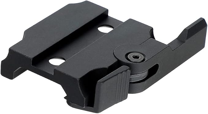

One potential issue with mounting at that point is that the U shaped mount would probably bump into the scope (meaning some kind of offset would probably be required). And if I'm not mistaken, the mount bolted at that location would probably not have your rangefinder on the same optical plane as your scope.
The best adapter I can recommend if you only have a vertical pic rail, is a "Picatinny 90 Degree Angle Mount" (B007AO0SPQ on Amazon), and then you have none of the above concerns.

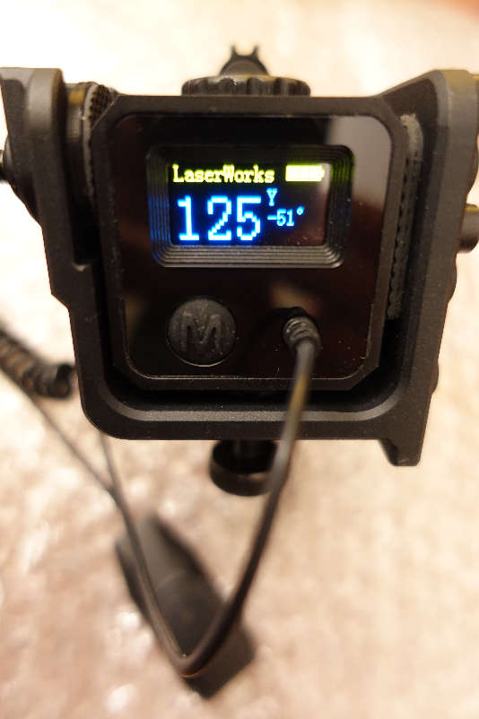

But to me, it seems awfully simple to smash one of the thousands of low budget LRFs into an aluminum housing that’s mountable.
OP, getting back to your original question and your point above, Laserworks, the Chinese company that makes a lot of the cheap rangefinders you see on Amazon, did exactly what you're describing. The product is called the LE-032. I'm not endorsing it, you'll definitely want to read all positive (and negative) reviews for it before buying, but it's on Amazon, costs about $170, and there's a bunch of Youtube videos about it. As I said in my earlier post, the main flaw with it is the mount, but you can mount it with a Sightlok RF-1 and that will solve at least the mounting problem.
And when it comes to co-witnessing (zeroing) it with your scope, you'll probably want to spend another hundred or so bucks more and get a clip-on digital nightvision scope so you can see the laser and use the elevation/windage knobs on the Sightlok to line things up.
