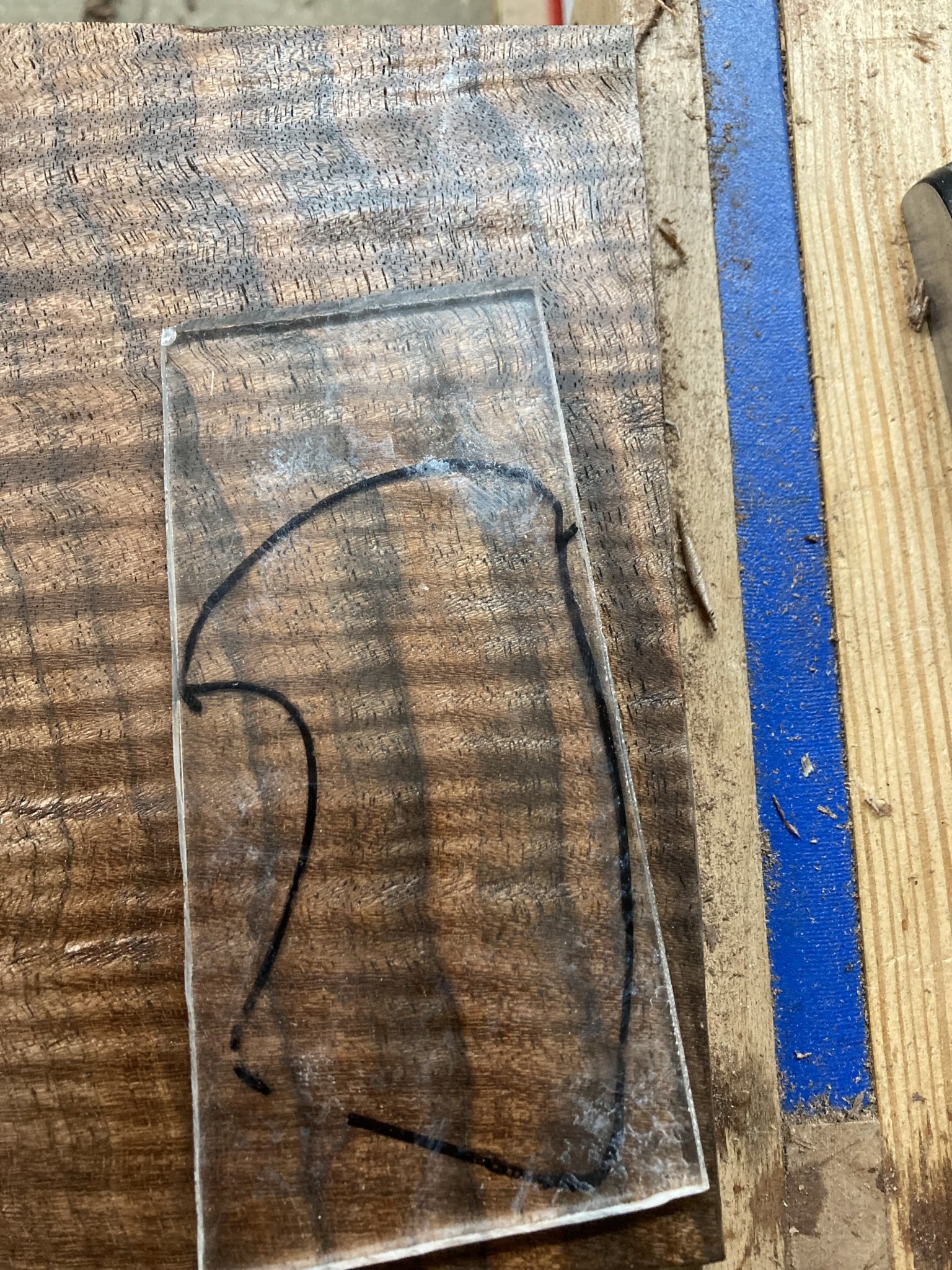

Picking layout for these custom grips for a 6 ft double ended dildo:
Hmmmm. Match the vertical mineral lines or the horizontal curl…damn you Mother Nature!

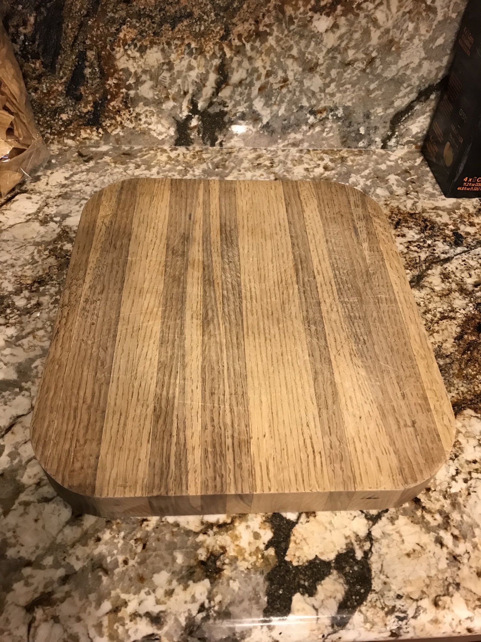

Nope, going by what I was told. I wouldn't know the difference if my life depended on it.
What do you think it is?

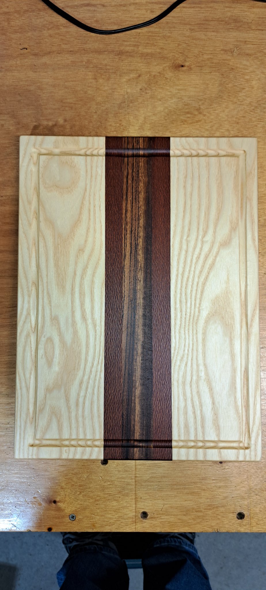

My first impression would be 'white oak', but I am NOT the resident woodologist here.
Looking at other internet pictures of fresh cut cherry it doesn't look too off.

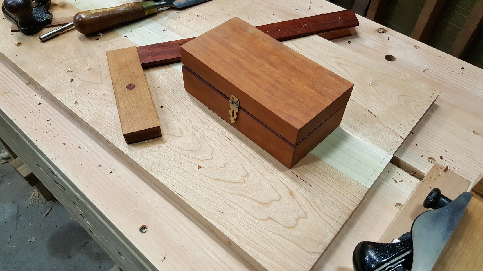

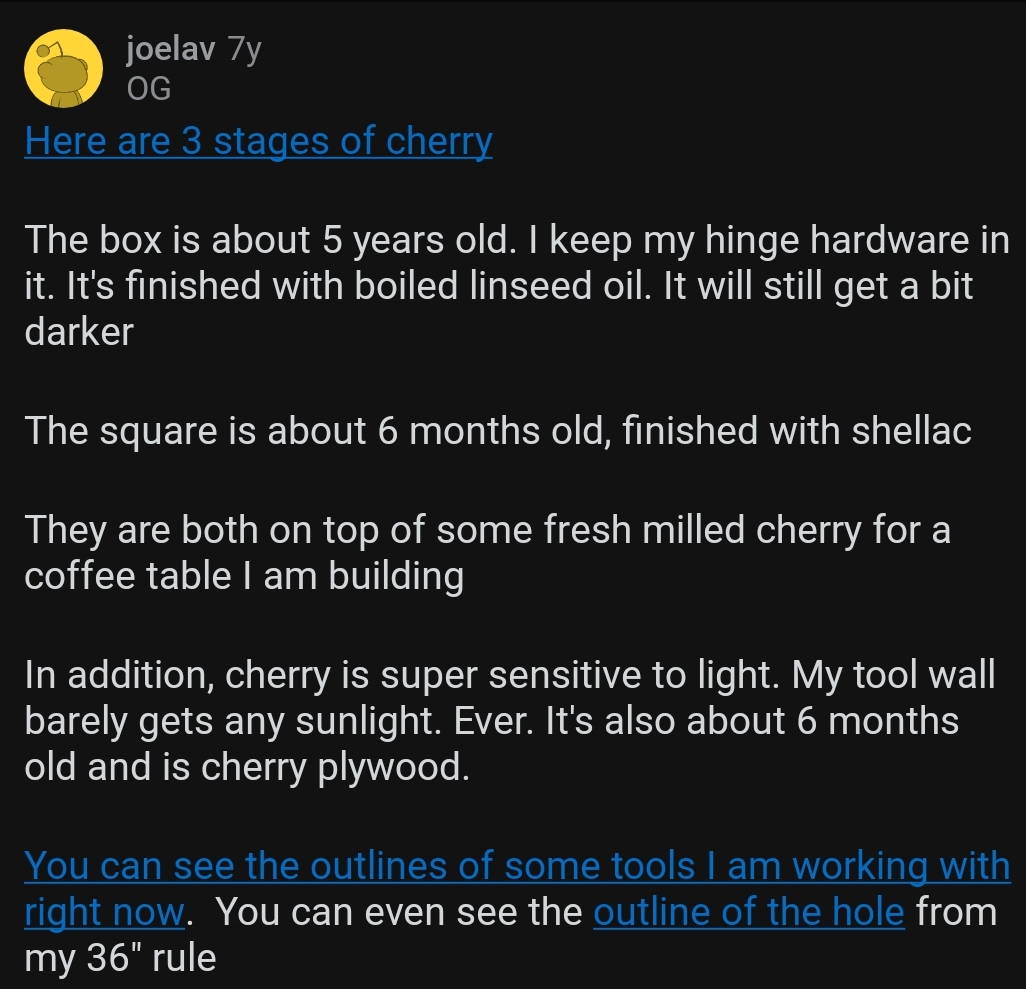

Found this on reddit.
Description of pic

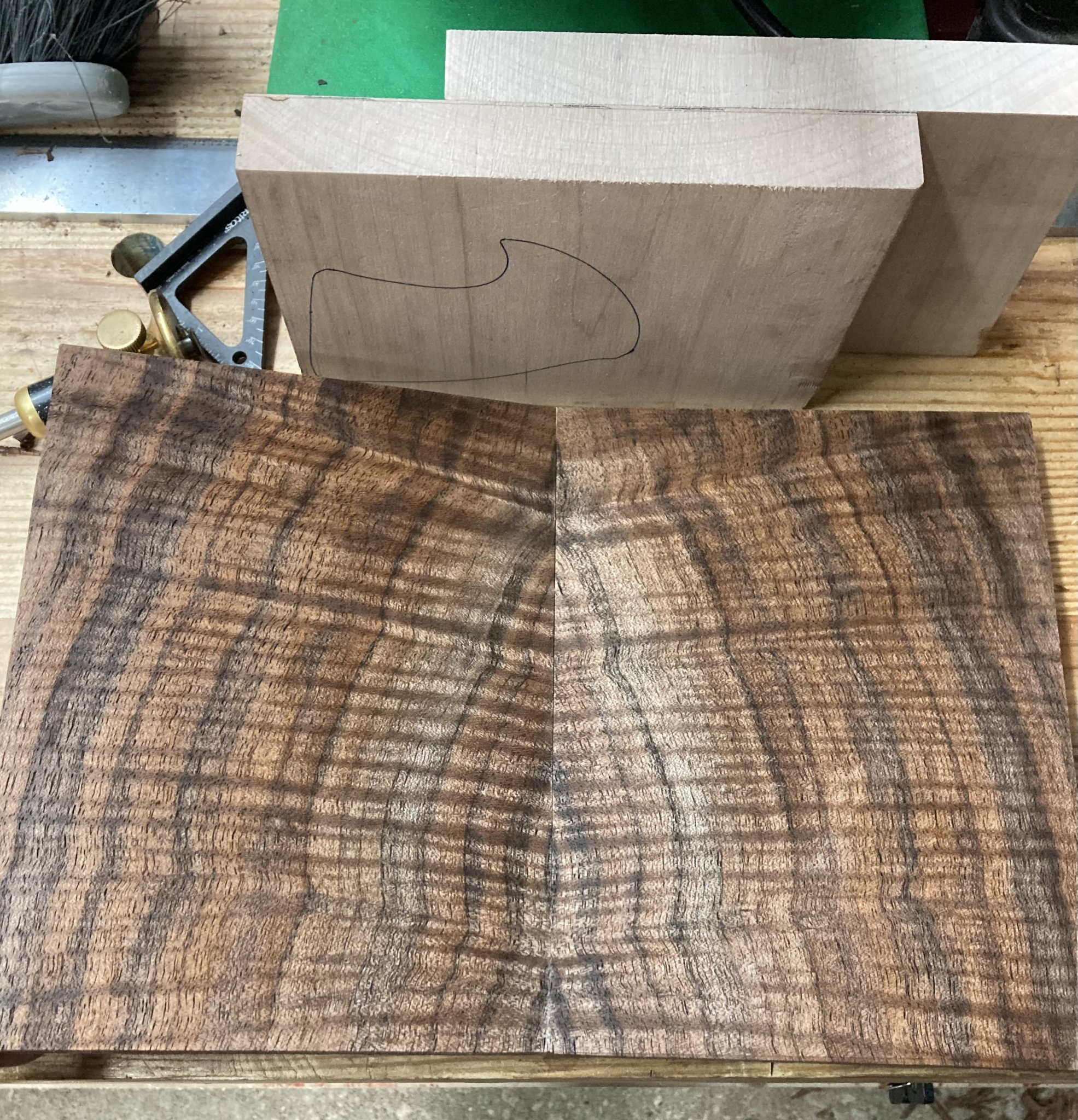

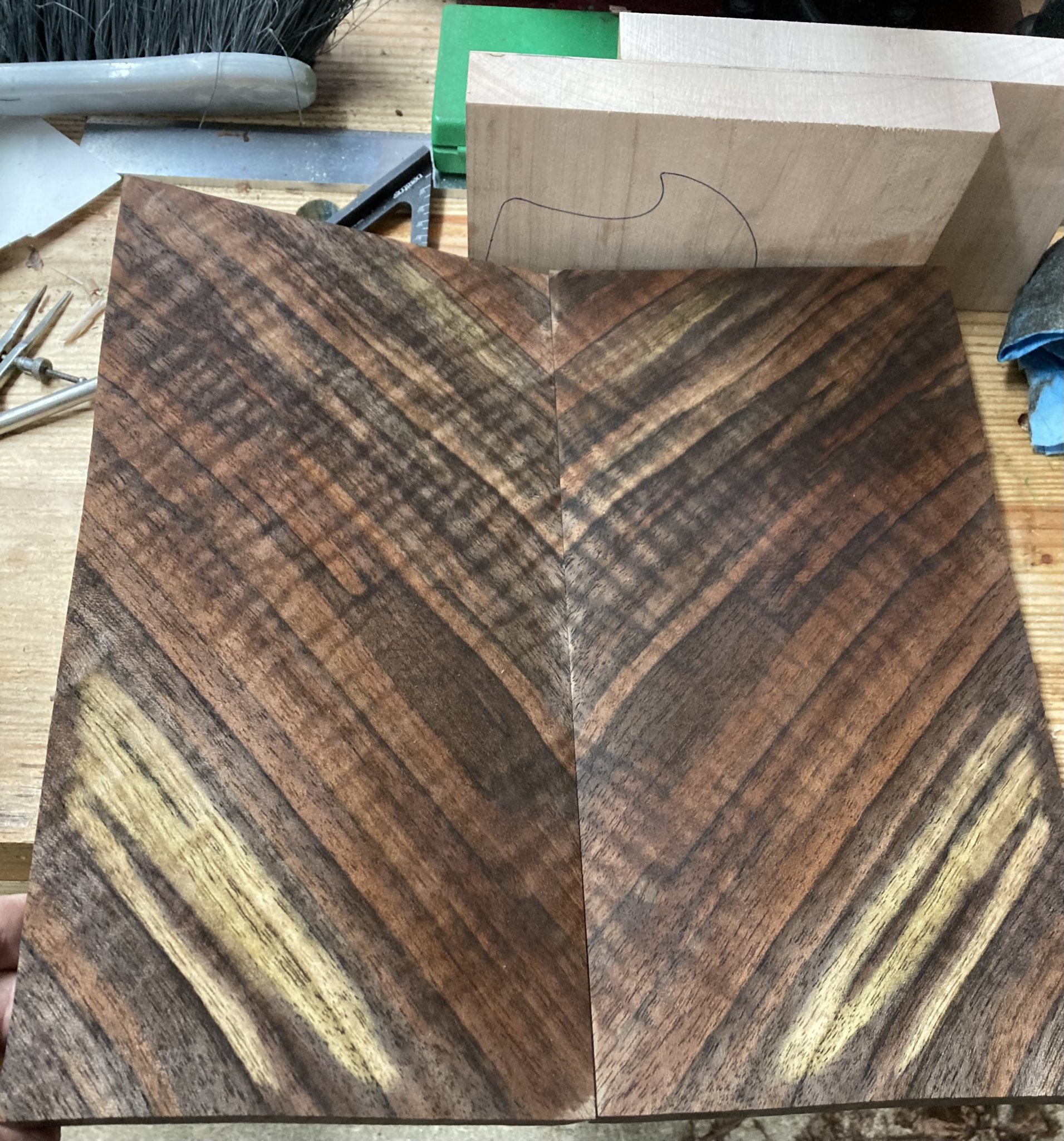

Re-sawed some walnut blanks to give them time to move around before Inwork them next month. Got some excellent book match and color.
This is the inside of the block I showed a few posts back. Wonderful match of grain, color, and curl. I was a bit nervous it wouldn’t book match, but I was pleasantly surprised. These will be for the set of Python grips I’m working on:
These are the other block I cut. There is so much color in this set, but not as much curl:
Oak will have lines looking at the end grain on a board. They'll stand out generally going perpendicular to the growth ring grain. In the face of a board, oak will look very porous in the rings.
Cherry will not look porous at all.
I do believe from your picture your "cherry" should be oak.
Reactions: bkglock
Doesn’t look like cherry to me. As others have said, it’s to porous for cherry, but also as others have said, Mother Nature will throw you a curveball every now and then. Regardless, the boards came out beautifully. And those grips are going to be gorgeous!
Reactions: bkglock
Should have clarified myself. I was referring to the picture of the wood with the box sitting on it. The other picture is definitely not cherry. Its a diffuse porous wood which cherry is definitely not. Sorry for the confusion.

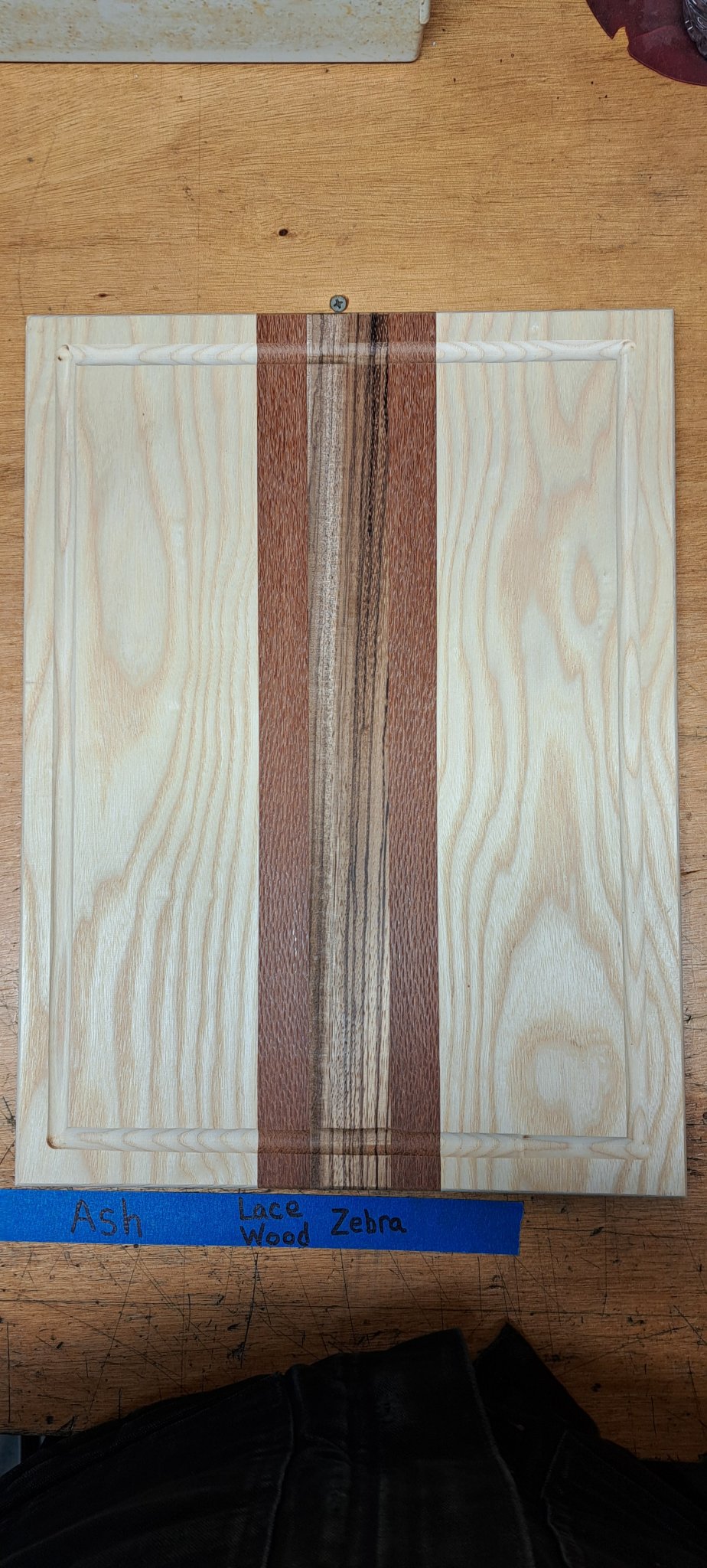

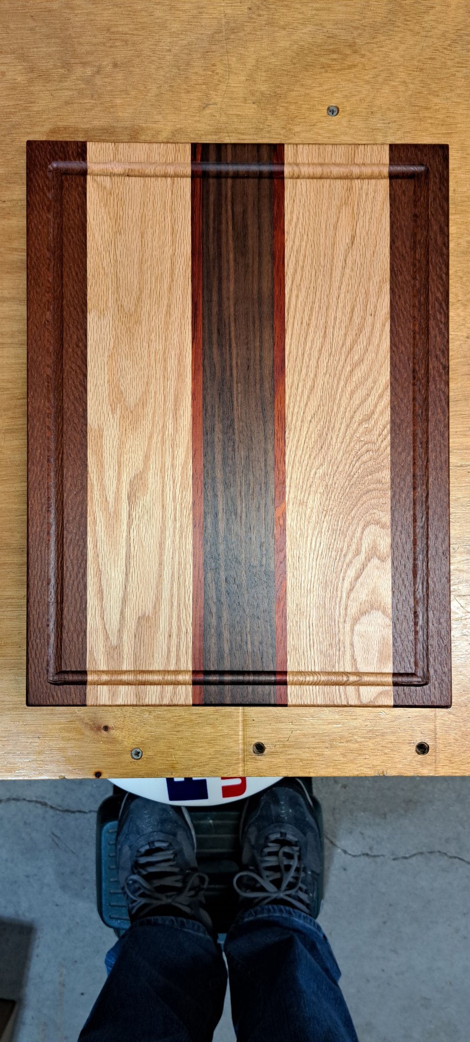

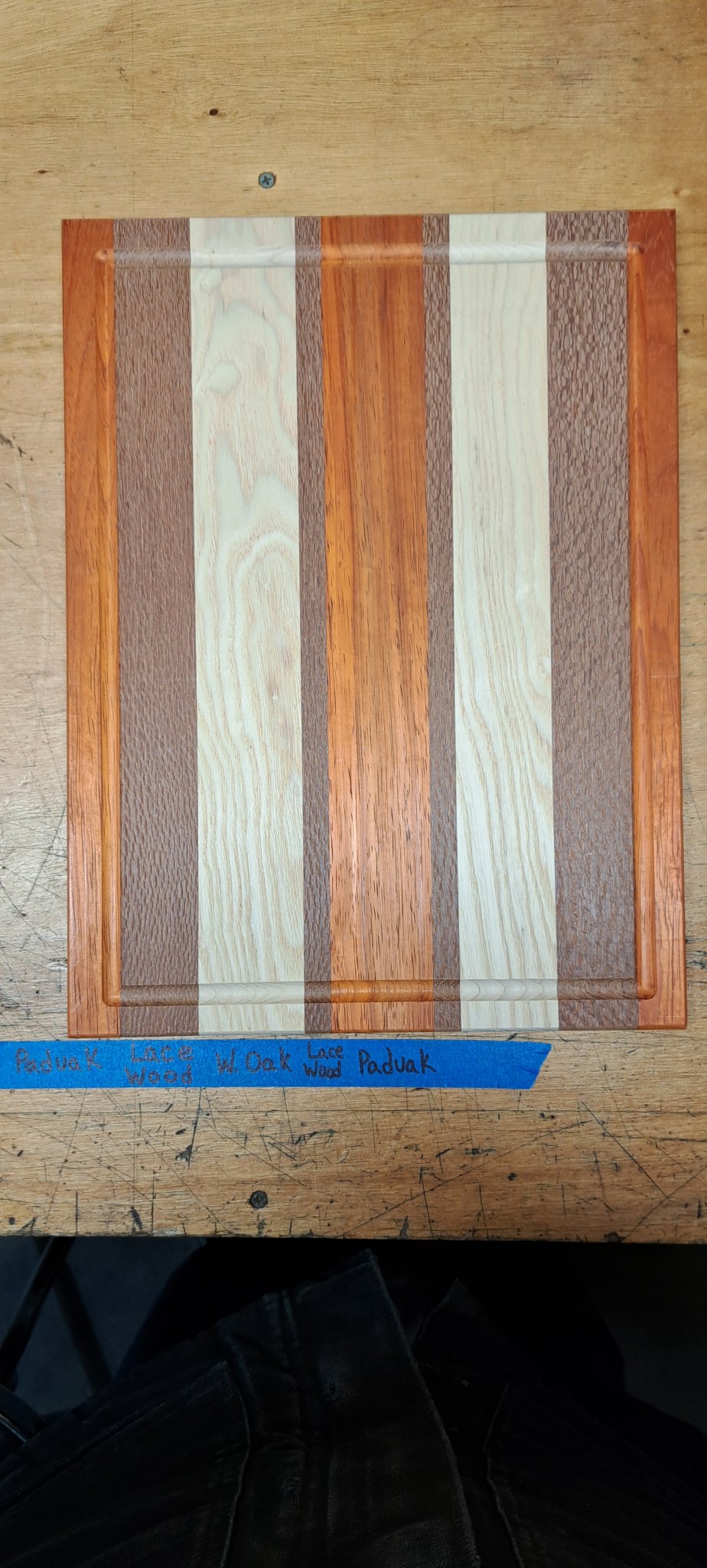

Very nice! BTW: for the blonde wood, photo 1 and 2 make me wanna guess Ash, but photo 3 (if they're all the same wood...) looks more like Oak (actually looks like Red Oak, with the finish on it.) Either way, definitely not Cherry ;)
Reactions: bkglock
Light colored wood in photo one is Ash.
Light wood on second board is White Oak.
After speaking to my friend, he thinks the wrongly labeled Cherry is Red Oak.

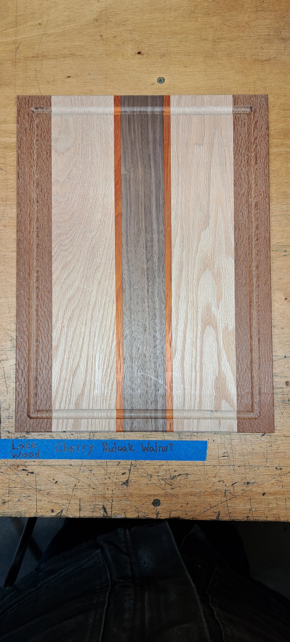

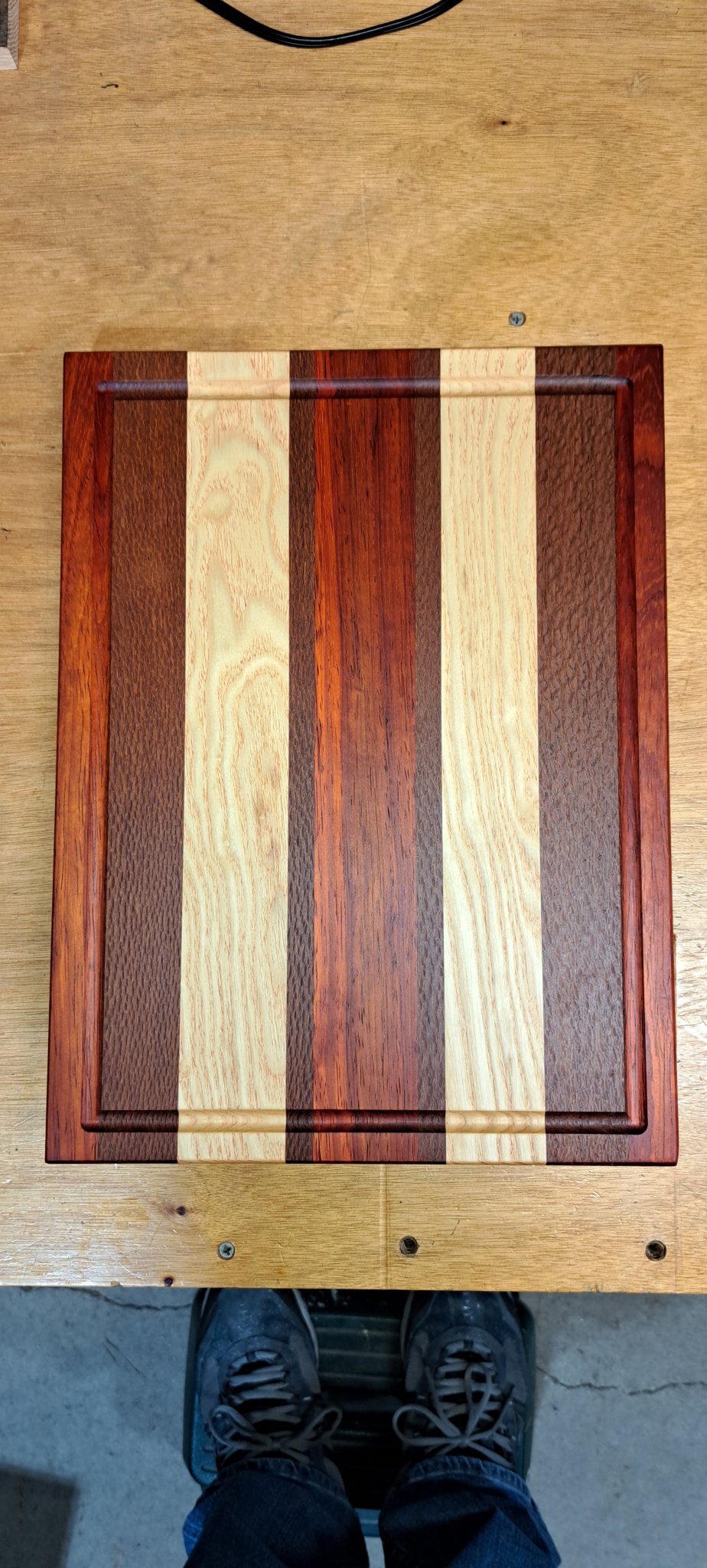

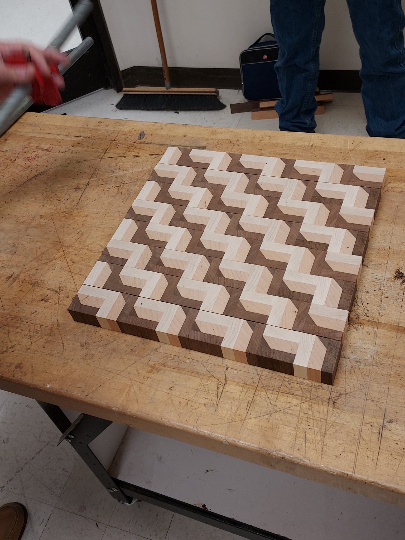

Went and took a class and made this today. Severely suffering from information overload. Many small steps that all get put together, and they all have to be just right or it won't work in the end. This is before final glue up, so don't bust me about the seams. Overall it was a great class and I learned a ton.
That's one hell of a board.
I can just imagine what the chess pieces are gonna look like!
Wow, what a cool use of grain
I’ll be honest, I never once looked at the grain. You are cutting pieces, and glueing them into blocks, and cutting the blocks and inverting pieces and glueing them into bigger blocks, planing them square and then cutting them into strips for the final glue up. I couldn’t have kept up with the grain if I tried!

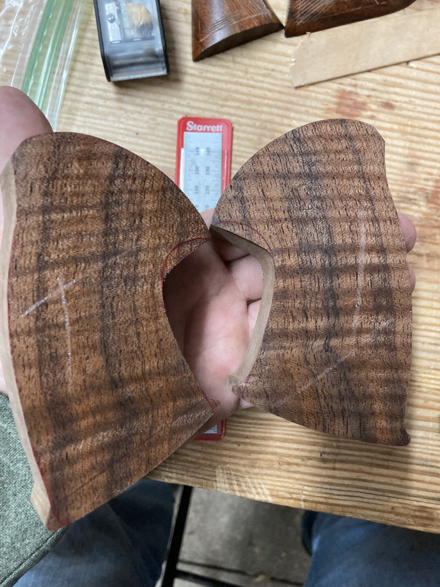

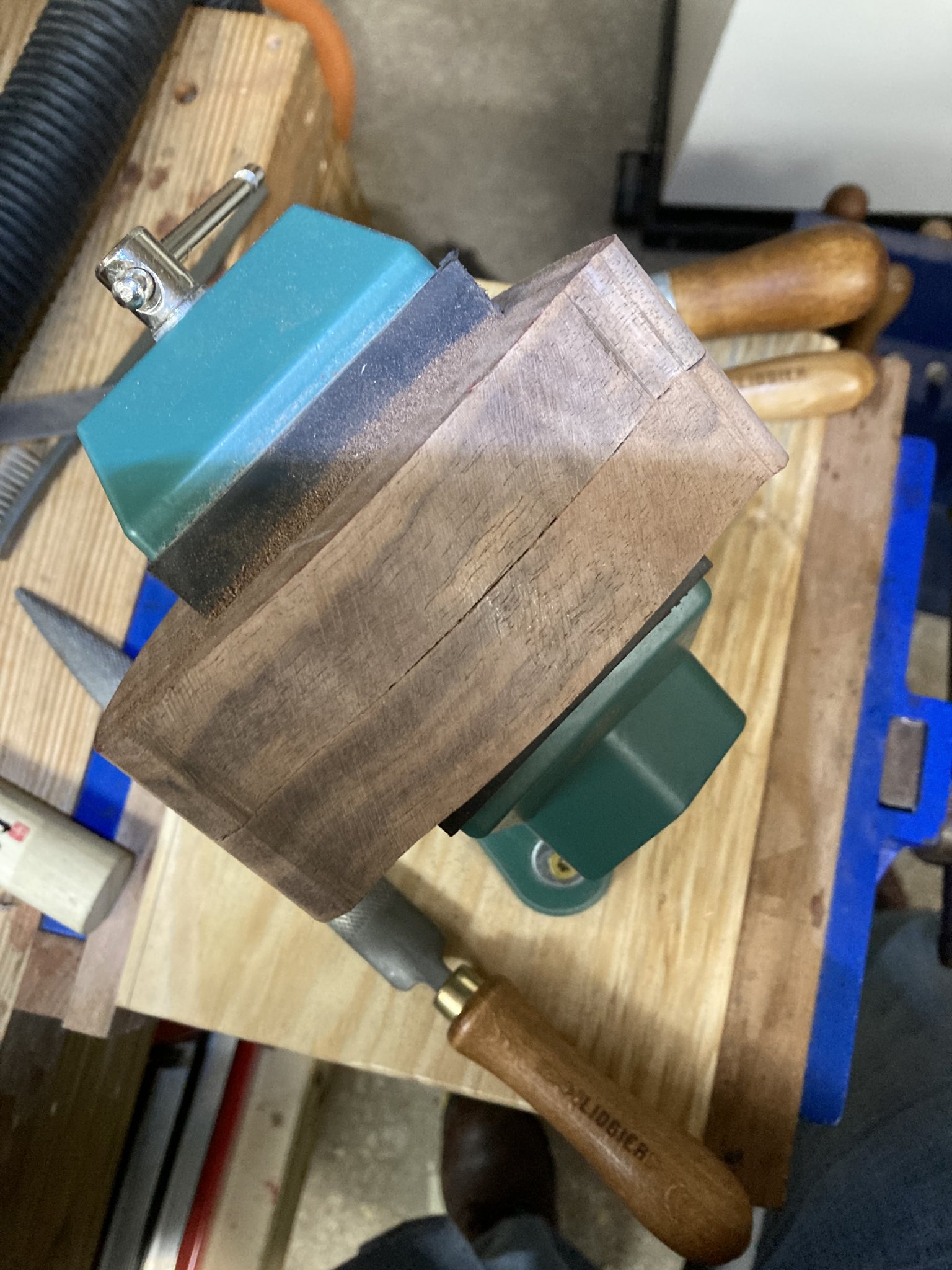

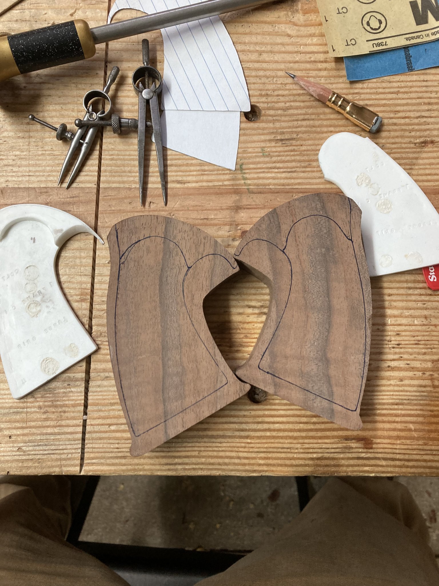

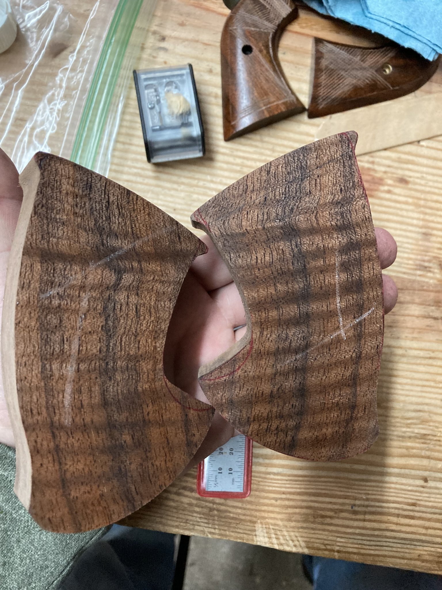

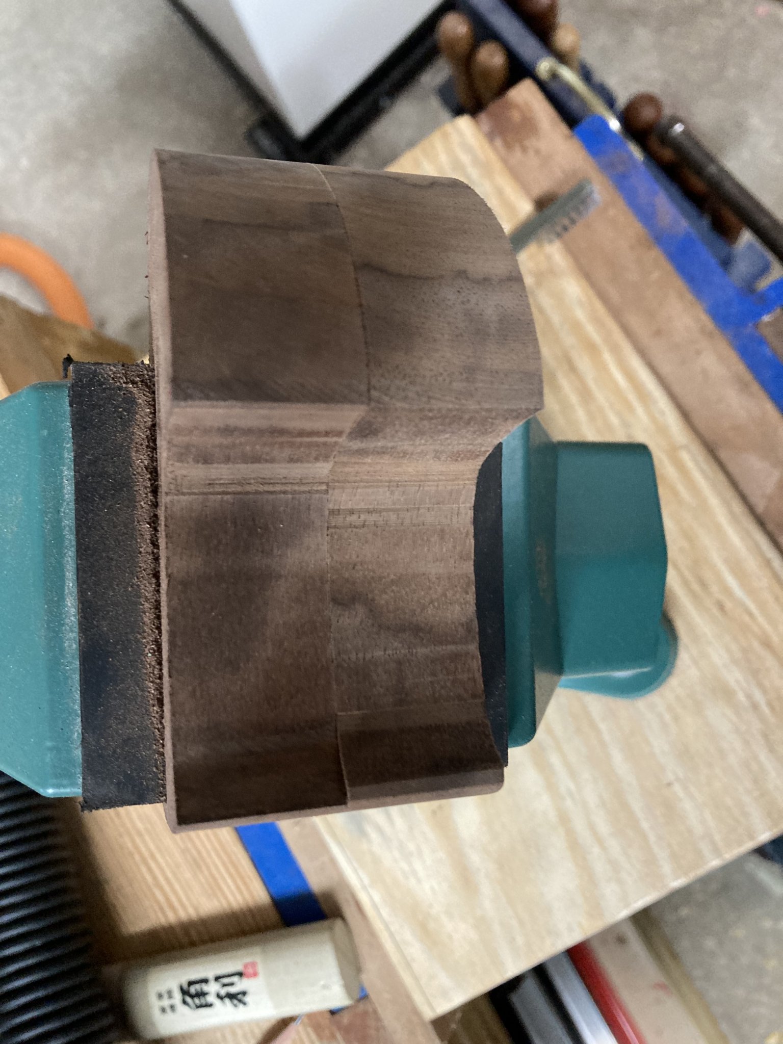

Finally started on the real set of Colt Python grips. These will be made in the Roper style which have a ton of interesting details to them.
Here is a test finish on walnut from the same blank as the grips:

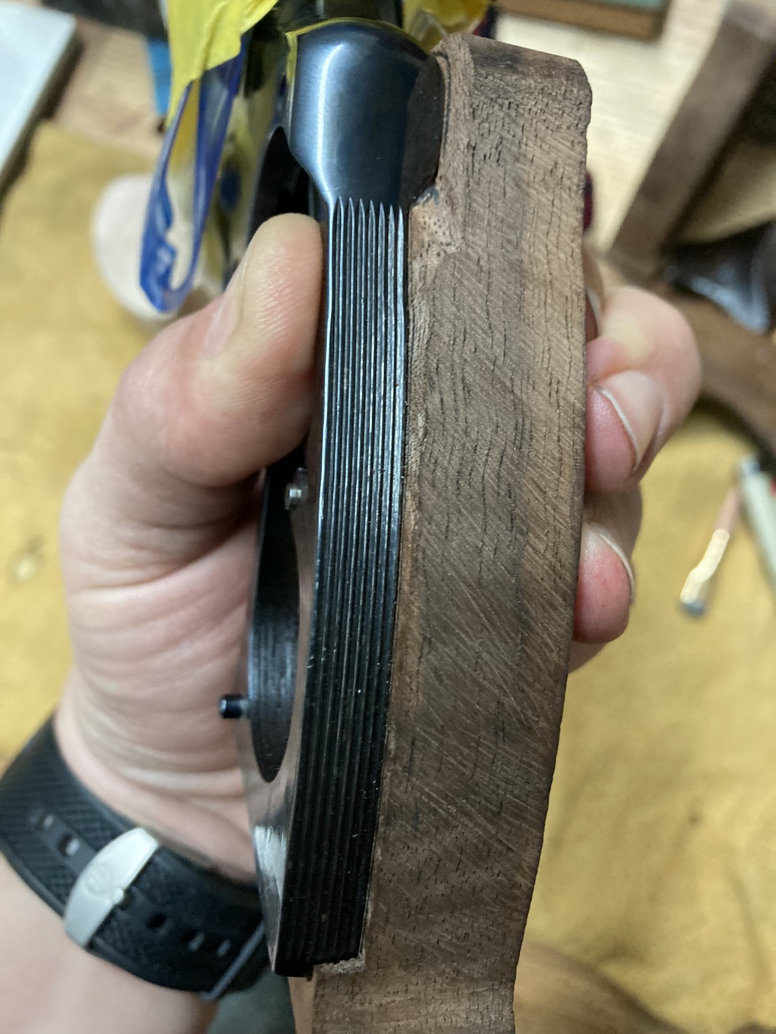

I did most of the heavy lifting with the electric sanders and bandsaw, and am doing final profile shaping with $1,000,000 worth of files and rasps:
All edges are even and at 90 degrees to the reference face. Next up will be doing the inlet for the frame which I’ll start tomorrow.

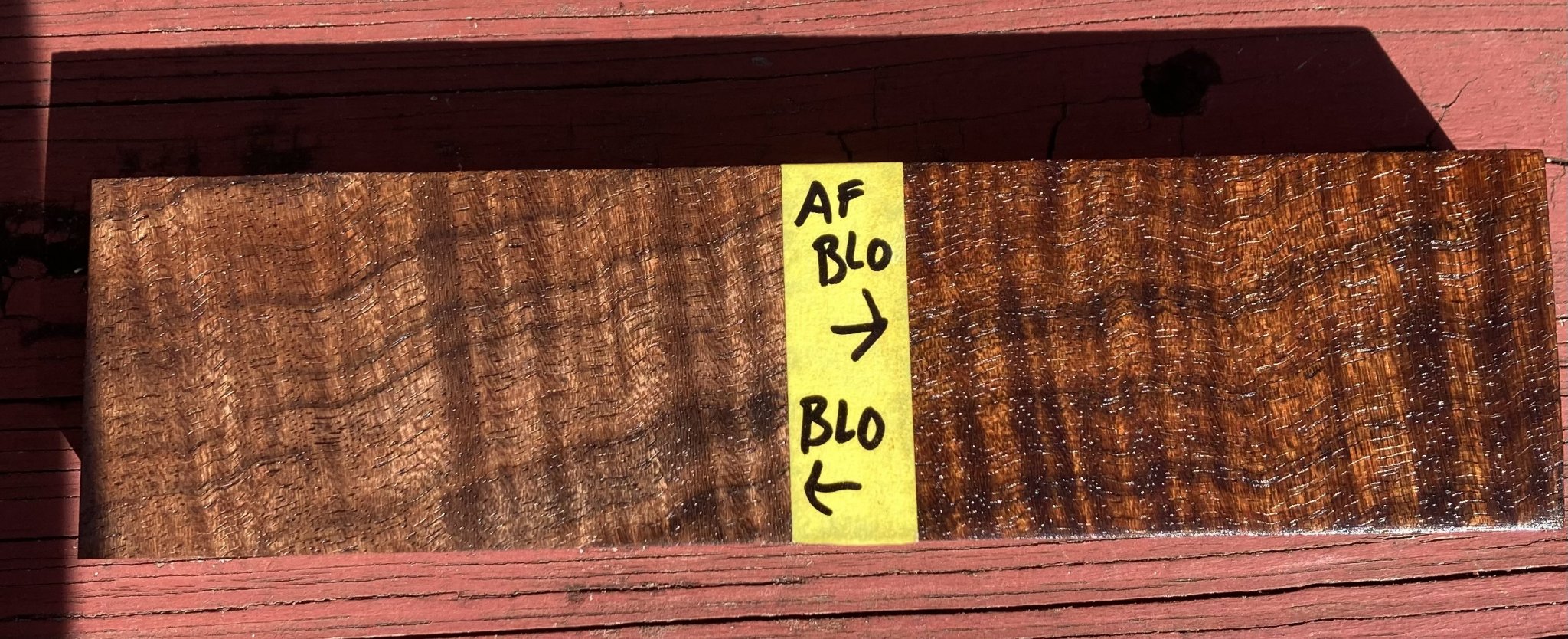

Sneak peak at what the finished product will likely look like since the grain and curl carry through very well on these slabs.
Not seen are the boring weeks of cut, wait, cut again, and wait to make sure the blanks don’t warp in between cutting processes.
Nice work and great material. I use a 50/50 MS and BLO or tung initial wash coat (usually two) to make the chatoyance deep. Adds at least an extra day for the BLO (longer for tung) to set up up but the thinner wash allows deeper penetration before it does and it won't pull out when you wipe it down as you finish it out. I do mostly boxes but I've done a couple of claro rifle stocks with this process as well. Np pistol grips though. That's some mighty fine wood! I like the AF treated side but that wood will stand on it's own.

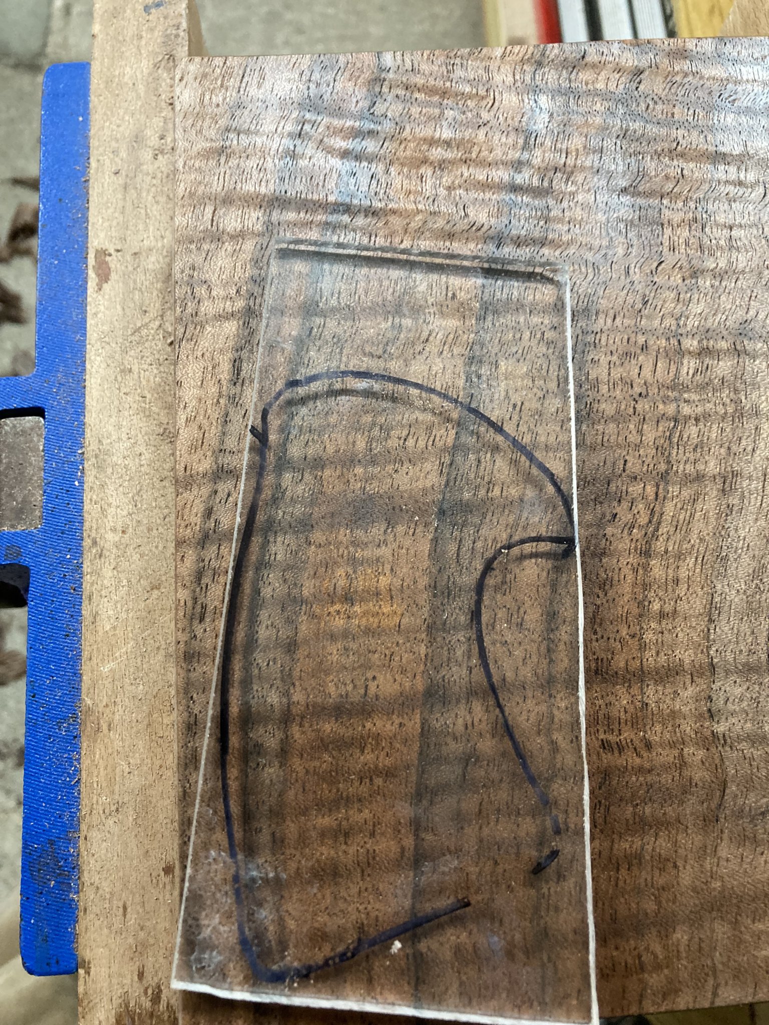

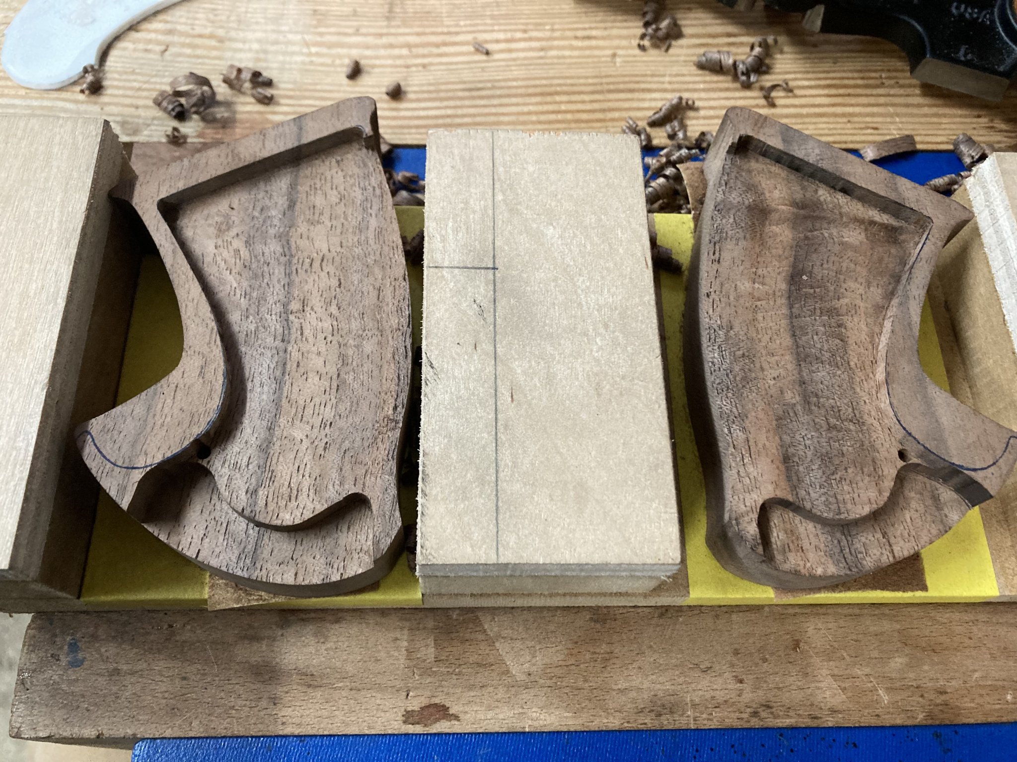

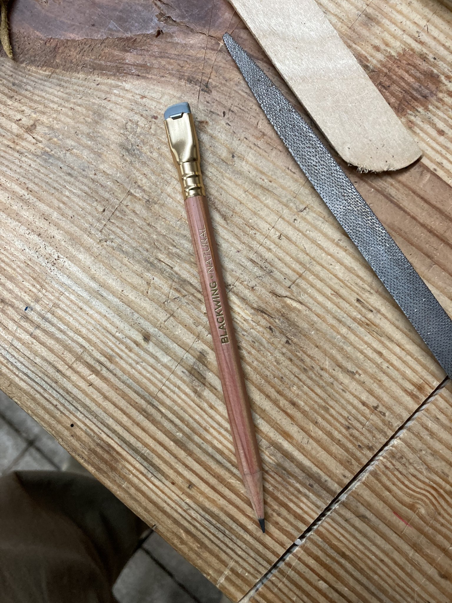

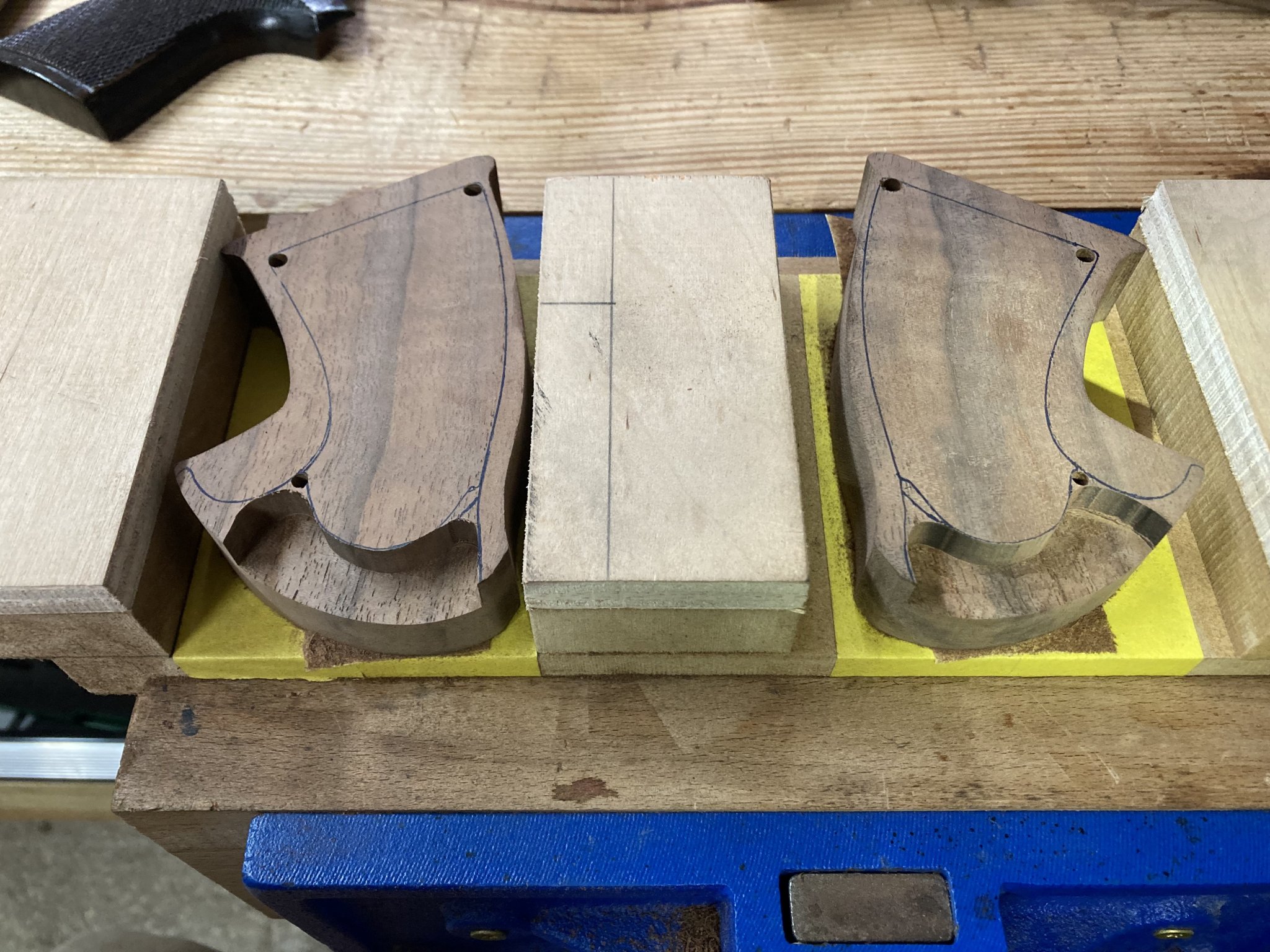

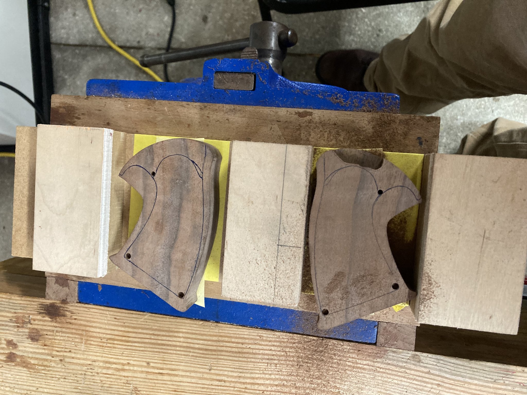

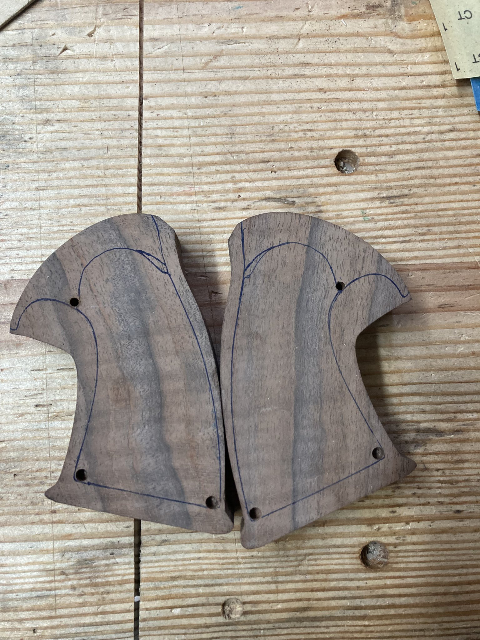

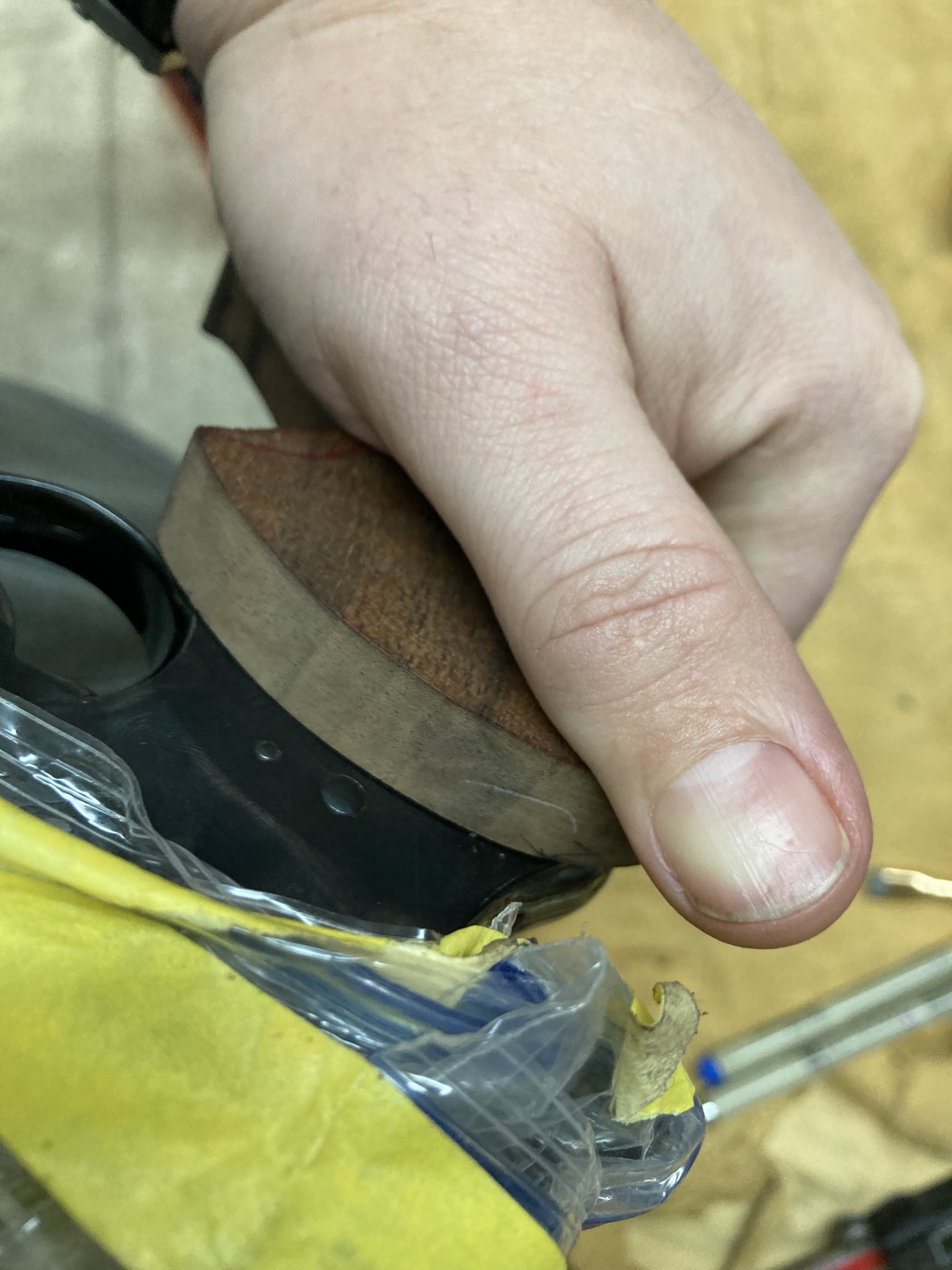

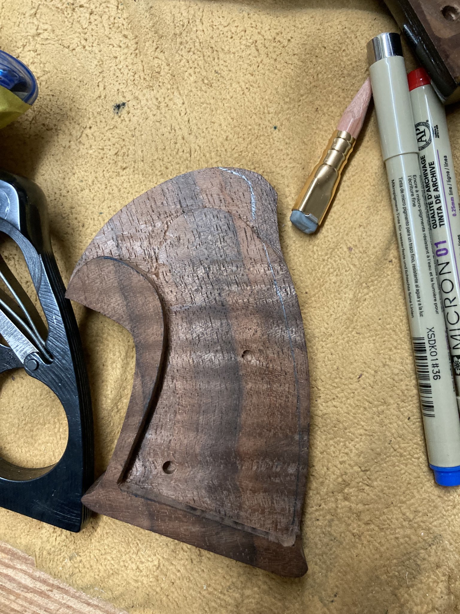

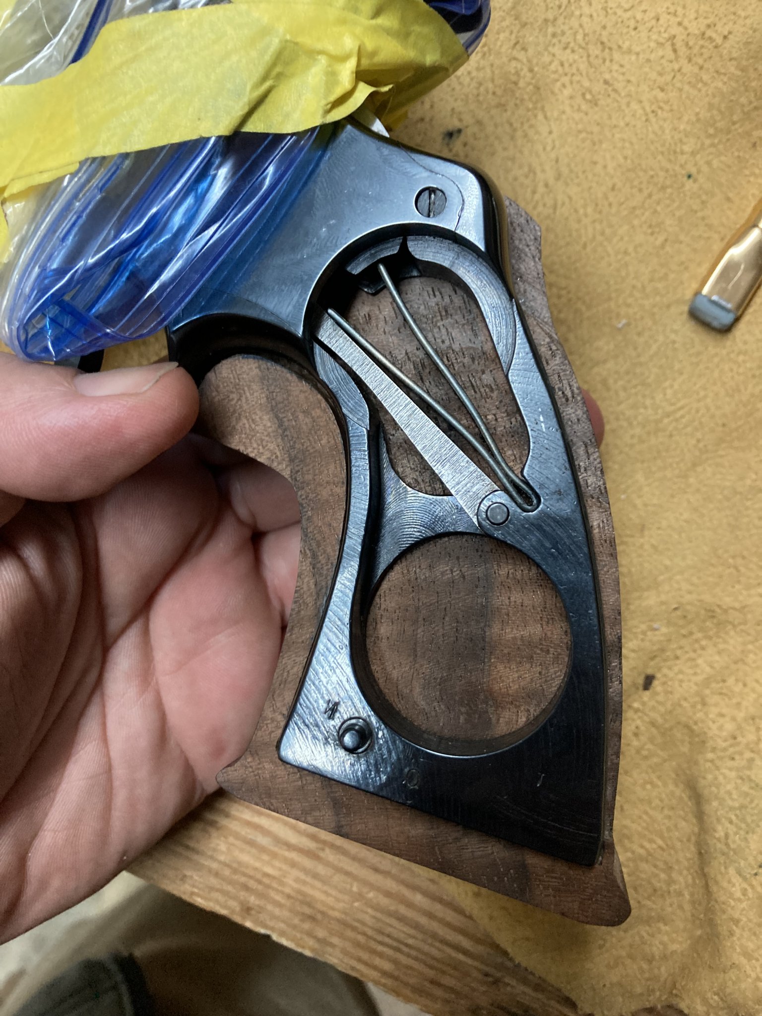

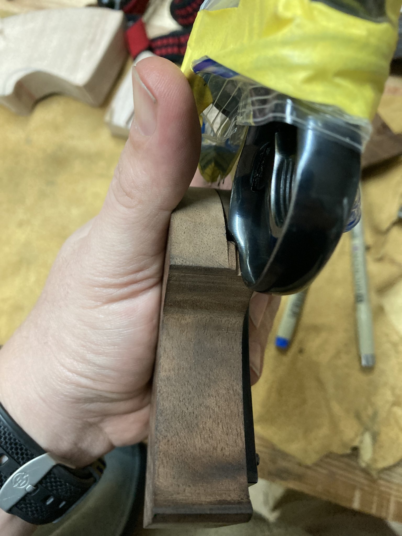

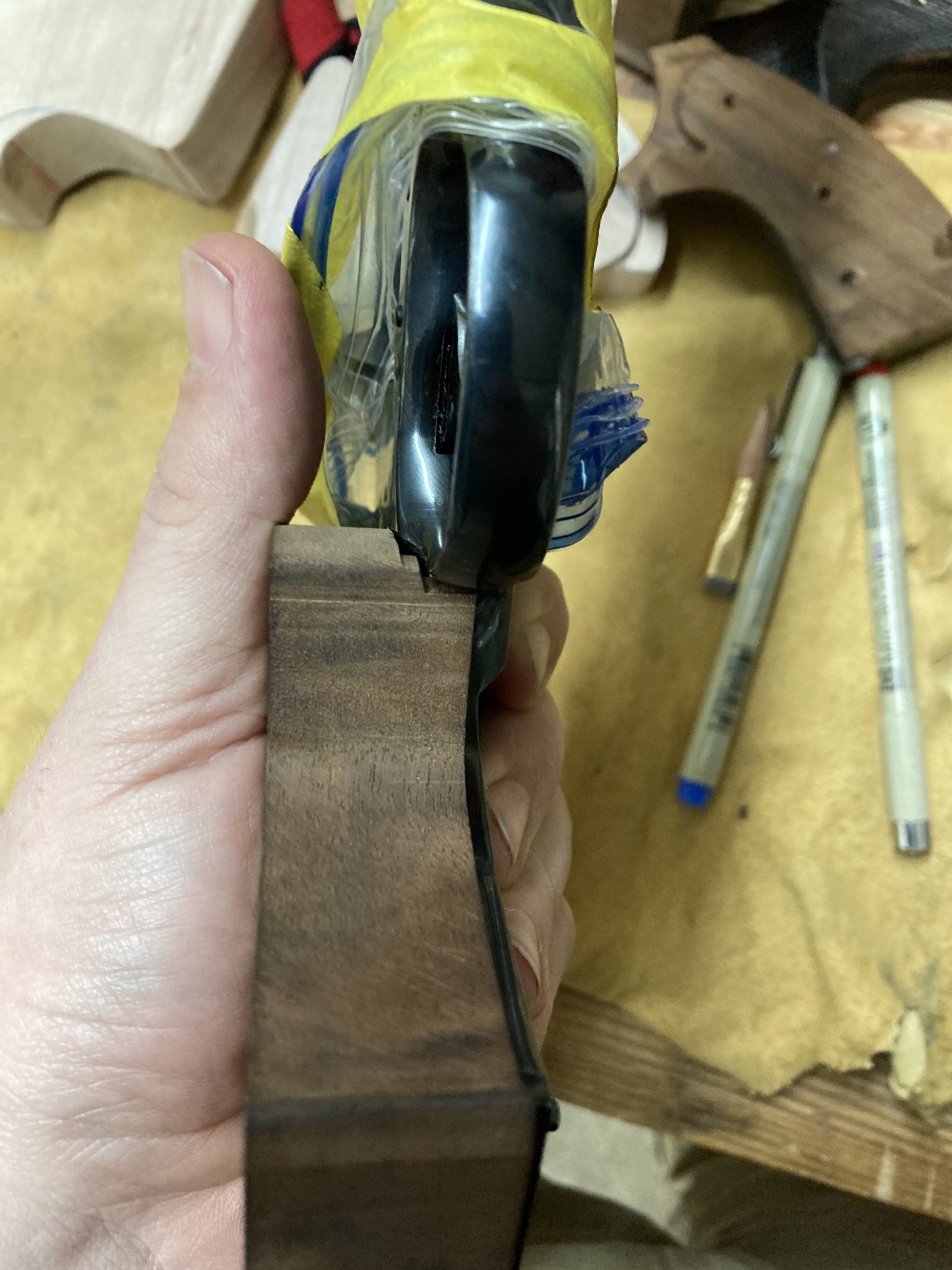

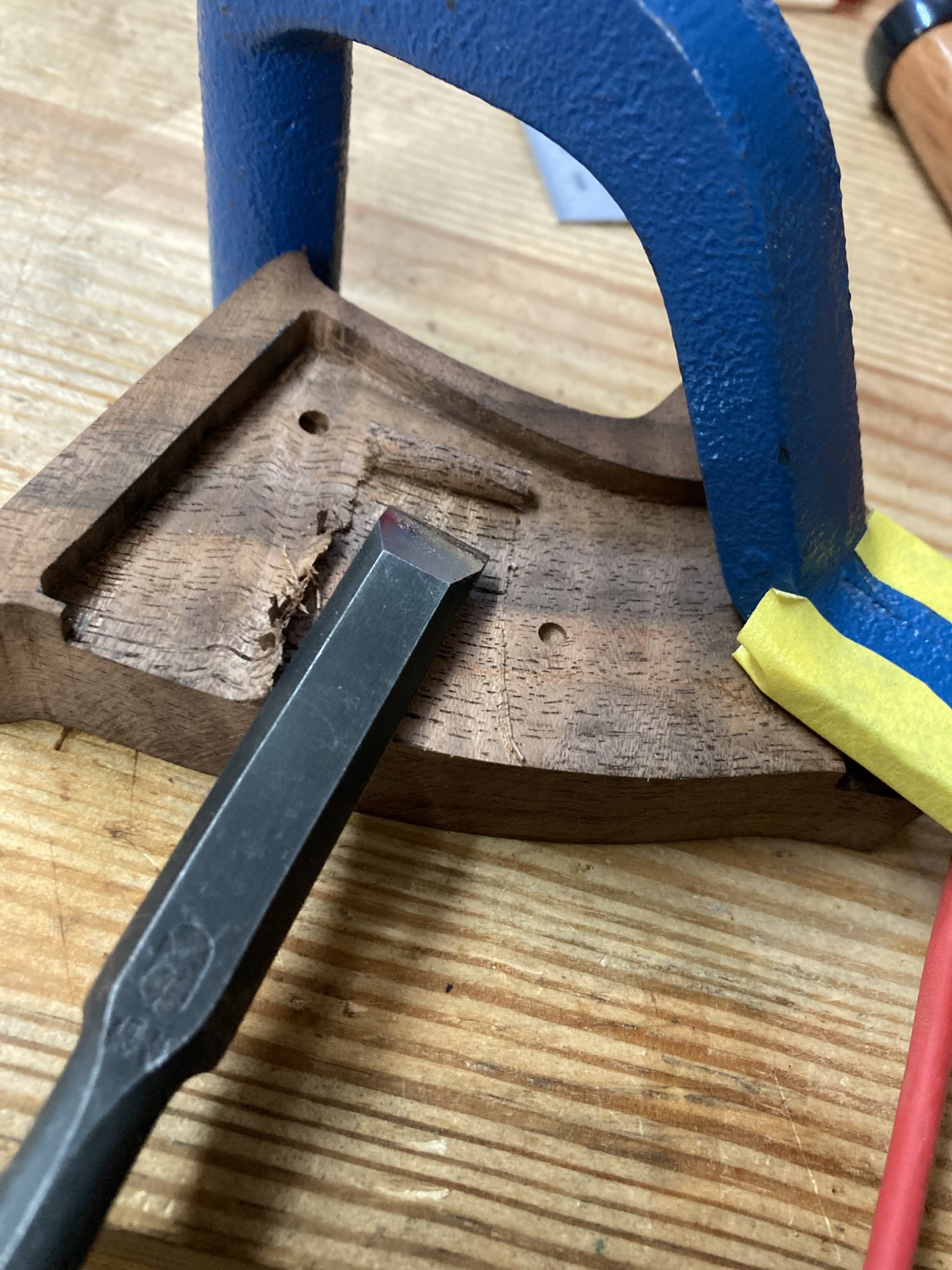

Working on inlet for the Python grips today @sirhrmechanic .
Got my layout drawn in:
Drilled where I wanted round endpoints to avoid fractures over time:
Set up in my super duper complicated fixture for routing out the inlet:

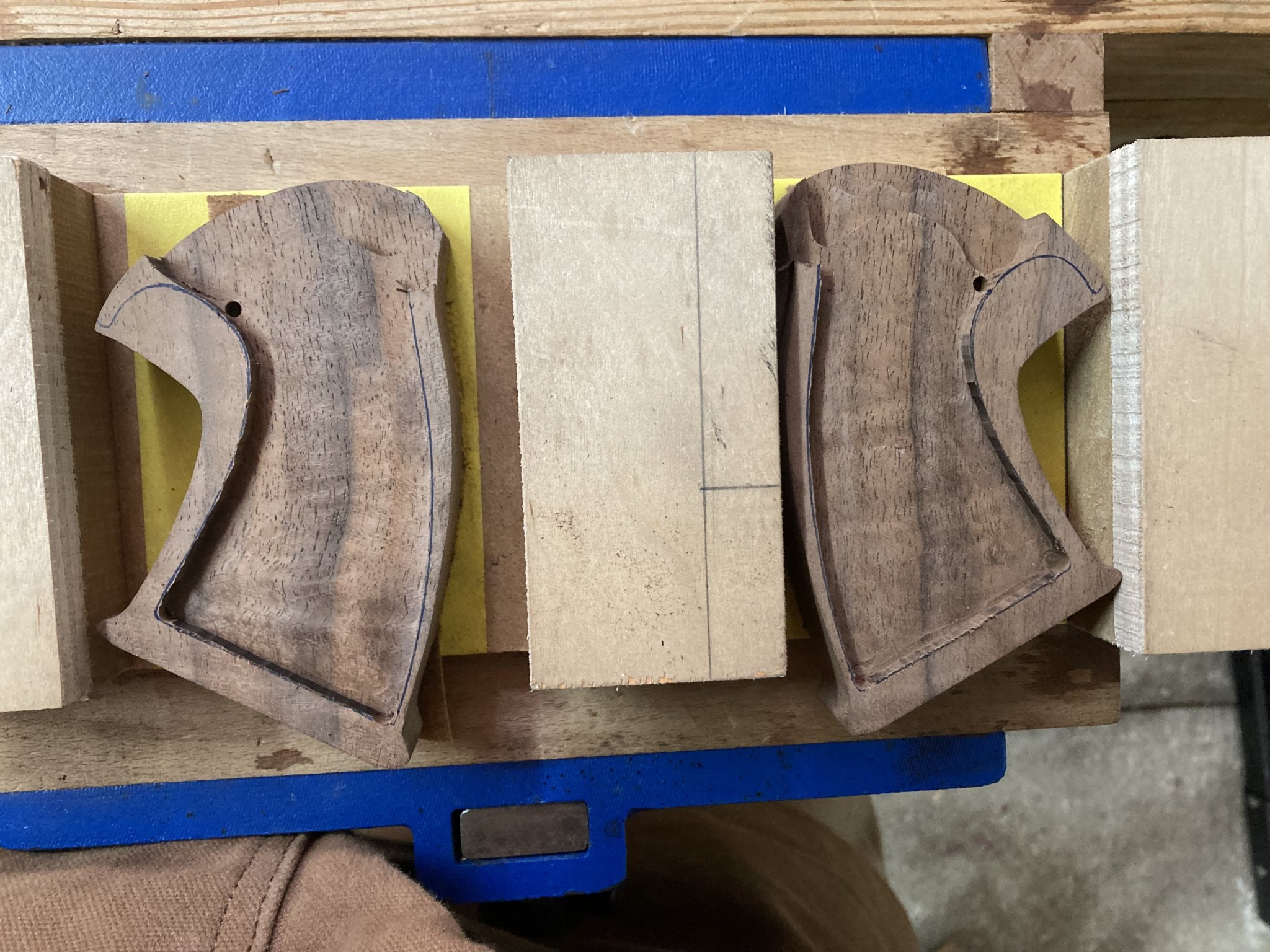

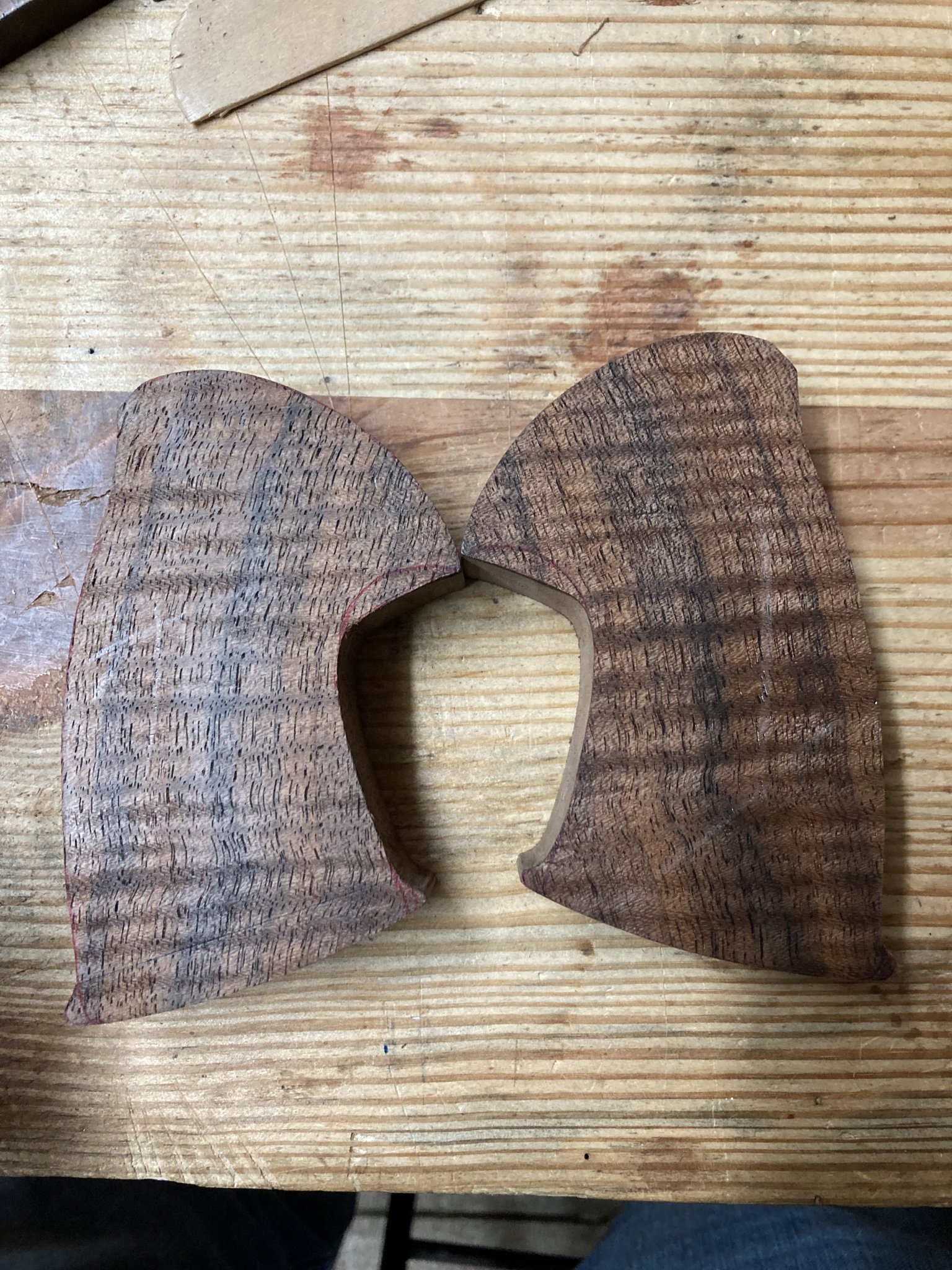

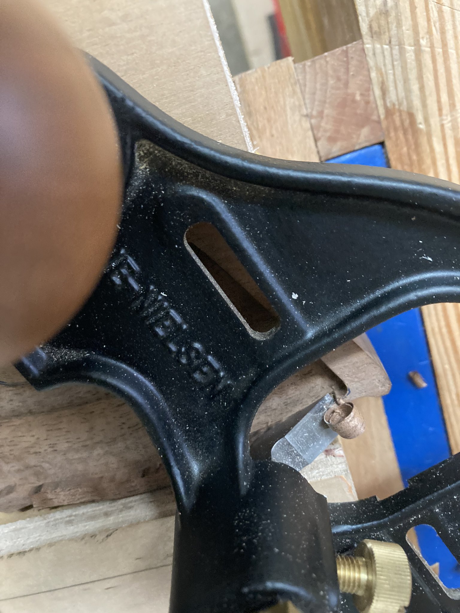

The inletting progression:
Taking off waste at the backstrap end:

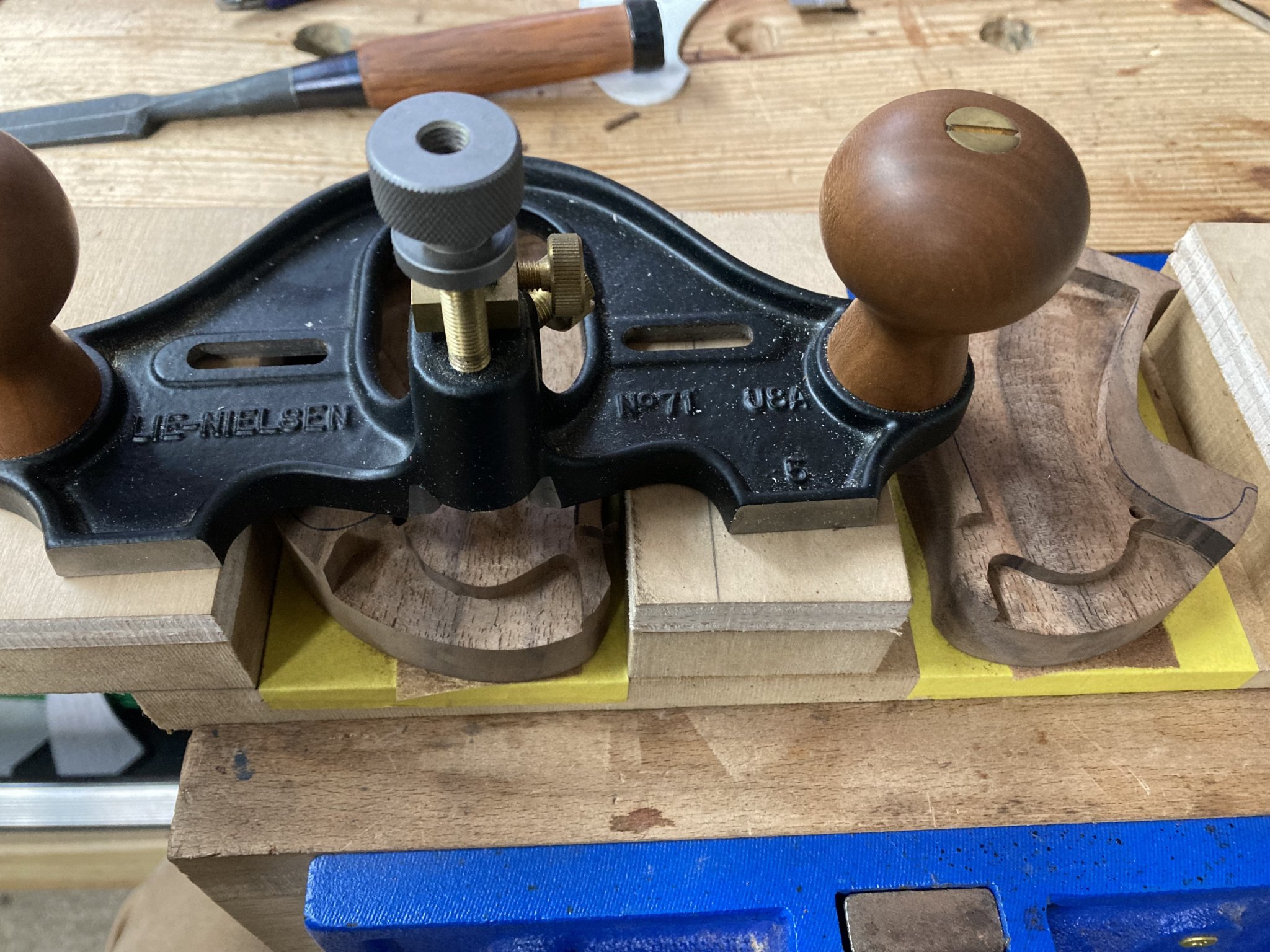

Cleaned up everything with a chisel and Inletting about 80% done:
Tomorrow I will work on fit to frame. I could have hogged it all out today, but that would have given a generic fit. I really want to improve the fit to frame compared to a set of off the shelf grips.

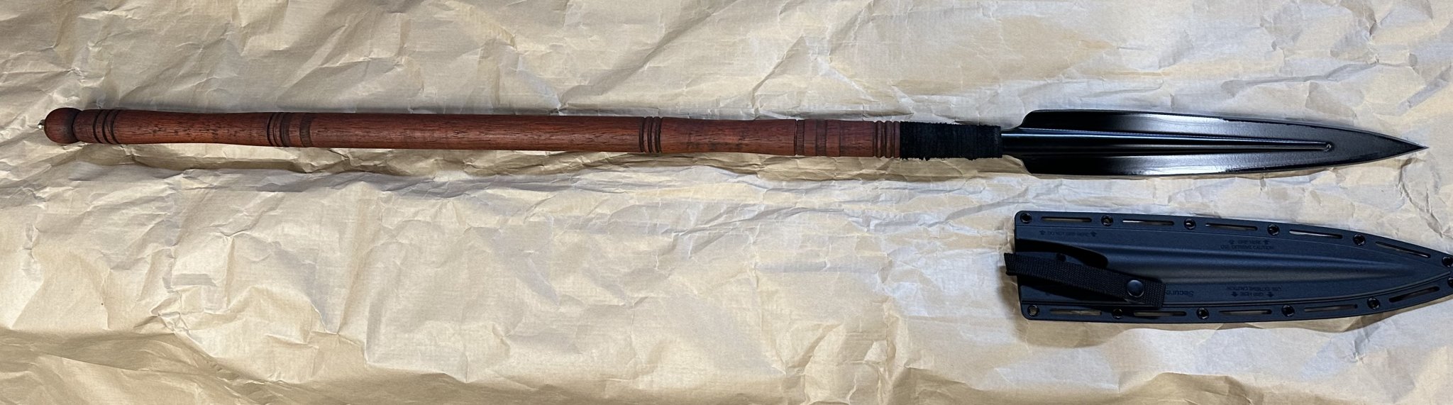

One of my weekend projects was to make a modern Assegai using a Cold Steel blade and a cool bit of padauk wood. Bright orange before staining. Turned on a metal lathe which works great on hardwood!
Came out really nice but nothing compared to BFC’s skill level!
Now, bring on the 24th Regiment of Foot!

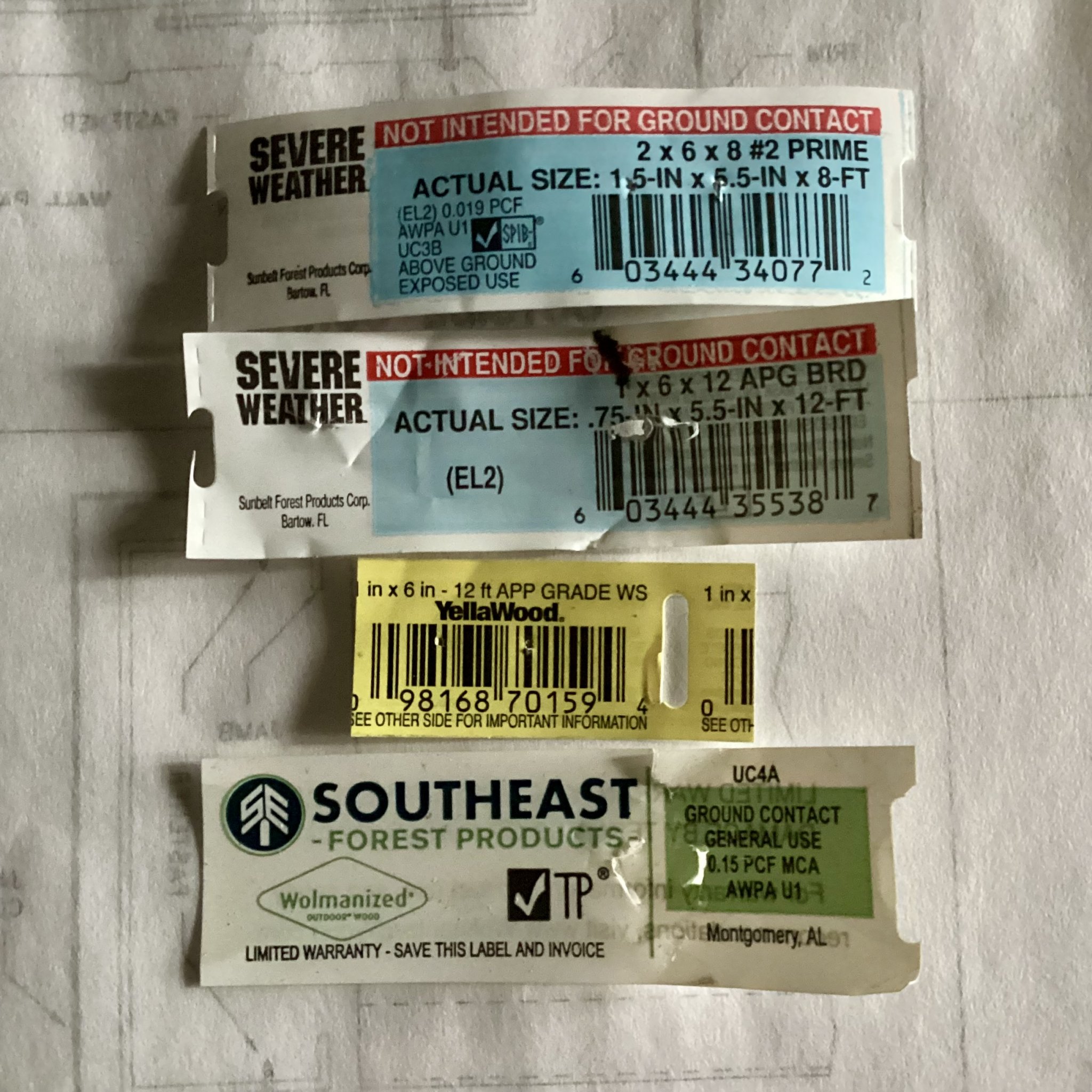

Different end tags from a recent diy project with pressure treated wood. My local big box store is Lowe’s
they are selling the red and blue color tag with “ not intended for ground contact”. The yellow tag is from HD
has “ground contact/general use” same price as the lumber from Lowe’s. The bottom tag is from a local lumber yard
and also is marked “ ground contact general use, and was the cheapest to purchase.
Is it wrong to consider pressure treated lumber marked for ground contact to be superior to a product marked not intended for ground contact?

You're looking for retention of the treatment in pounds per cubit foot. The red label your example appears to be 0.019, the green label lists 0.15, assuming the same treatment, more is better. The green label lists MCA = Micronized Copper Azole, the Lowes product lists EL2 = Ecolife, which, as far as I know, is above-grade only. ETA: I believe the YellaWood product is also treated with MCA.
