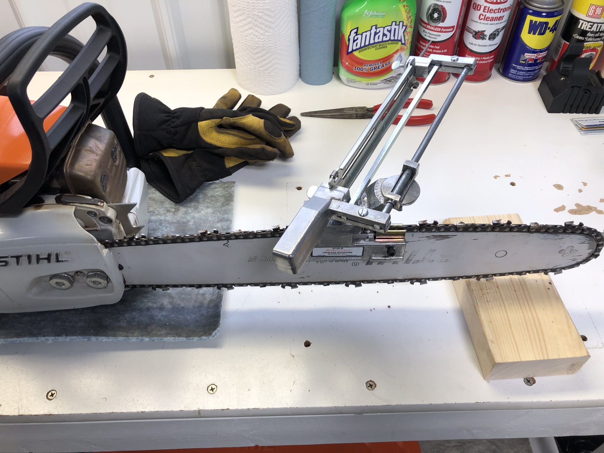

I’m just getting started doing my own. My buddy who’s been in the tree business for years recommended a Granberg. It’s kind of a contraption but works pretty good. The operator (me) needs more practice with it. About $90 from Bailey’s.

I always see the electric sharpeners for about $50 more, do any of you use them?

The websites and videos have a bunch of good info. I am looking for a electric sharpener, I cut a lot of wood and it takes too much time doing it by hand. Had the local shop do the last batch of chains and the new kid wacked the shit out of them, after waiting 2 1/2 weeks they are worthless. Need to invest in one but there are so many it's hard to tell.
Thanks for the input so far, figured putting out so feelers would help. The last wind storm blew down about 47 big firs so I will be cutting for a while:)
You can hand sharpen a blade while you are getting sharpening jigs and machines set up. Takes about 5 min for one of the shorter chains and you can feel if the depth guides need filing. Plus the chains last longer because you aren't taking as much material off. Unless you've let it get dust dull or hit something, all it takes is 3-4 swipes with the file per tooth.

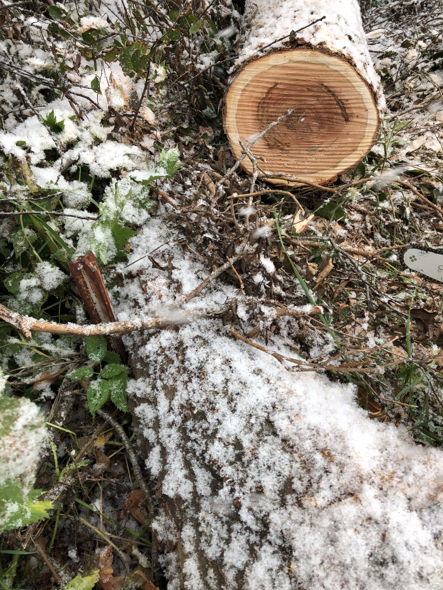

PSA for guys getting started. Big, heavy, trees hit the ground hard. Squish you like a bug/dead hard. This tree center punched a steel fence post/T post and drove it into the ground square and plumb. It’s less than 12” high now. I’ve never seen anything like it. Tree was 16”-18” DBA and 50’+ tall.
Good PSA @tnichols
I probably have said this and will dog pile on to the safety talk and say it again. Carry a Tourniquet on your belt. Has to be able to be reached by both hands.
I believe the CAT gen 7 is the easiest to run 1 handed. This or the SOF-T wide. Dont buy a knock-off for cheap.
I have seen more than 1 instance of where the tourniquet saved a life (last pics I got were from just east of Des Moines from the derecho clean-up) and I have more than a couple stories of guys who perished from seemingly small lacerations that hit arteries, but didn't have a real tourniquet.
We've got a small ranch a little north of here and yearly we take the leaners on the fence line down. I remove the wire but leave the t poles. I've never driven a t pole that far in. But, it's scary the force of a log coming down

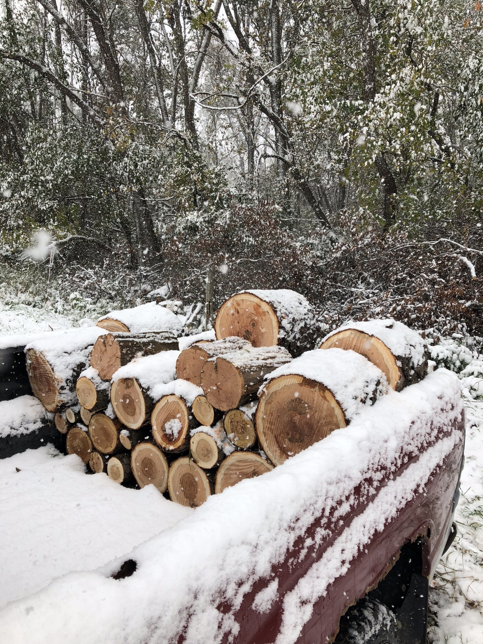

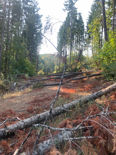

The wind storms hit here in south central Washington hard on Fathers Day weekend. I have over 60 big firs down that I know of so far. Just limbing/cutting the ones off my fences and trails so far. I'm sure there are more to found if I get the time to look. One drove down my swinging plate rack from the lumber companies land and I haven't found the last leg yet:) One fence post was blasted into bits.

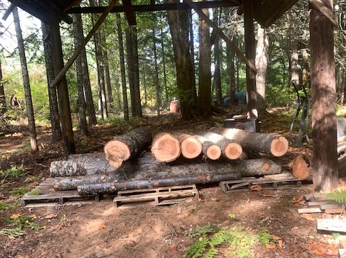

Wood won't be ready to burn till next year so I am cutting them into 11' pieces and bringing them down on the forks of my tractor at 3-4 at a time. Slow process by my self.
Starting to stack them off the ground (pallets on the bottom) under a utility shed roof out back to season. Just was out yesterday limbing and pulling them out and of course I find another two leaners that I had to drop too.

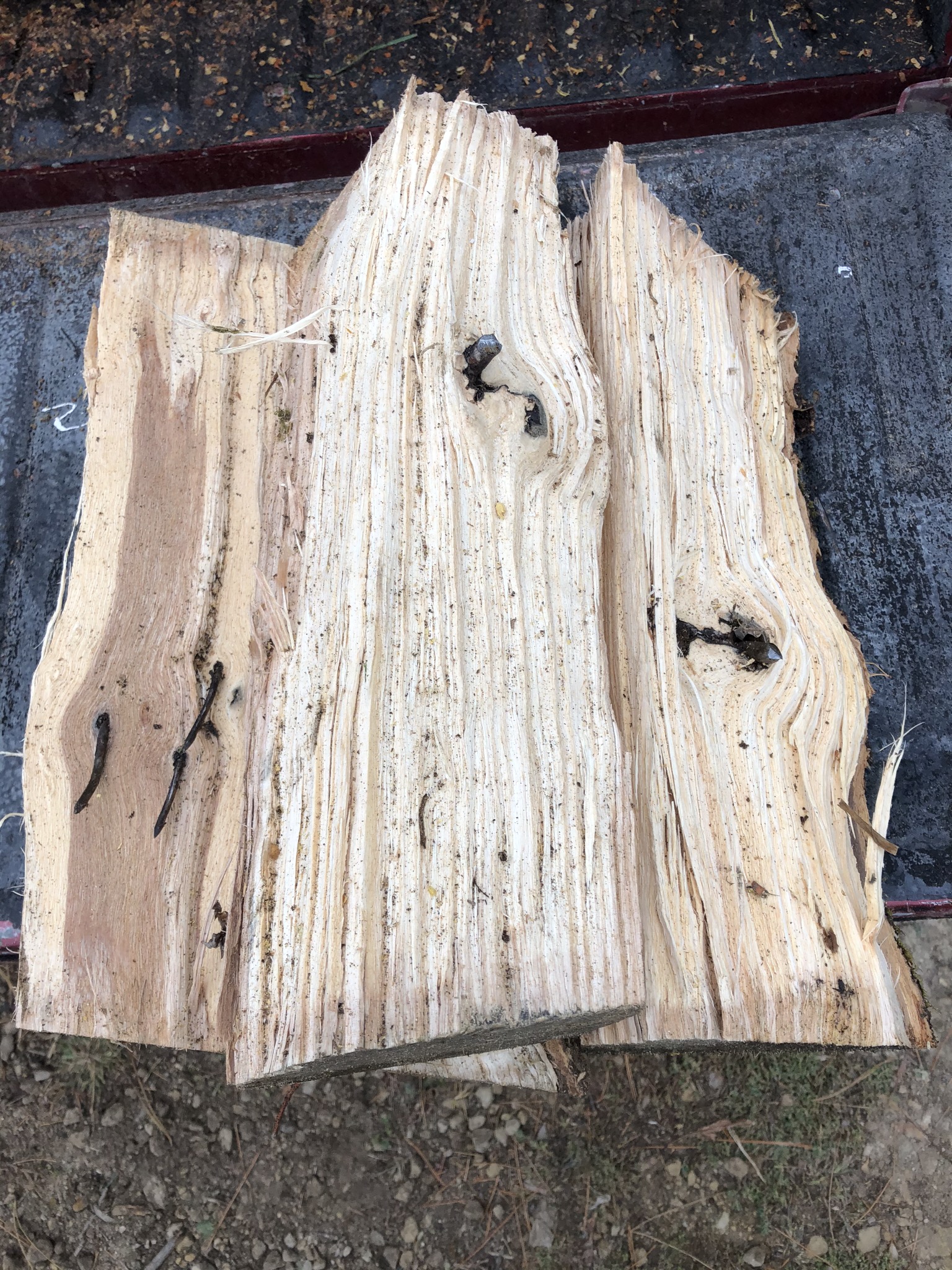

Now, is/was that all 'innocuous' in the sense that someone used the tree as a fence-post, OR, is any of that a typical "spiking" type of thing? Those 3 nails together look to me to be something attached on purpose, like a swing, or something.
Typical yard tree. Full of metal. Hang a sign, string an electrical/phone line, etc...
