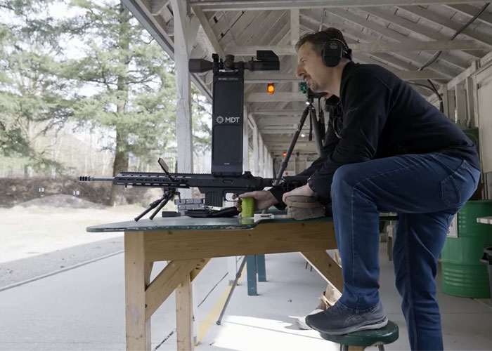

This guy shoots better than all of those idiots.

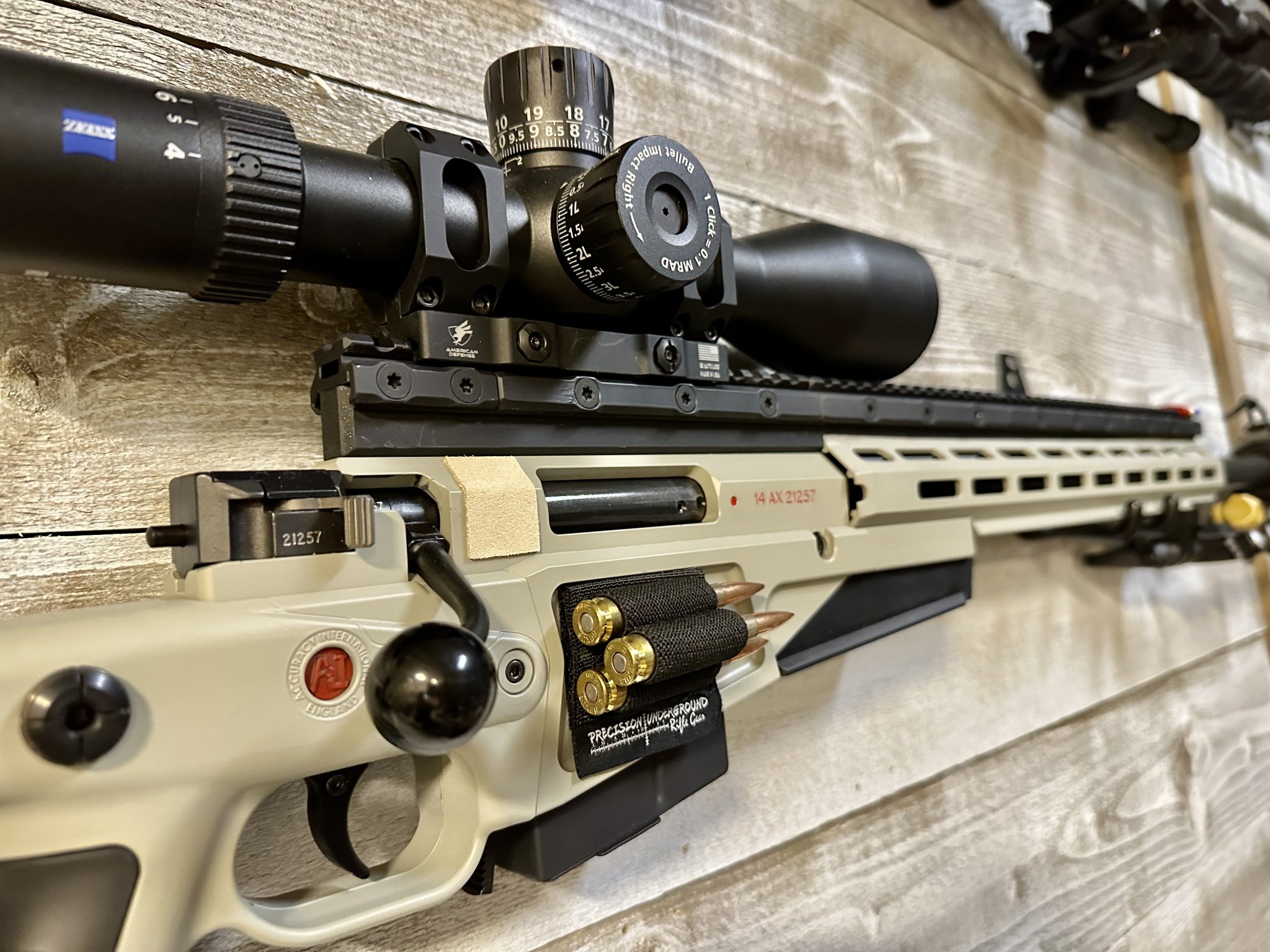

Right now I have two rifles in JAE chassis with ARC 1.10" rings.
And my head is NOT rolled over on my rifles....I've taken the Frank/Marc clinics twice and head roll was not one of my many issues (thank god, I have enough as it is LOL)
To get behind the scope properly with these rings and in these chassis, I have raised the comb almost as far as it will go. I have .17" of additional adjustment left. Not much, right. And, I think the JAE's are pretty much in the ball park with everyone else in terms of comb height adjustability.
So, if I put 1.5" rings on these guns, I would be far too low.
I do see where ARC makes 1.26" rings. If I use up that last .17" of comb adjustment, I should be able to get behind my scopes. But, I'm doubtful that .16" of additional height using these next taller rings is at all worth the $180+tax+shipping.

1.5" high x 6-mil scope mount, plus the 6-mil pic rail that came with my rifle, combined with the adjustable comb on the stock, lets me keep my head upright when I have a sloppy chin "weld."
I ordered a shorter replacement mount. and like @Baron23 suggested ... a chassis with more adjustment is a little ways out on finance schedule.

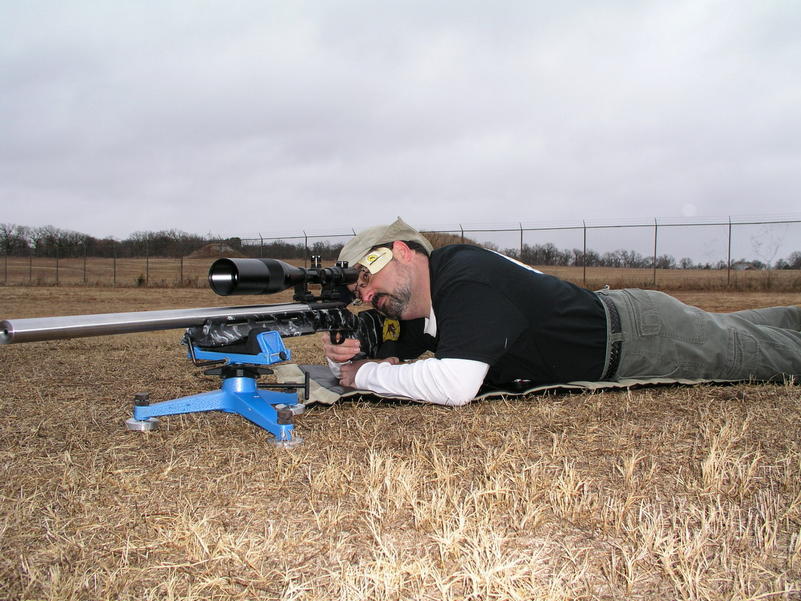

Is he really shooting or just letting the rifle do the work
he is buying more of a win then anything else,
Compared to my IHMSA days, every time I get behind a PRS style rifle, I feel like its the rifle and I am all but the spectator. I’ve seen peopel brag about my marksmanship however, 1. I can’t even hold the rifle crosshair on the target point while shooting from a bench; 2. I am technically shooting worse than at any time in my last 65 years of shooting. Yet, I am still hitting targets out to a half mile or longer and doing it regularly enough to make myself wonder. As far as holds, wind correction, I am an old mortar man so bracketing is second nature.
Its got to be the rifle and the structure of PRS style shooting. Between the bags and the tripods and the weight of the rifles, hitting an MOA sized target at 300 yards is a given, a chip shot.

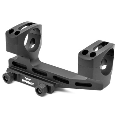

All kidding aside, are Warne one piece mounts GTG for a quality precision rifle?
Warne makes some good products but I wouldn't use that one as it's more of an AR mount but you could use this one.
Or this if you wanted it shorter.
Reactions: Milf Dots
