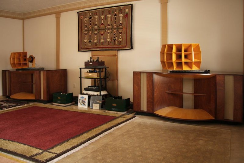

    These are in my living room. The bottom cabinets are 7 feet long. Sirh has heard them.
    I am not sure that 'heard' is the right word. I think 'experienced' is a better term.
    Dark Side of the Moon on Vinyl with a large-ish single malt was something of a quasi-religious experience.
    We all have our obsessions. I have live artillery and old cars/old motorcycles. Maggot has audio equipment that 'goes up to 11.' And goes up to 11... at a level of sound quality that is something like a transcendent out-of-body experience...
    Cheers,
    Sirhr
    Mr. Maggot, those cabinets are a work of art, did you build them?
    Bwahahahahaha
    I can take $10,000 worth of fine wood and turn it into a pile of toothpicks, not much more.
    A skilled woodworker built those. They are made out of Oukume plywood (9 ply, all hardwood wood, void free, marine grade, certified by Lloyds of London to be to British boat building standards. Every joint both screwed and glued
    The horns on top are equally a work of art, built by an engineer who exiled from Cuba years ago. All wood and check the curves. Truly a master craftsman. Despite their size they only way but 5 lbs each. Very delicate work.
    Im highly efficient at spending money on this stuff. My skill level stops there.

    Maggot I get the multi cells. Tell me more about those 7' cabinets. Very interesting set up. Tubes and all.
    The originals had bass to 40 hz. My pair being better constructed, have usable bas to 16 hz, the low note on the pipe organ. they will really make the air quiver. The multi cell horns ar e wooden replicas of the Altec 1505 with 288 c drivers on the rear.
    RCA model MI-9462 bass enclosure. Many swear by these enclosures and feel that they portray the most palpable, real sounding bass out there. I never had a chance to evaluate them myself, even though I had a pair of them stored in my garage for a time.
    They were introduced in about 1948, and were RCA's take on the VOT type combination bass enclosure. The short front horn flare is a radial design, as were the RCA cast aluminum mid / high frequency horns that were introduced at the same time. The radial horn was invented and developed by RCA engineer Mr. John Volkmann, and the MI-9462 was designed by his associate, Mr. A.J. May. These RCA designs were the original radial horns, but many others, including the Altec 511, 811, and the JBL 2350, etc. soon followed.
    The original drivers for the MI-9462 would have been the field coil MI-9443, or the permanent magnet MI-9449. These 15" drivers used a very thin, straight sided cone with annular corrugations, a 2" 30 ohm voice coil, and a large magnet structure. Other woofers built with the same general light cone / heavy motor recipe, like the Altec 515, might work quite well.
