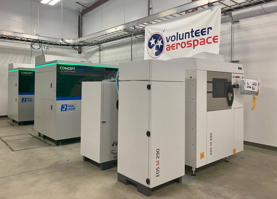

Are these SLS, or something else? The striations are interesting and look like it's built lengthwise in layers, which smells like an SLS or similar process. I'm curious how they've worked around the durability issues with layered building like this. The fact they've arranged the layers lengthwise to avoid maximum stress on joints is smart.
Yes it is 100% 3D lazer printed inconel 718
Actually it’s SLM
Actually it’s SLM
Interesting, I've not run into any SLM parts personally, I just would have assumed it wouldn't have the layer marks as the material is actually melted together. Learn something new every day! Makes sense they'd need to use SLM or something like it with the pressures and temps involved. Thanks for the tip.

I've visited EOS at their Austin site, truly amazing tech. They have a facility in Austin and another up in Detroit. They're a German company, very smart people that have been in the additive manufacturing business for a very long time. It'll never replace traditional manufacturing, it's simply another tool in the toolbox.
