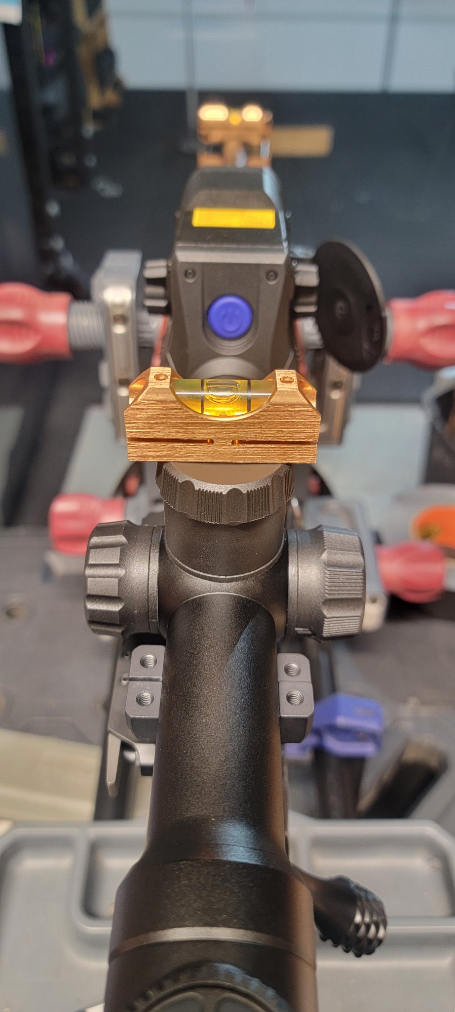

Hey Guys, my brother just got a thermal (Pulsar Thermion 2 LRF XP50) and brought it over to help him mount it up. Went through the normal leveling process as I would with any other optic and leveled the rifle and then proceeded to level the scope to the rifle. However, when we fired it up the digital display is now canted quite a bit.

Yeah I noticed those arrows and you have to have it canted quite a bit before those show up on the display. My thing is, when the scope body is leveled to the rifle, and with that tall ass battery turret and the LRF up front, its super easy to eyeball when it's level. But when you actually look through the scope it looks like a picture frame that is tilted on the wall. Is there a way to digitally fix that like rotating the picture like you would a jpeg image on the computer? Or does it mean the display screen is not mounted square in the scope body which is why both (scope body & Display aren't level together).

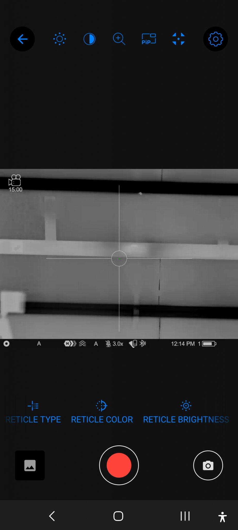

How canted is it? Can you post a Pic that shows the display in relation to the battery cover? It certainly would be annoying if it's a lot, but assuming they boresighted it during assembly it won't affect anything shooting wise if you just level the display in the rings.
This is all assuming that I understand what you are saying. There is always the possibility that I am not,lol.
Both of the scopes that we have had were pretty canted. Like very annoyingly obvious to the eye before even putting a level on the turret. And if we leveled it based off the turret or the objective/laser rangefinder housing the bubble was maxed out to one side. Couldn't find a good pic of the canted scope but the attached pic is what the reticle looked like when the scope body/turret was leveled. That is my 5 foot level taped to my garage door at like 15 feet away. That much cant at only 15 feet is pretty bad.
