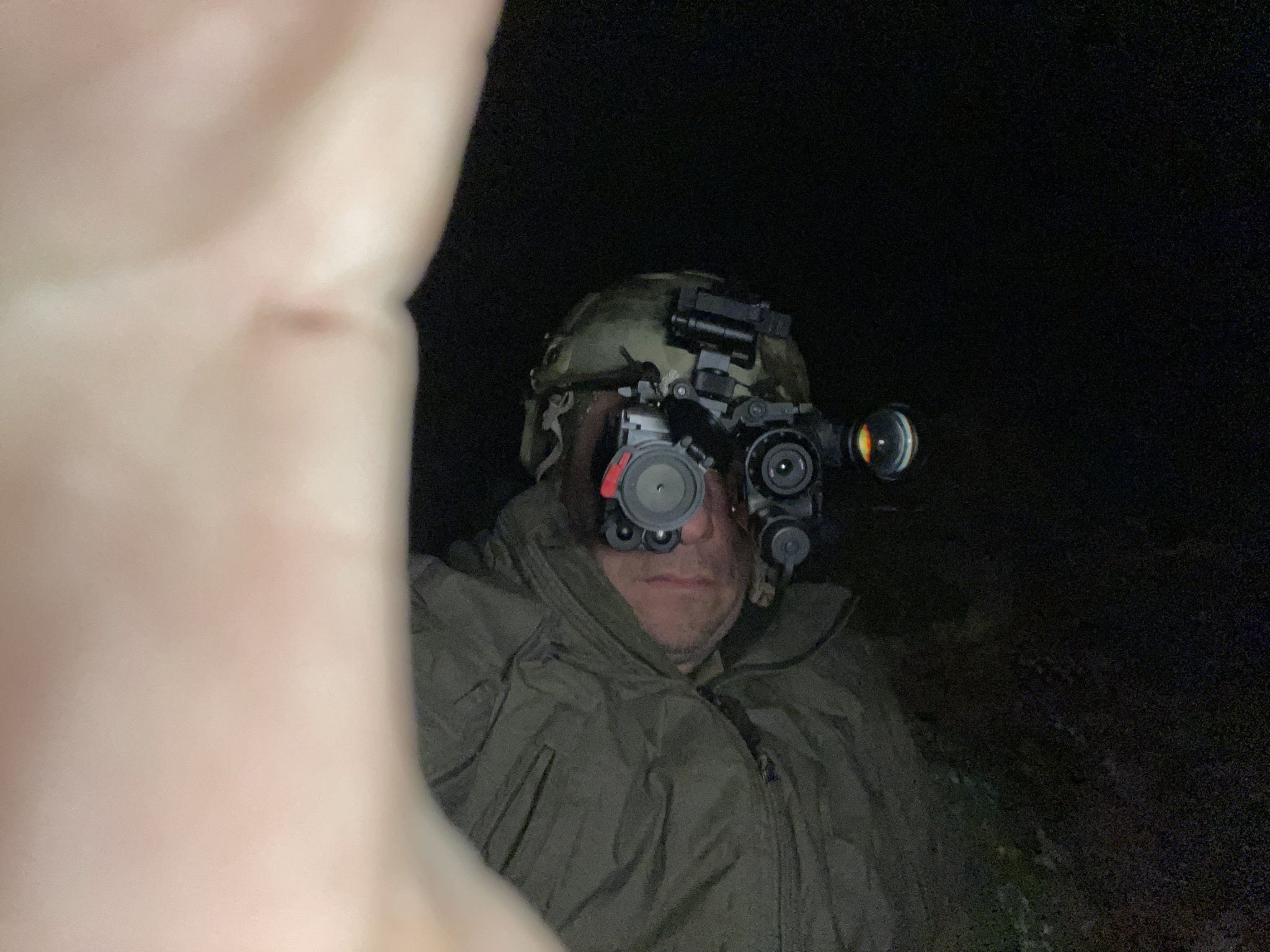

I've been using 14 + thermal on head since ir-patrol and armasight q-14 first came out in 2015.
But the only purpose designed helmet mounted thermal that works as a real clipon (no adjustments needed) is rhe voodooS.
Given you're looking at chinese stuff, u may not be in the market for serious stuff, but you said u dont know what u dont know and wanted input.
So look at the voodooS as well.
They are make to order, with a bit of a lead time, we are trying to keep a few in stock, but they sell pretty fast.
Otherwise, in theory, the sidekick can work as a clipon as it does have margin adjustments, but the mounting solution will have to be worked out since it isnt designed as a clipon. And i wouldnt try it on anything over 556/300BO.

I’ve tried just about every combination of setup I can think of and have settled on the thought process that more capabilities trump resolution for the vast majority of use cases.
For a $7k budget I’d be looking at a 384 scanner and a 384 scope. 384 units are plenty capable and by having all three you can mix and match usage plus have backup if something goes down.
Helmet mount is great if it fits in your budget but a hand scanner is way better than just a scope. Hot swapping a device onto your rifle sucks in the dark when coyotes are coming or you walk up on a group of hogs. Shooting with the laser is ok but shooting with a thermal is next level on spotting targets and shooting farther out.

I like my ptq136. Easy for me to mount with MUM-14 Armasight mounts and bridges
A friend has stingir 384
He is having trouble finding a less$ version for good helmet mount
It is coming though
I’ve had a lot of fun rat hunting at night for my neighbors farm
