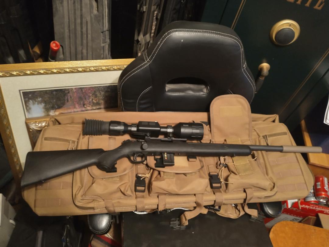

I have this for walking around the place at night dispatching critters that come up in the back yard and eat the cat food or tear feed sacks apart in the barn.
Coons, skunks, porcupines, coyotes or rabbits and deer from mother's garden, still waiting to count my first bobcat.
Savage Mod 93
.17HMR
ATN Thor 4

I mounted my Pard NV008S on my .22 air rifle. It is a daylight as well as night time scope so shooting in the backyard during daylight hours is great. Should I choose to use it at night it probably won't wake the neighbors.

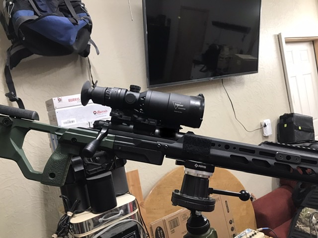

Well I found a mount for the Burris clip in that was surplus to my needs and it should be here this weekend. I’m thinking of putting a Strike Eagle 1-8 on the Vudoo and the clip I’m in front of that. That’s assuming that the Nv bridge on one of my chassis is in the correct spot to allow for that. I’ve got an XLR Element, Rock Solid and a KMW with bridges for sure. I’ll keep everyone posted once I get it set up and post pics as well.

Well, it isn’t how I’d draw it up but it works. I put an extra 1-8 scope I had laying around on a Vudoo with the Burris clip on and went to work with it. Being new to clip ons, I was surprised that the zero from the scope didn’t change when I added the clip on. Don’t know if I got lucky there or what. Zero went way off though when I zoomed to 2x on the clip on. I might end up swapping to a Bushy 3.5-21 after a while and see how I like that. With this set up, the scope has to be about 2.2x to fill the scopes view.

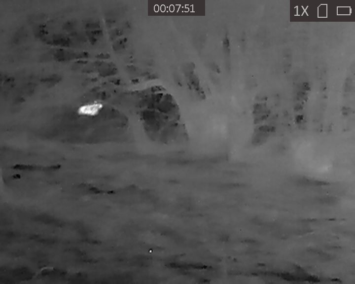

Was wondering how I was missing these things at 70-100+ Yards. Turns out they’re the size of a golf ball. Definitely a challenging shot at that distance through a thermal. Not sure if I should post pics of them. Don’t want to offend anyone.

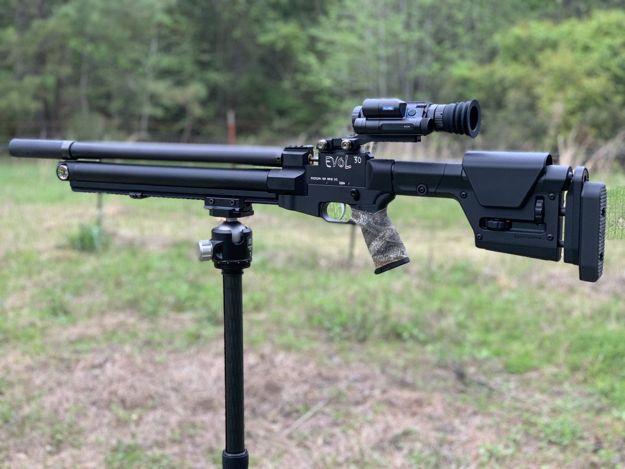

@NWnewguy I occasionally hunt at night with air rifles. For me the main issue is ranging moving animals at night. The solution to this problem was to purchase a Pard 008s LRF. I run it while using an AGM thermal hand scanner. Here’s a photo of the Pard 008s LRF atop my AAA Evol .30. This is similar to what @B y r o n mentioned.

That’s pretty sweet. I’ve seen a few YouTube vids of bolt on LRF setups for night stuff. Looks like they’re out of stock most places right now. Would definitely be worth it. Seems like they go for around $300. I’d much rather buy the Halo XRF, but my wallet protests at that.
I have been cleaning up on these things though. I wouldn’t bother them but they eat the grass, roots and all. Which turns the area into a lunar landscape. I won’t say it’s not a bit of fun too. Last night I watched a coyote come running in, which turned out to be a Jack rabbit when it got to about 125yds or so. It was hard to believe it was a Jack and I thought it was a coyote but that goes to show how range and scale can fool you with thermal.

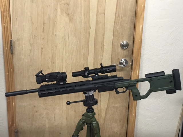

I’m running a Burris clip on BTC-50 in front of a Bushnell 1-8. It’s working alright. I have a Burris BtS-50 and it seems a lot better frankly. But I have it set up for coyotes on a SPR type Aero AR that shoots lights out with cheap reloads, and don’t really want to mess up that set up to shoot at rats. I wouldn’t necessarily blame the BTC-50 though. My set up isn’t exactly optimal. If you look at my pic above you can see that I have a big gap between the lpvo and the clip on. That can’t be great. But the Vudoo is getting the job done with this clip on and doing it quietly, which is important to me. I’ve considered throwing the scope I had on there (Bushnell DMR 3.5-21) and seeing how that works. I can’t imagine it would allow for zooming in much at all but it wouldn’t have that big gap. Just need more time in the day to try everything out.

@NWnewguy The gap is precisely why I asked. I’ve seen the objective clip-on rings, but don’t recall seeing any for LPVOs. How does that gap affect your FOV? Any tunneling or diminished image quality? If it works, and works quietly, rock with it. You’ve just shown me something I hadn’t considered. Overall how do you like the image quality of the Burris unit? I came very close to purchasing one. I wonder how it compares to the Steiner that was in the same price range give or take a few hundred bucks.
I can’t say how the gap is effecting it right now because it’s the first thing I’ve tried it on. You have to be in about 2.2x in order to fill the scopes fov, which seems about normal I guess. That’s about what is was when I put my PVS-14 in front of another 1-8, so seems normal to me, but I have very limited experience with either. It does seem like it’s effecting the fov somewhat because I have the 50mm scope from Burris too and it definitely seems less reduced, for lack of a better word. If I get done working on a house I’m rehabbing early enough today I may throw the 3.5-21 on it just to see the difference. I will say that the image quality on the Burris seems pretty good to me. Black hot specifically for my climate is really good. I would have to think that the Steiner would be noticeably better since it’s a 640 unit, but I missed the boat on the $2000-2200 prices in them. I found pretty crazy prices on the Burris handhelds and clip on that I bought. Got a decent deal on the scope from the BST here. Overall I just wanted to get my feet wet and see if I would actually use it and I’ve been having a blast. Either the scope or clip on would have no problems on coyotes or hogs to 300yds. If I can figure out the recording or pic taking and downloading, I’ll add some pics. All I have right now is me taking pics of the things with my cell phone. That’s not too fair to them!!
