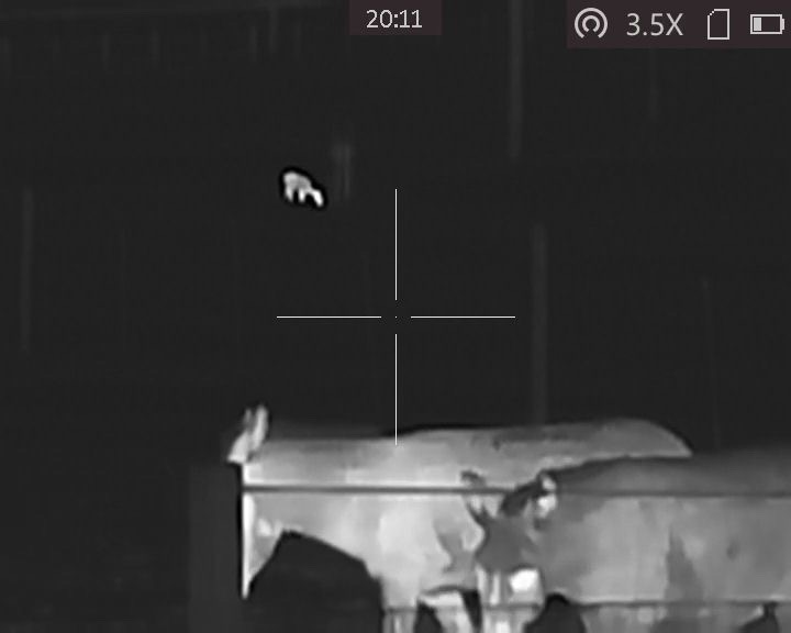

Maybe I’m crazy but I have had an AGM rattler TS25-256 for about three weeks now and I think it totally fits what you want. It’s the perfect entry level thermal. Plus if you decide to upgrade in the future this one is the perfect buddy scope or just a handheld scouting scope. I can detect deer at about 400 yards and would probably be comfortable on a coyote at about 150 yards.
I bought mine at Feral Texas Outdoors as they are local to me and their videos online are pretty great for seeing what each scope truly looks like at different ranges. Of course I bought mine earlier and now they are all on sale for Black Friday ($1,100) but what can you do.
Here’s a deer at 125 yards with the donkeys at 30 yards. Just gives a good reference of up close and further out. The video always looks better than the stills.
